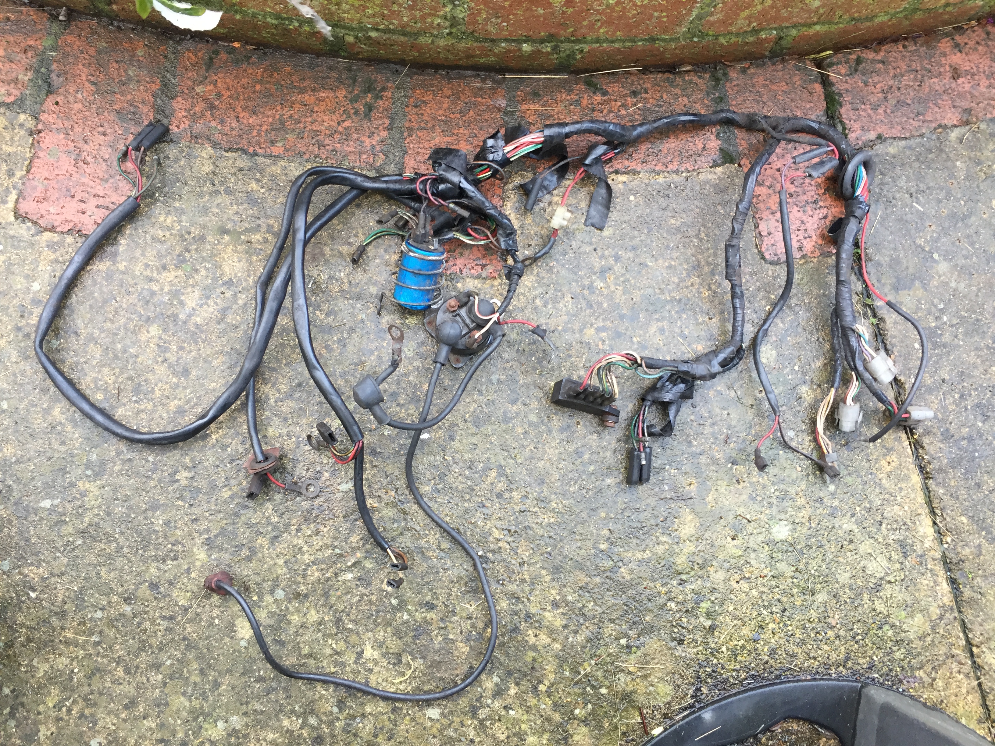

I posted a request for any one that could assist with the wiring connections on my MK3 Commando
the previous owner did not mark up the wires when they disconnected.
The bike came with a lot of parts some new and some aged and although my area is mechanical for 50 yrs, I always require assistance with electrics and this is no exception.

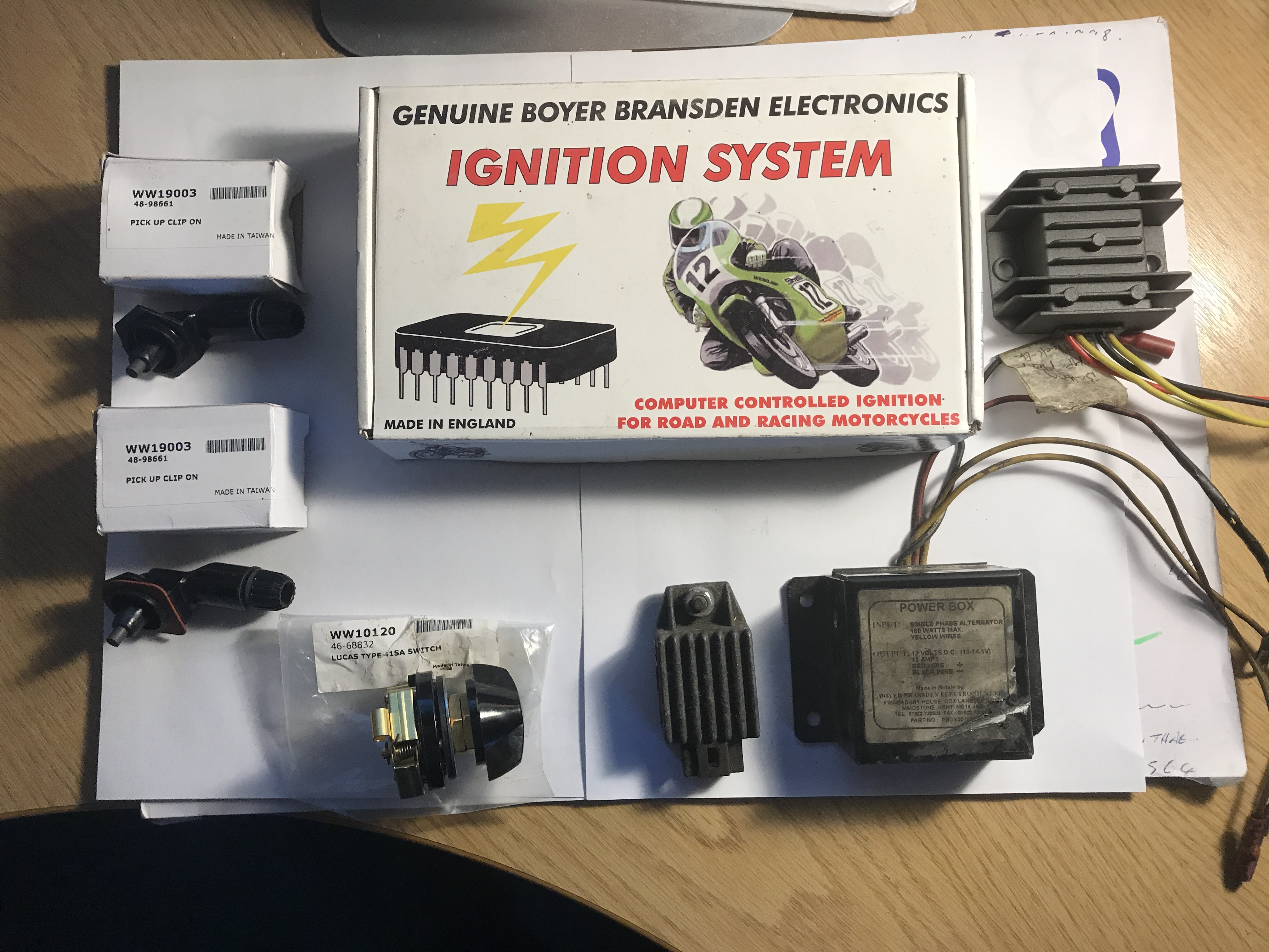

If anyone could throw some light on the what the parts are in the picture it would be of great help
Regards to all
Lester Powell

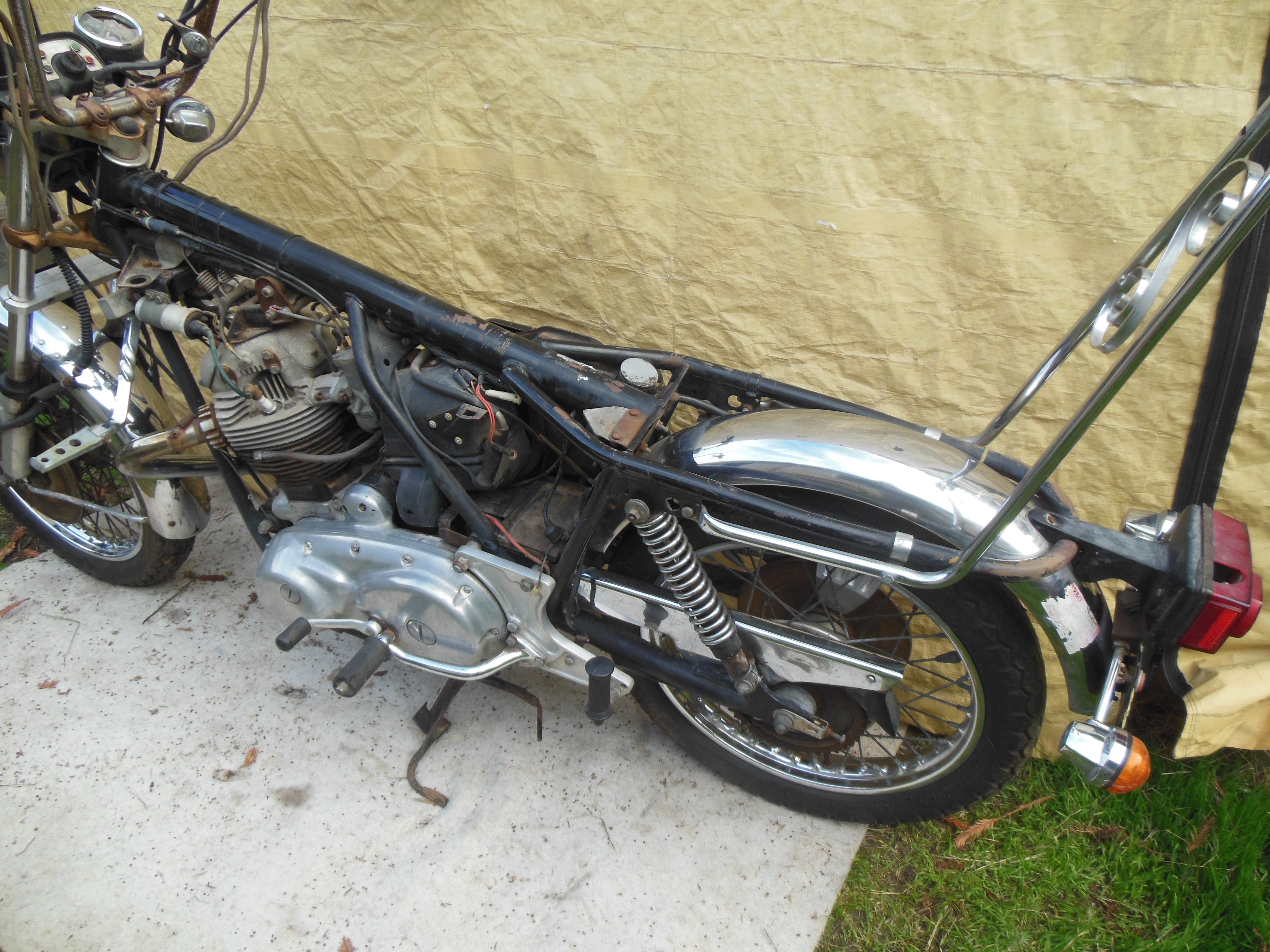

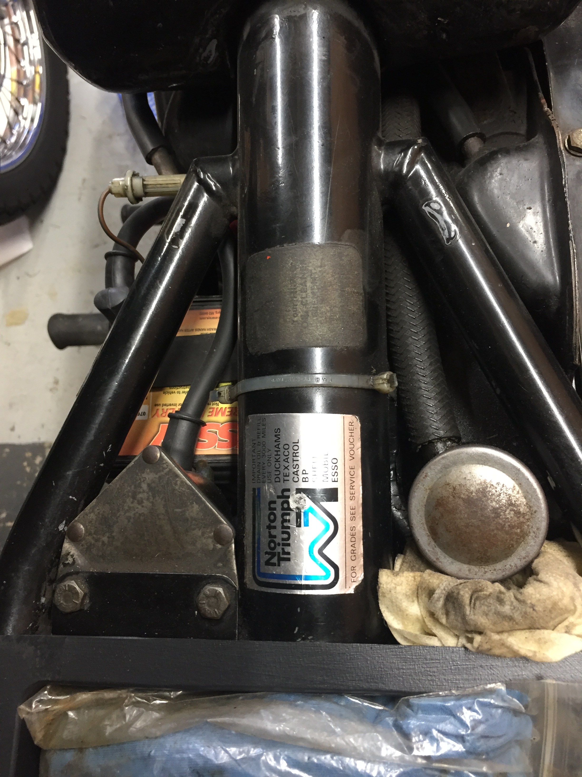

Do you have a wiring diagram for the bike? This will make things much clearer. With regard to your photos, I'm not sure what you're showing in pics 1&2 (although 1 has one of those horrible scotchlok things). The third picture shows an assortment of items - the black box with no fins looks like a Boyer Bransden ignition box which may suit your bike, the finned thing below it looks like a regulator (but possibly not for your bike), the smaller finned box could be anything; the 2 items at the top are magneto pickups which have nothing to do with your bike and the switch again looks as if it's from something else entirely.

The first  two pics show an area ( battery location box)  where someone said components were situated in this space and yes the scotch connector will be discarded.
I have an assortemnt of colour coded connectors , bullet, spades etc to use as I make progress.
As I said my forte is mechanical ,but if I had stripped the original all would have had tags and photos. As it is I have no clue where any components are located & fitted to then frame and where the wiring is routed.

I don't think pictures of someone else's wiring is going to help you much. Might help with cable routing but otherwise you'll just see a bunch of coloured wires wrapped in black sleeving disappear into a connector block. Follow the wiring diagram and colour codes and you'll be fine. There's one in the Haynes manual.
Don't think it's fair to criticise the PO; if he pulled the loom off without unwrapping it then you can just lay it back in place and match up the colours. If it's a mix of original, new and DIY then you won't want to put it back as it was anyway. You might have trouble mating old and new 'cos they originally used multi-way connectors but the looms available now use bullets. I recommend modern DEUTSCH multi-way connectors if you decide to replace connectors. Whatever you do, get rid of those nasty blue snap connectors visible in the first picture.

The Boyer Power Box is the non standard rectifier and voltage controller to turn the AC from the alternator to DC to keep the battery charged. It also has a big capacitor inside so you can start and run with no battery if you wish, and not blow the lights.
But alongside it are some other regulators. You have to ask why? Maybe the Boyer box stopped working...those regulators should do much the same job but don't have the capacitor.
Wiring for the Boyer should be on their web site. Likewise for the other regulators.

Very interesting...The items in the pictures right in the beginning are as said. Two off Mag pickups-Not Needed, one off Dynamo type lighting switch NN. One of small finned regulator for dynamo NN. Two type alternator regulators, the dirty old one is a Boyer Bransden with cap inside (known to fail) the newer one is an A reg type as sold by me and others.
Now the wiring loom as above-It is NOT a Lucas item as Lucas failed back in the 80s, It is a part made in the Far East in a GREEN box sold by a company called Wassell with NO technical backup. I have come across several of these looms (for other bikes) so far, both had issues, one appeared to be actually dangerous! This loom for a MKIII looks quite good but it has what looks like original Zener wiring, but if you use the alternator regulator rectifiers you won't need these wires!
One way to work through this problem is refer to the original diagram and get some of the standard wiring colours in your mind, and what that colour wire does. Sticking to std colours makes it a lot easier.

So you have a couple of 'upgrades' there:
  • Boyer Electronic Ignition which replaces the factory points, condensers and ballast resistor.
  • A regulator/rectifier to replace the standard two zeners and rectifier.
Your MK3 wiring therefore, will look like this:
1975 MK3 Commando + Podtronics + Boyer
Shout if you get stuck - there is plenty we can do to get you through this!

@mikael the diagram I included in my above post was based on the pile of parts in Lest's pictures.
I made an assumption based on these pictures, that he was going to use them!
  • A single phase podtronics, and a single phase Boyer Bransden Power Box (obviously only one required)
