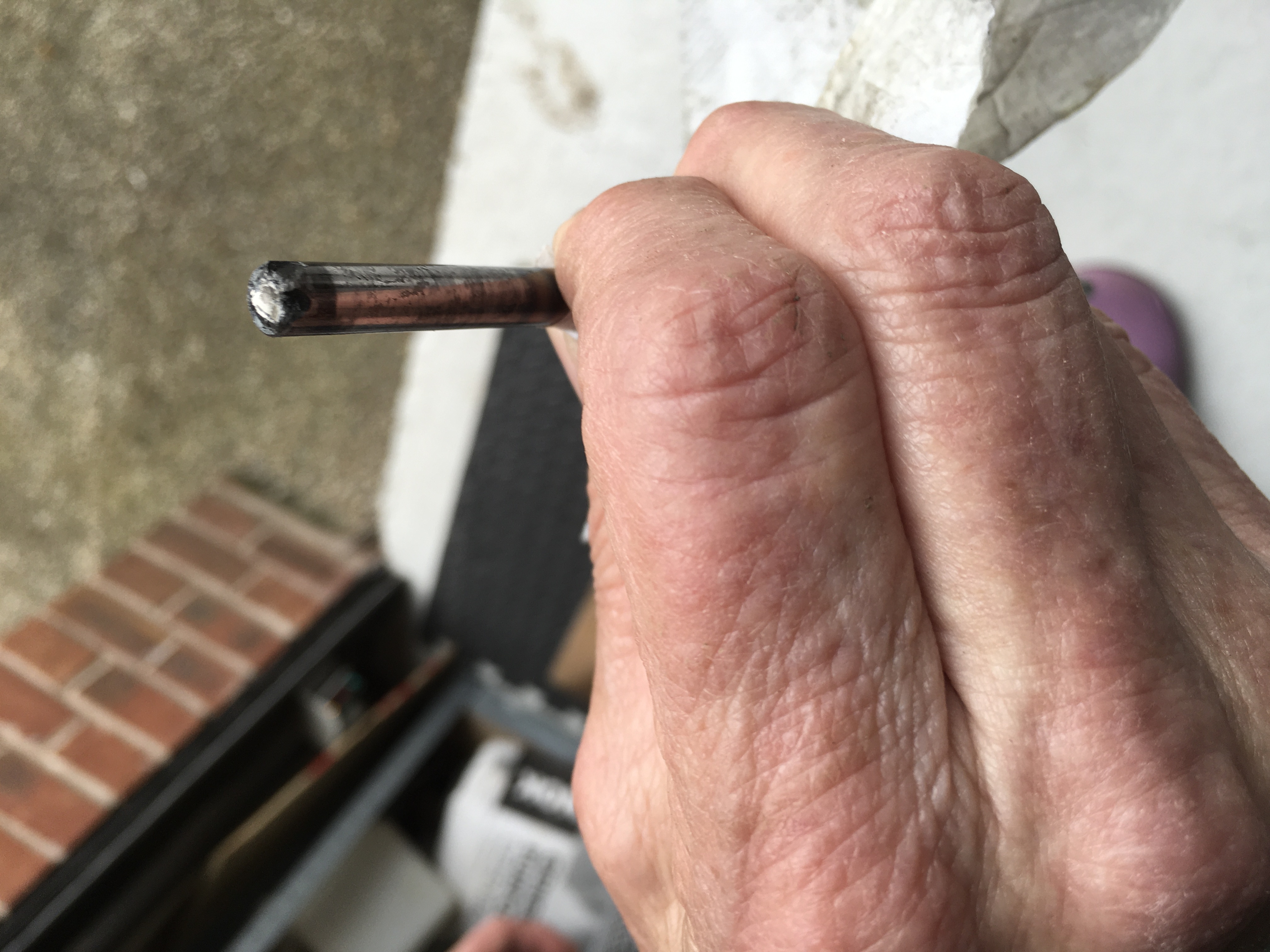

Pulled the clutch apart - all ok with a few minor burrs on the plates which have been appropriately rectified.
Pulled the operating rod out which easily rotated but the end was well burred over. Ordered new one plus ball from RGM.
Will update once parts delivered and fitted. Photo attached.
Anthony Bolton
.. as though it's been in constant contact and overheated. But if it rotates and came out easily enough I can't see that being your problem.
