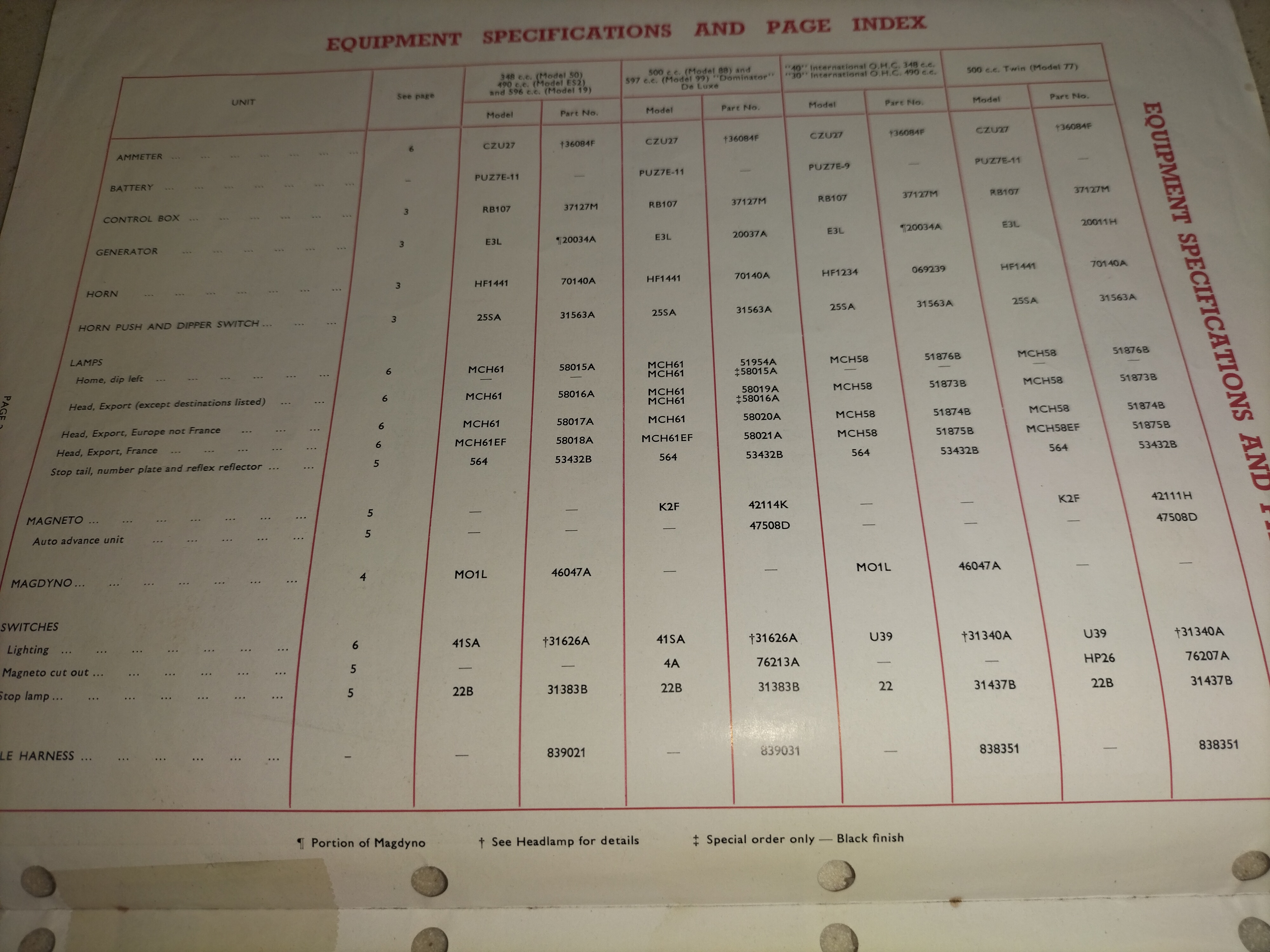

The correct part no for a 1957 Magdyno is 46047A as shown in the attached 1957 Lucas Equipment and Spare Parts List No CE 828B.
