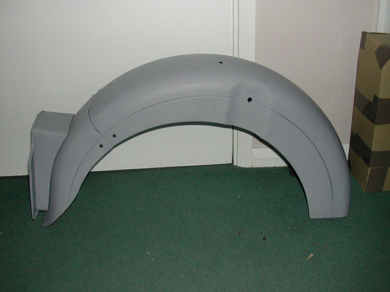

This is a one year part but is in fact a Model 7 itemBUT the part number is incorrectly shown in theparts bookas H12/534 (should be K12/534). This mudguard is extremely close to the earlier 53/54 item in fact the only difference is the addition of extra holes for the rear seat mounting (unique seat to the 55's as well) and the holes for the rear numberplate (another one year part believe it or not). There is a slight difference however in the rear section's shapewhich unless I told you you would not have known.
I have attached a picture of a 53/54 type mudguard modified to 1955 hole placings. The rear numberplate is partly original; the face is but the boxed in area is new as what was there was scrap.

Jim, I am very envious, your mudguard looks perfect for my bike, and your info is very much appreciated. All I need to know now is here I can get one!
