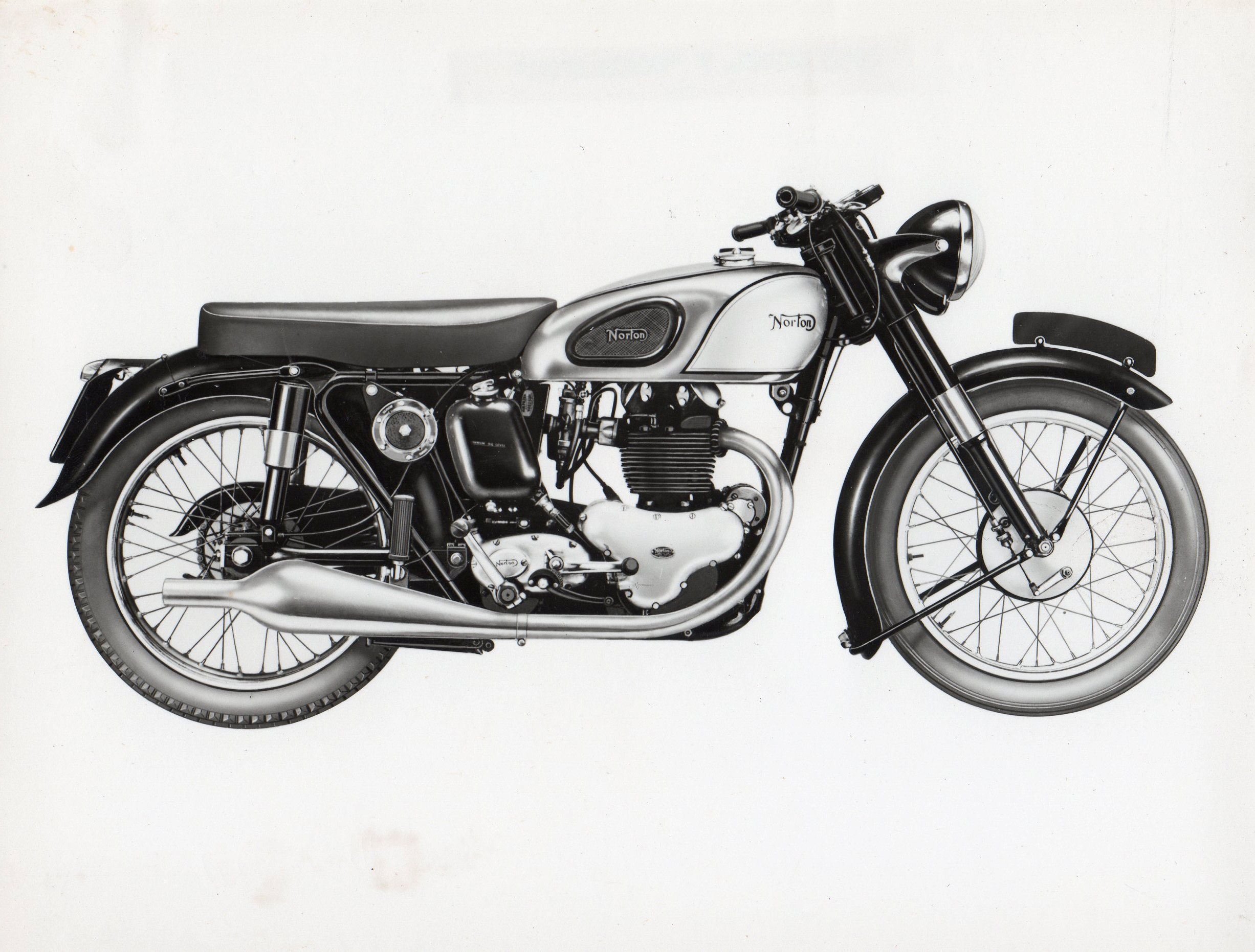

Hi all, Canada calling. My Model 7 is in the final stages and I am unsure of how the horn was mounted, no tabs etc. Any advice will be appreciated. Thanks Tony
Factory Brochure Pic
1953 model 7 horn mount
Hi Phillip, many thanks for the factory brochure picture, Exactly what i was looking for! I can now carry on with the restoration. greatly appreciated.
Horn mounting bracket
If you have the Lucas Altette horn the Club Spares Scheme sells the mounting brackets 700168
There is a metal P clamp…
There is a metal P clamp that goes around the frame tube and attaches the horn.
Attachment shows RHS of 1953 Model 7 as shown in Factory Sales brochure. You can see the horn mounted just below the seat on a triangular-shaped bracket.
1953 was the year that the frame changed from Plunger to Swinging Arm so the second pic shows the Plunger frame version. This time the horn is mounted on the LHS but also on a triangular-shaped bracket just under the sadle seat.
