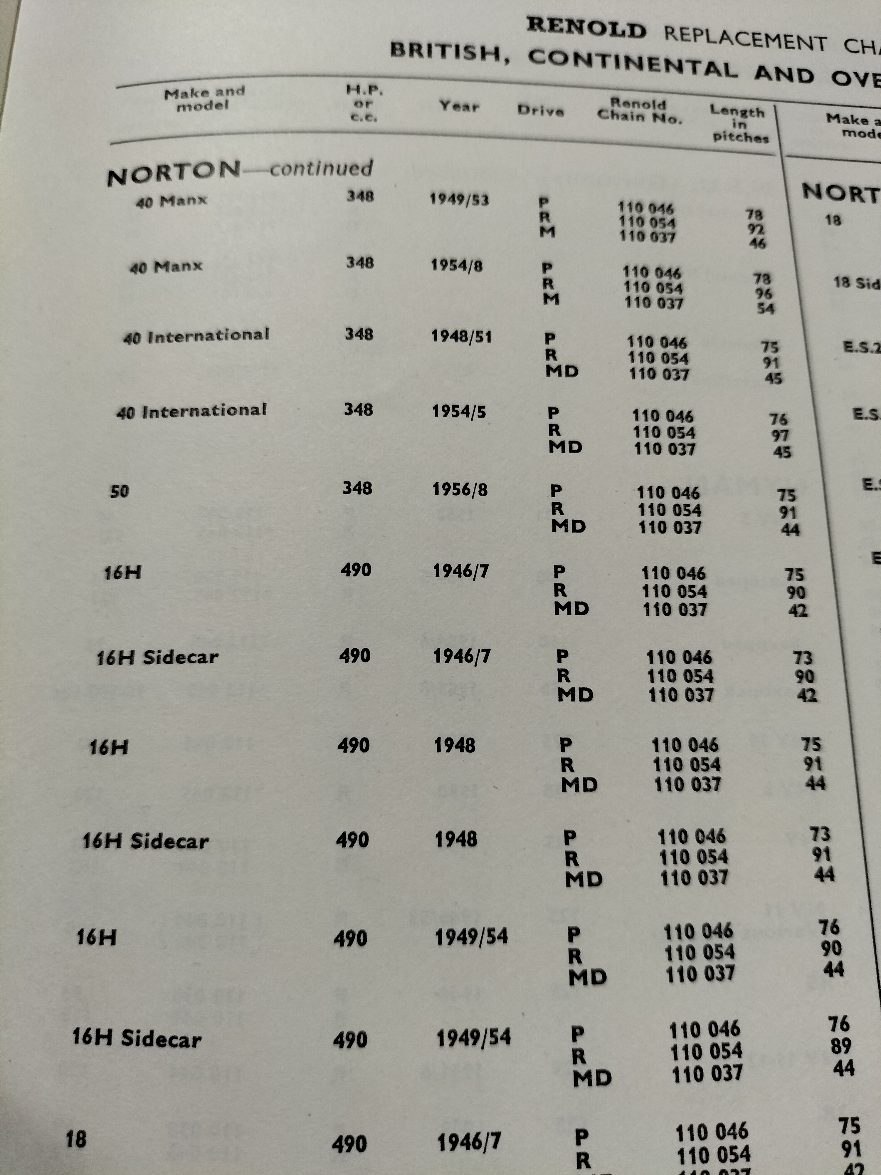

Hi thanks for all your help,the sprockets have 15 teeth could anyone point me in the right direction to get a timing chain please or would this work?
https://racingnorton.co.uk/1930s-WD-16H-Magneto-Chain-Soft-Link-xx6-Link
many thanks
