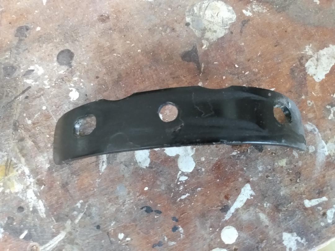

What oil do I use for the gear box? Engine oil specs? I have included a small metal piece that I believe fits under the rear mudguard extension. Am I correct?
I assume we are talking about a WD model or there abouts....1937 on.
The rear mudguard attachment is to aid wheel rermoval etc. Correct.
