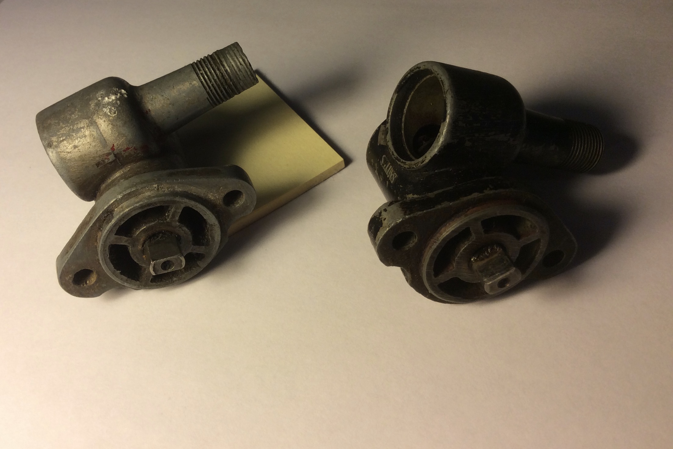

I have a two-into-one issue with a couple of tachometer gearboxes, both of which are faulty in different ways but with which I hope to perform the two-into-one trick in order to obtain a functioning item.  As the attached photo shows, one unit is missing an end cap and one of its pinions, whilst the other one is complete but the thread for the drive cable spigot has been stripped, so I would like to swap over the two cases.  The job should be easy apart from the task of popping out the boxes' circular end-caps, which are an interference fit in their casings, which are cast from Mazak or a similar alloy with a high zinc content.
I would welcome any tips from anyone who has already tackled this sort of chore successfully.

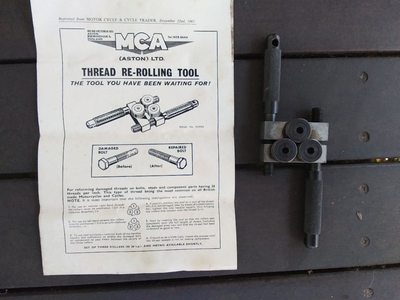

.......reforms 26tpi threads. Don't know where you would find one these days. thread repair
