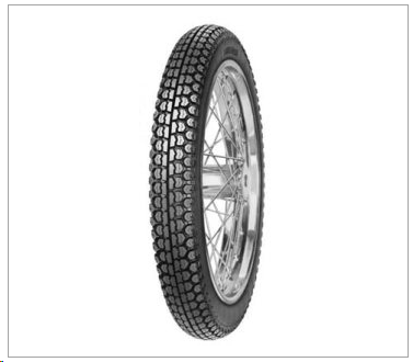

There is not much space to the left of the tyre (3.25 x 18) between it and the mudguard, so stick with WM2, and use an old fashioned 'square looking' tyre. A modern one may rub on the mudguard.
Czech company Mitas make exactly the right tyre:
https://www.mytyres.co.uk/cgi-bin/rshop.pl?gclid=CjwKCAjwssD0BRBIEiwA-JP5rADJWLXxmCdPu5BMjVtlunbrugR140jCtsQkv-KjWdU0A7q91h7GURoCe2wQAvD_BwE&dsco=110&typ=D-M61078&partner=1&m_s=1&partner=1&Country=UK&ID=sea_rd_uk_Froogle_Shopping&ef_id=CjwKCAjwssD0BRBIEiwA-JP5rADJWLXxmCdPu5BMjVtlunbrugR140jCtsQkv-KjWdU0A7q91h7GURoCe2wQAvD_BwE:G:s&s_kwcid=AL!432!3!400317375299!!!u!297461690331!
Mitas 3.23 x 18
