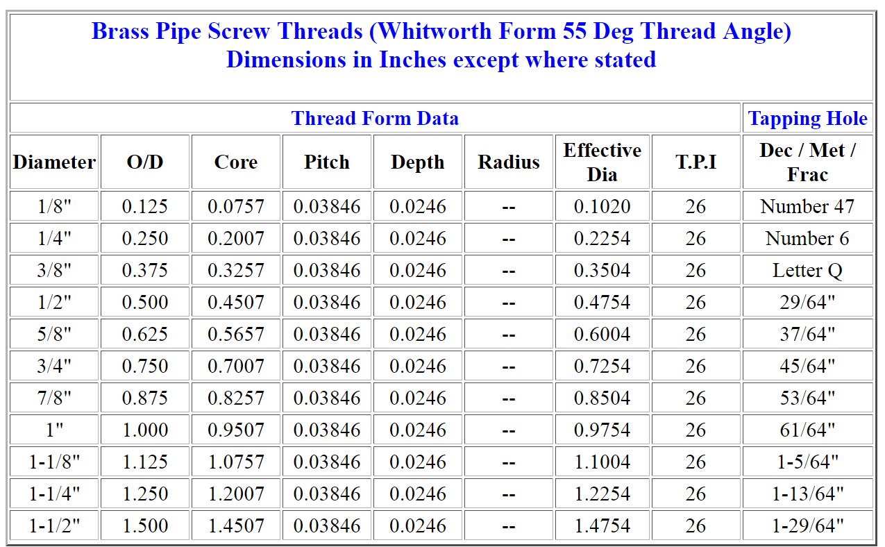

I have a 1941 Norton 16h with the speedo drive on the n/s front hub,
can anyone tell me what size the thread is where the drive screws into the hub, it’s a fine thread and is a touch over 18mm
any help here greatly appreciated
18mm = ~45/64 or .703"
19mm= .748"
11/16" = .6875"
12/16" =3/4"  or .750"
I would doubt that there was anything made in metric dimensions on a 16H
I am going to guess that it is 3/4"x 26
Can anyone confirm this?
I believe that the thread is 0.718"  x 26tpi - (23/32" )
There are lots of odd sizes on these instruments and drives, probably due to their French (pre-ISO metric) origins.
Cant measure it accurately without dismantling. I think Richard is probably right. Highly unlikely to be M18x1 because it's a bit more than 18mm.

   The thread pitch of metric 1mm is very close to 26 cei with just 0.016" per inch difference in length, which might be easily confused. Then there are a variety of different imperial threads on the rest of the bike, so check thoroughly, then check again !
