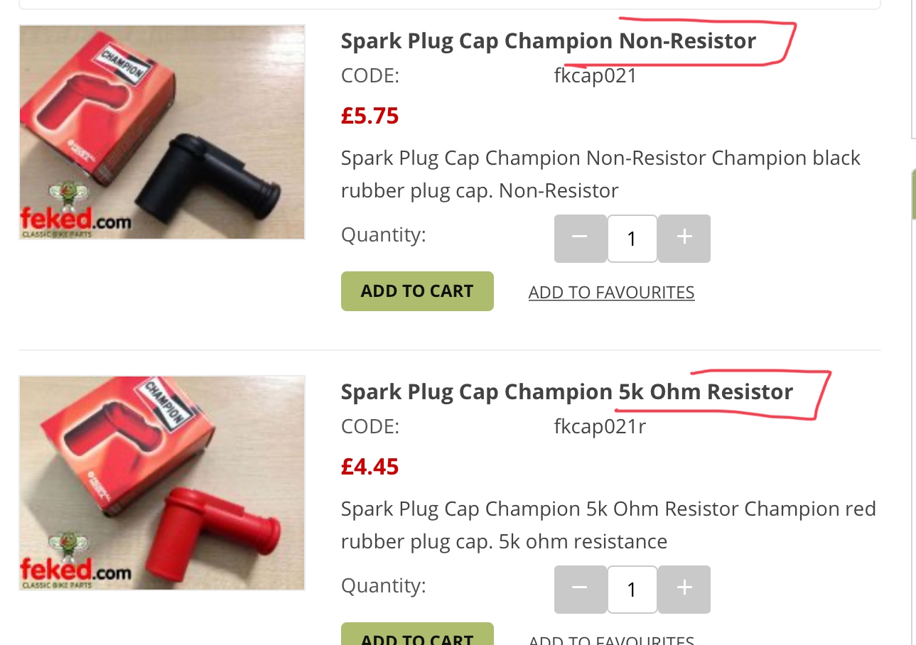

Hello guys !
I would like to ask, which cap is better for my ES2 .?
with resistor or without ? what is the difference an why ?? thank you very much for answer
Magneto or coil ignition?
If you have a contact…
If you have a contact breaker setup as it was from the factory, no resistor is needed. On the electronic ignition systems provided by Boyer, Pazon and Tri Spark, all three recommend resistor caps.
Yes, I have classic contact…
Yes, I have classic contact breaker...
Thank you for explanation
On magneto ignition, a lot of people think resistors should be avoided. They were never intended to be there. As I understand it, the resistor makes the available energy spread over a longer time and thus gives a weaker spark with longer duration. This gives less radio frequency interference. The RFI can affect electronics to malfunction. On electronic coil ignitions it might be preferable to use resistors. I have not the faintest if it's needed.
There is three different ways to have the resistor, either resistor spark cables, resistor caps or resistor spark plugs.
