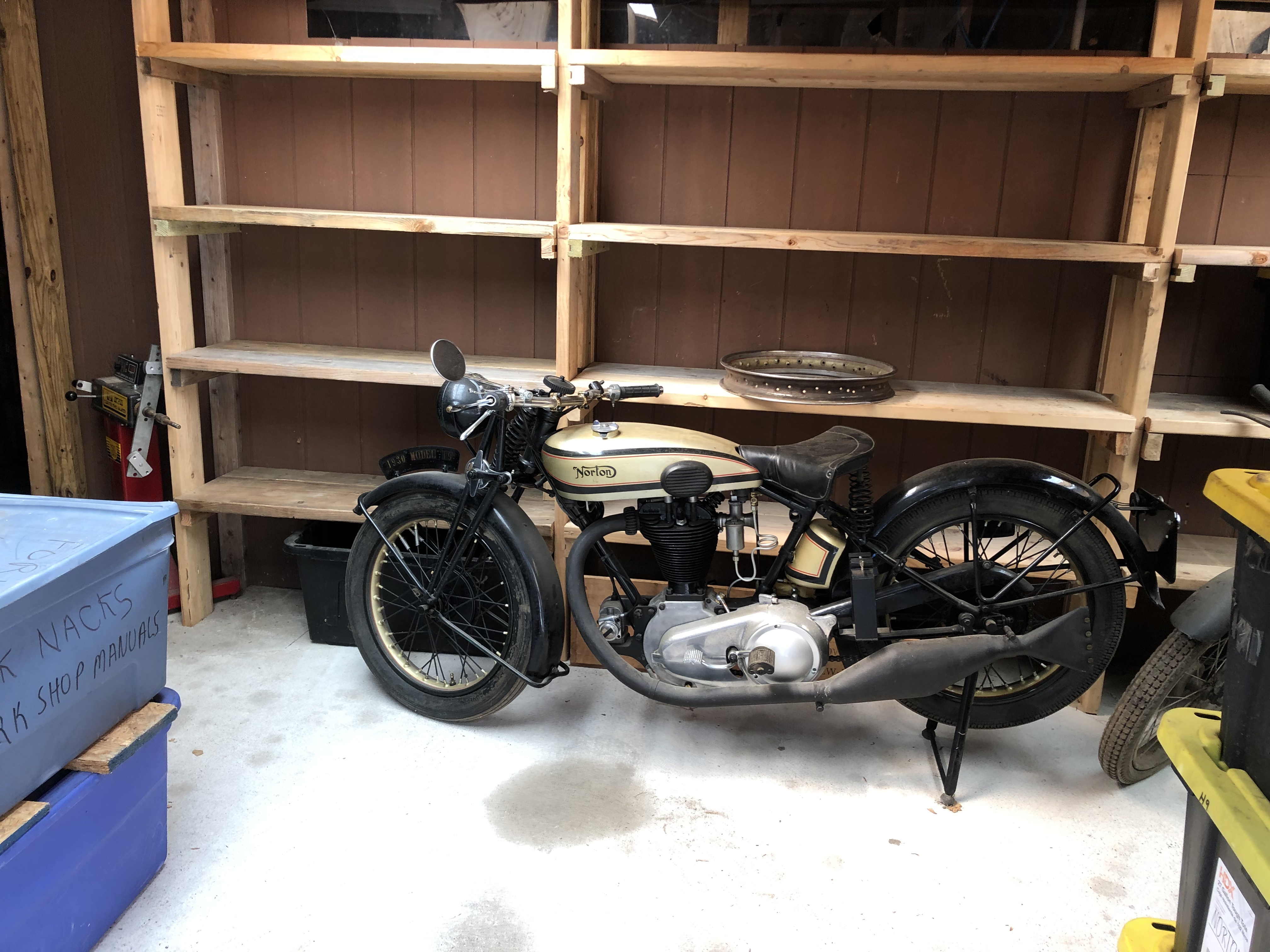

Greetings, new member here. I am a long time Commando owner and recently bought a 1930 Model 19. The bike is an older restoration that has not been started in 5 years. Or so I was told.
After some huffing and puffing by someone who is much more familiar with bikes of this vintage the engine fired up.
Now for the Newbie questions.
What is the proper plug / plug gap?
What lubrication is used in the Sturmey Archer gearbox?
Which way do I move the spark timing lever to advance/retard the timing?
Why is this bike so dang hard to kick over?
I can find all sorts of information on models years 1933 and later, but very little on the 1930 Model.
The starting procedure we use is
Bring the piston TDC
Squeeze the compression release lever
Move the piston just past TDC
Release compression lever and give it a good kick.
Some magnetos have slack…
That is an incredibly…
That is an incredibly beautiful machine. Try to resist the urge to "improve it", appart from those modern bar grips/throttle, Hunters in the uk may have something suitable. Spark plug gap? smaller than coil ignition a guess,20 thou .OIl in the box ?,a guess,50 weight ,and if it leaks out much too fast ,half oil half fluid grease. Hard to kick over?,this is a mans bike,man up!. Find a position on the mag lever where it does not try to break your leg,mark it with a couple of dots of nail varnish to align for starting,then you will have confidence to kick properly. The Bike does have a few fittings /finishes that are missing or incorrect , research needed.

That is a beautiful machine…
That is a beautiful machine. I love the tank colour, and inverted levers are the right period feature. The saddle cover is excellent...they don't make 'Rexine' like that any more (although I'd be delighted if someone corrected me on that).

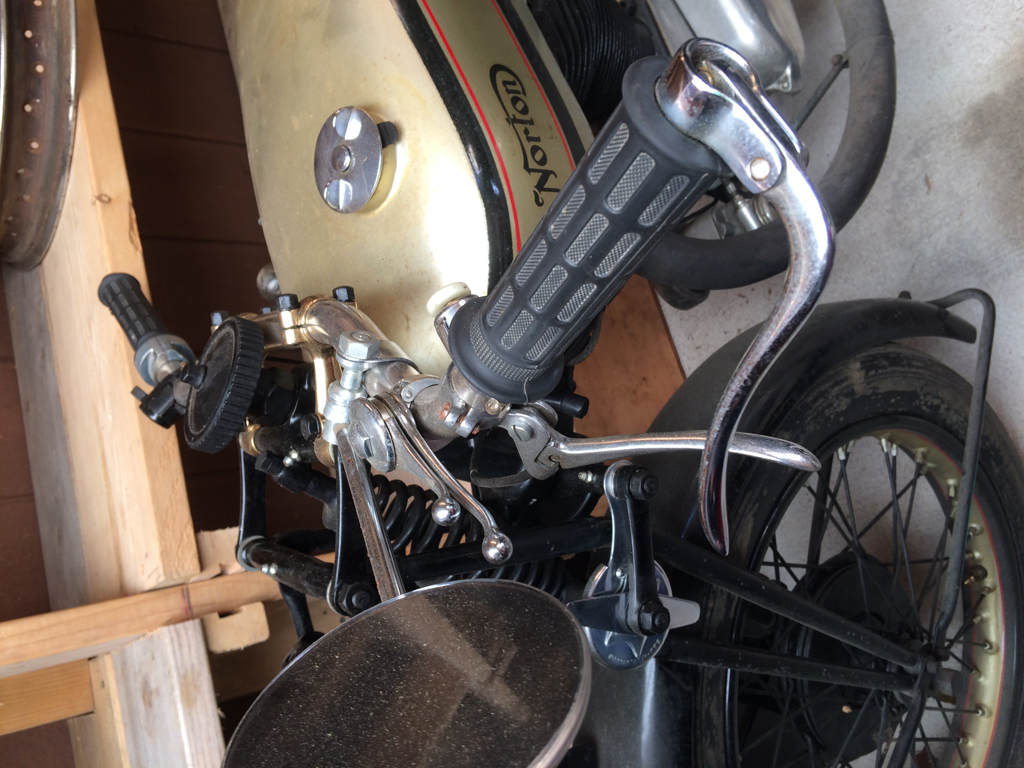

Magneto.
Hi Richard,
I zoomed in on your picture and it looks like the original mag has been replaced by a later BTH KC1 from late '30s or '40s. This should be anti-clockwise rotation and looking at the cable entry for the advance and retard, it looks like a slack wire advance which is the desirable type to have. As Ian suggests pull the lever back 1/3rd, push forward the air lever as this works in the opposite direction to the ignition cable. When the engine is warm the ignition lever should be closed (slack) and the air lever fully open (tight).
P.S. Sorry, I posted this at the same time as you, so you probably know the kick-start stuff, but the mag identification might help.
