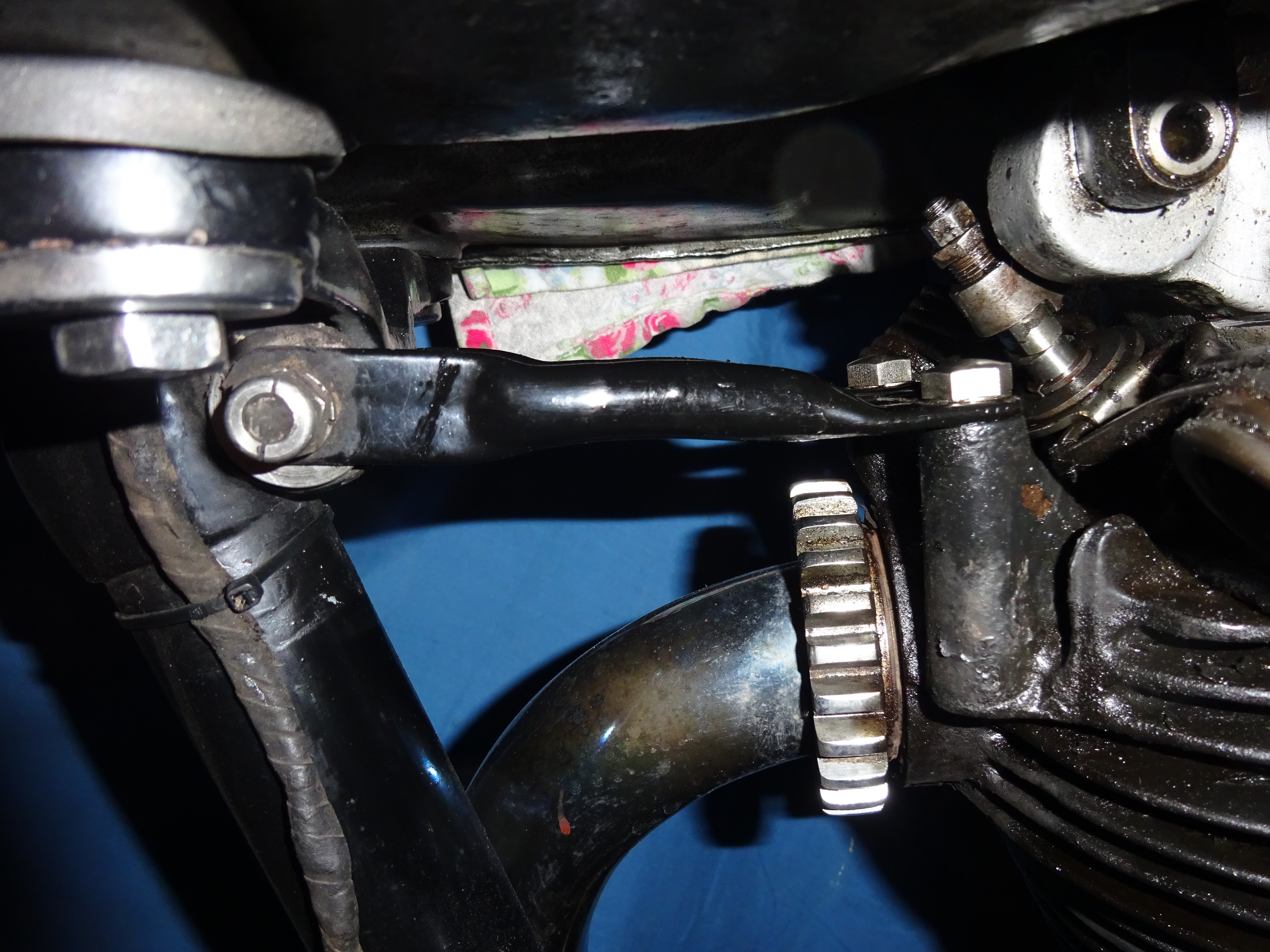

The head steady parts are still shown in the 1936 Norton parts book. My 1936 Inter has these head steadies. The steadies attach to the frame to the sidecar lug mounting point. The parts book describes the parts as:
Part 3463 Frame lug aluminium plug,
Part 3464 Frame lug aluminium plug nut and bolt.
Part 3465 Frame cylinder head stay, left or right-hand.
My head steadies are original but I had to make the aluminium plug and use a nut and bolt from my stock.
Picture attached.
Regards, Nick
Thanks very much, Nick. Fine picture! Now I know what those two studs are for at the front of the head. Now to decide whether to fit the stays. My Dommie is unridable without, but this feel pretty smooth at the revs I've reached so far.If Norton decided to leave them off...
