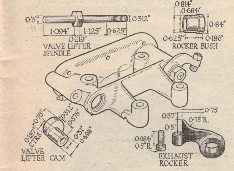

Ian. I had the same problem with my 31 Model 20. The previous owner removed it I think during the 40's
I had a machine shop make up a new one using the diagram below.
I then bought a exhaust lifter that was too long and had them cut & Weld to the correct length.
As for a spring I just happened to have  one NOT the coil type  just an ordinary spring
Hope this helps
Hi Ian,
What a fantastic old drawing. It gives all the details I need to get the parts made. Thanks ever so much for taking the trouble to share the information, really grateful.
