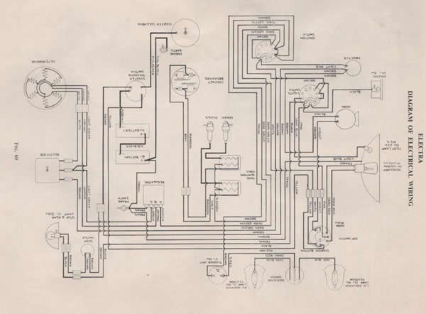

 I have a new wiring harness and a fairly new 12V 6A battery on my Electra which reads near 13V with no load and drops to just over 9V when the starer is engaged.  Should it fall this far?
  Also my ground wire gets smoking hot when the starter is engaged.  What might be an obvious reason for this?
