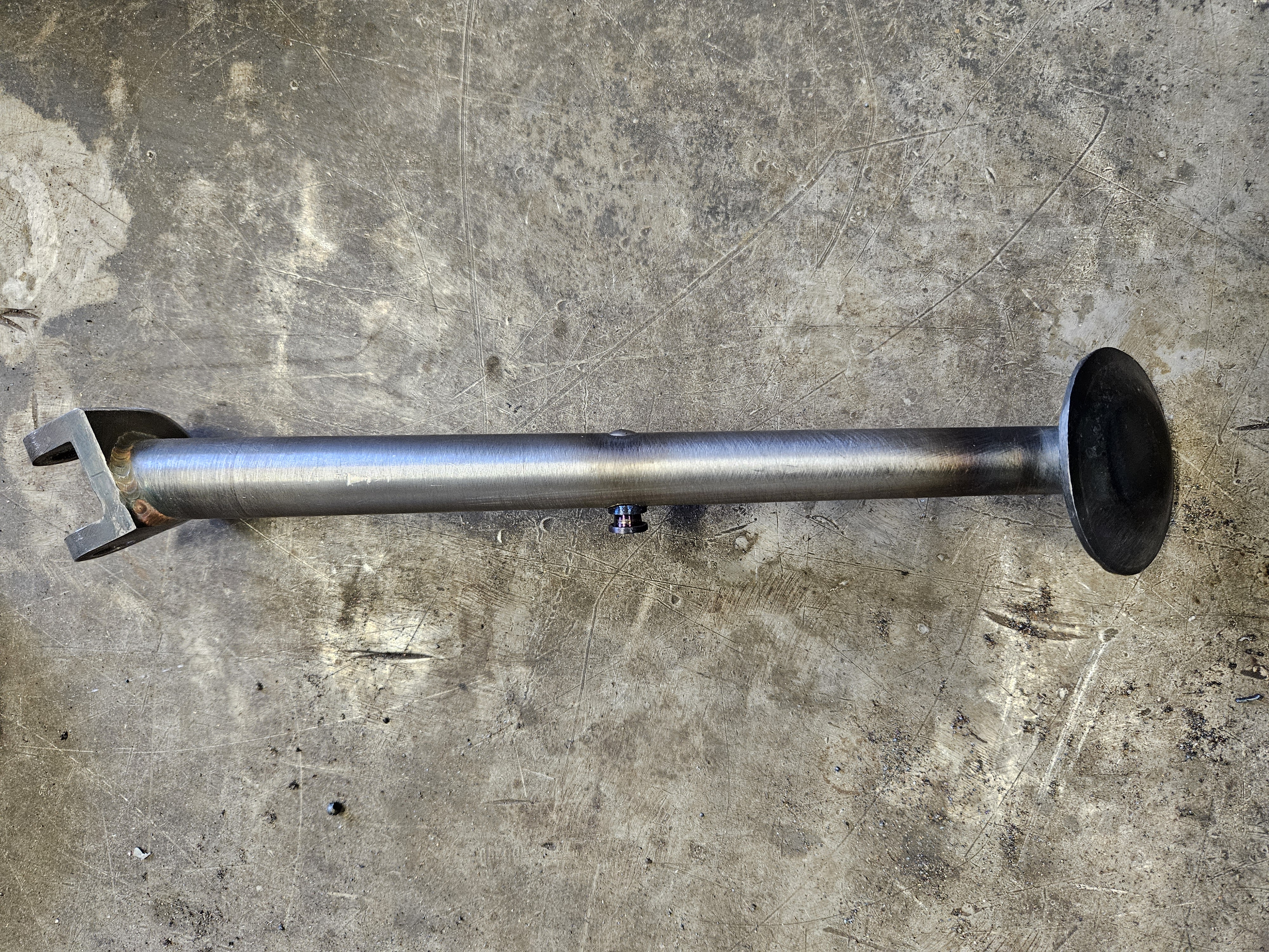

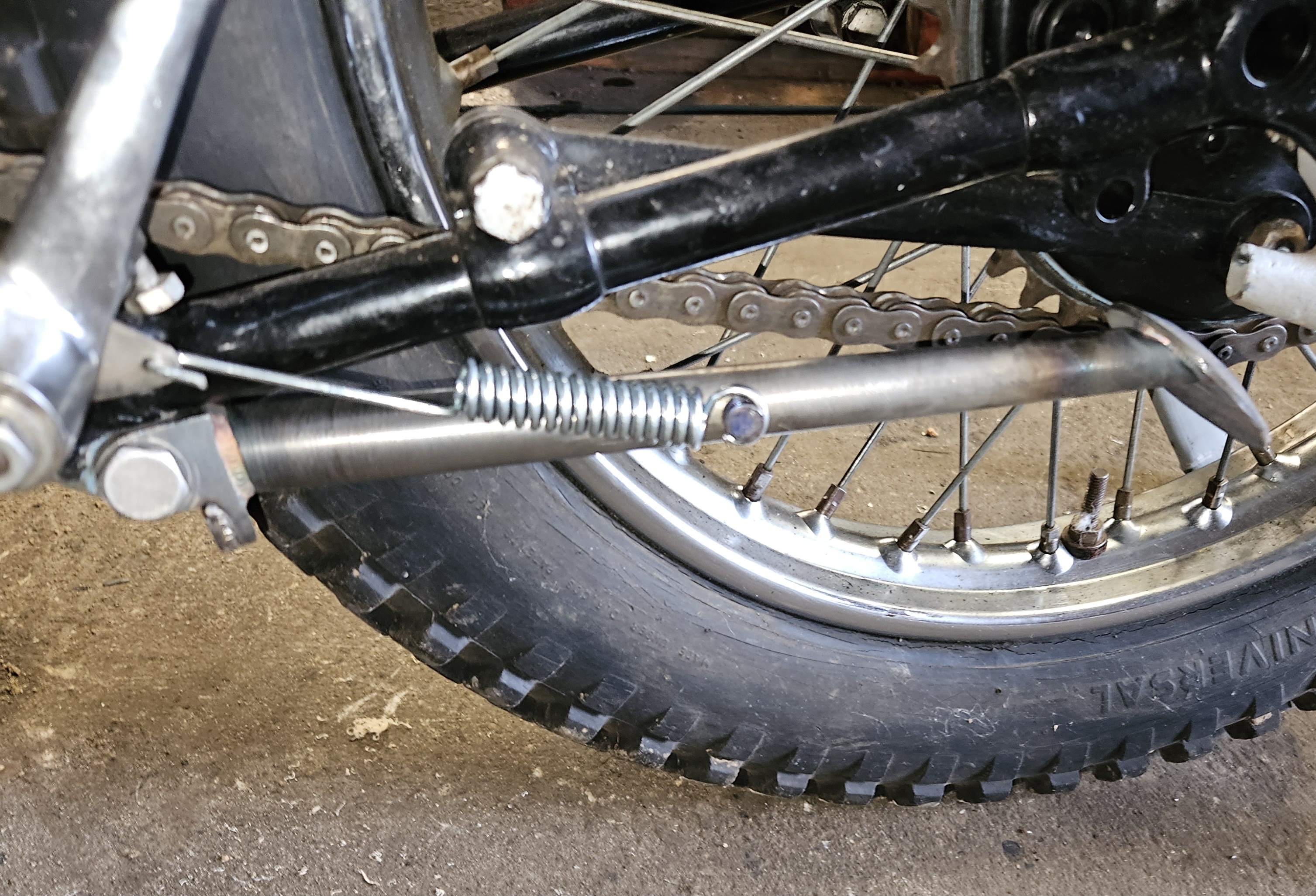

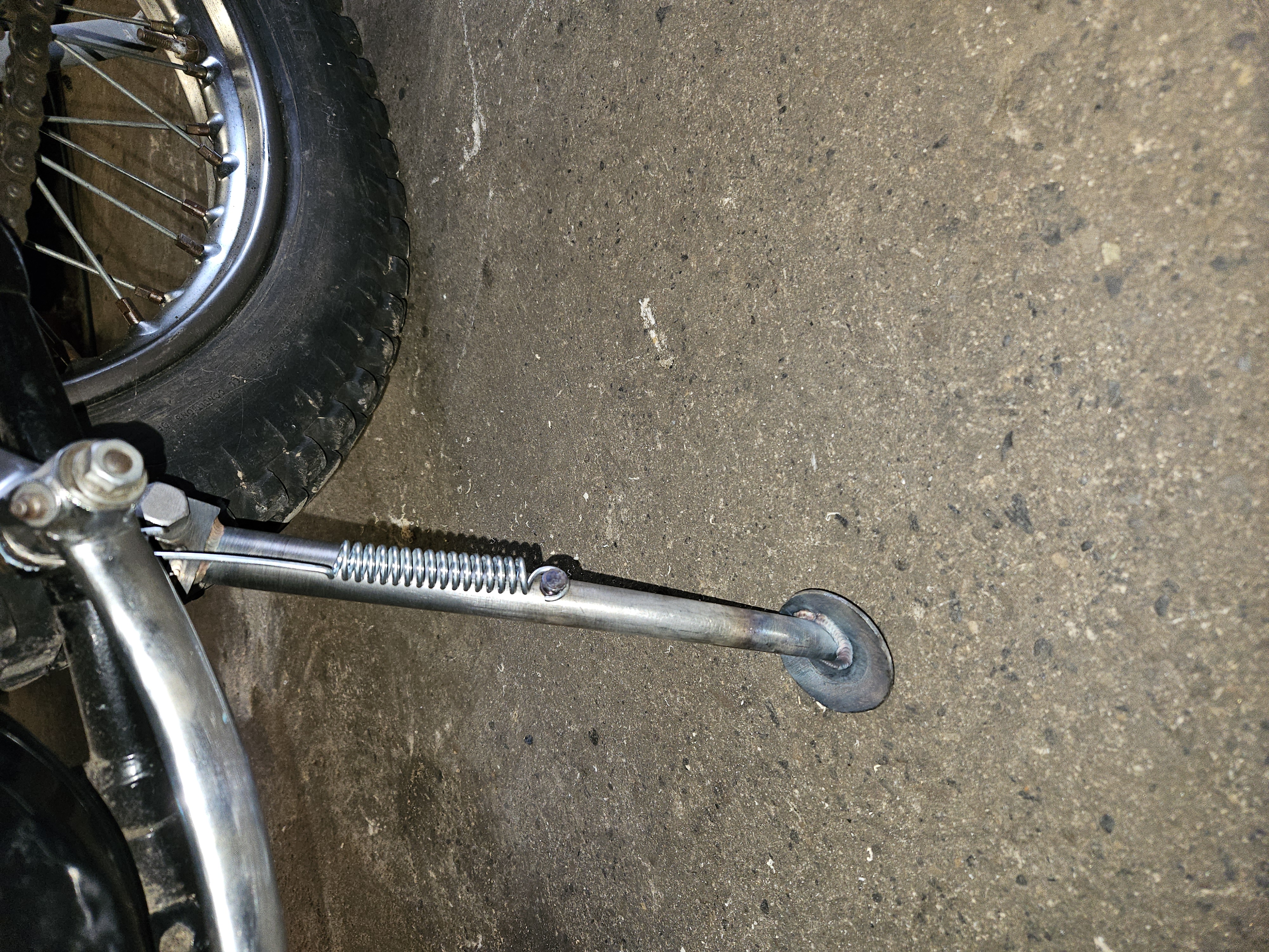

I made my own side stand, not too tricky.

More pics of side standSide stand
