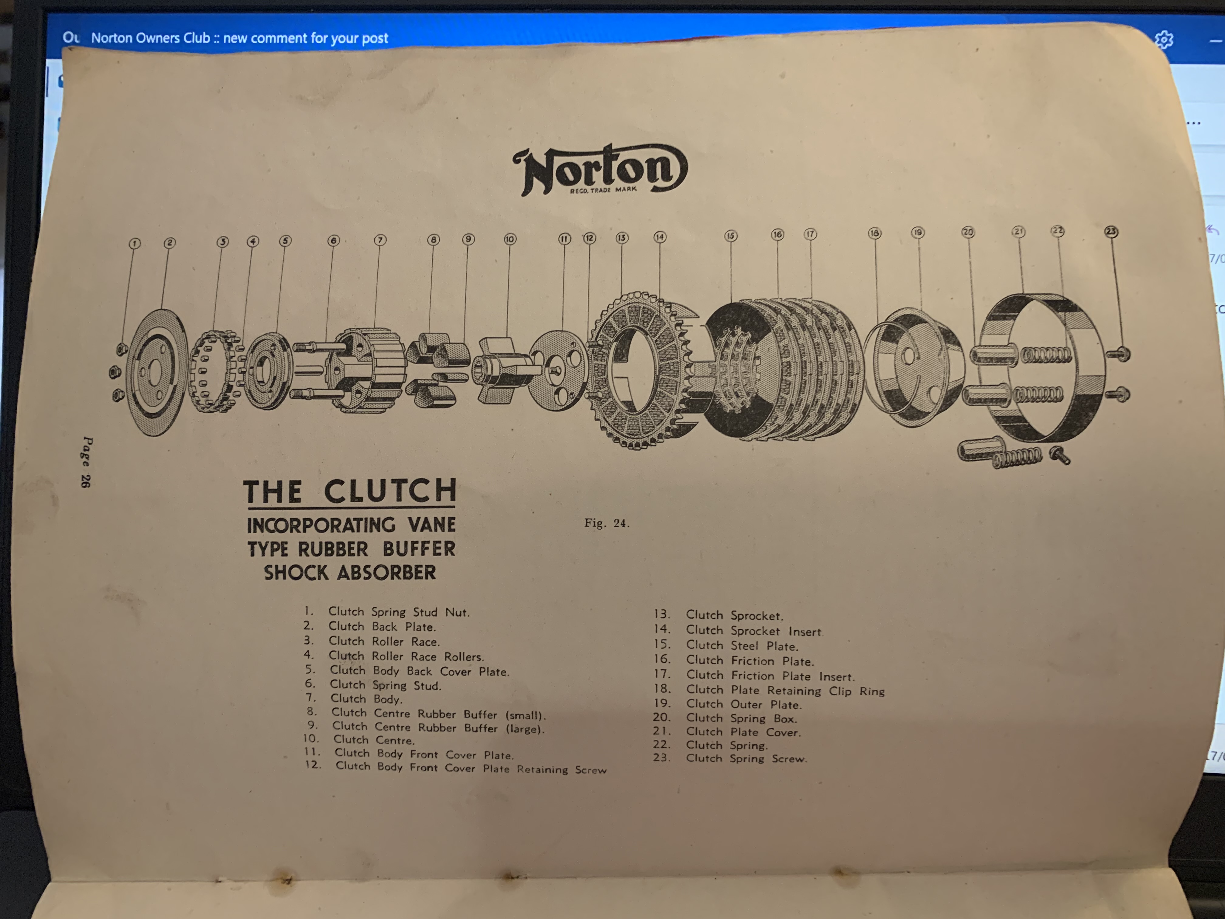

Where can I get the clutch removal tool for the 16 h. I bought one from eBay but it is the wrong thread. I'm struggling to get the clutch to release
If clutch is very reluctant to part from shaft ,suspect failing spider register /shoulder which will get much worse with use and make gearchanging poor once clutch migrates towards the gearbox.
