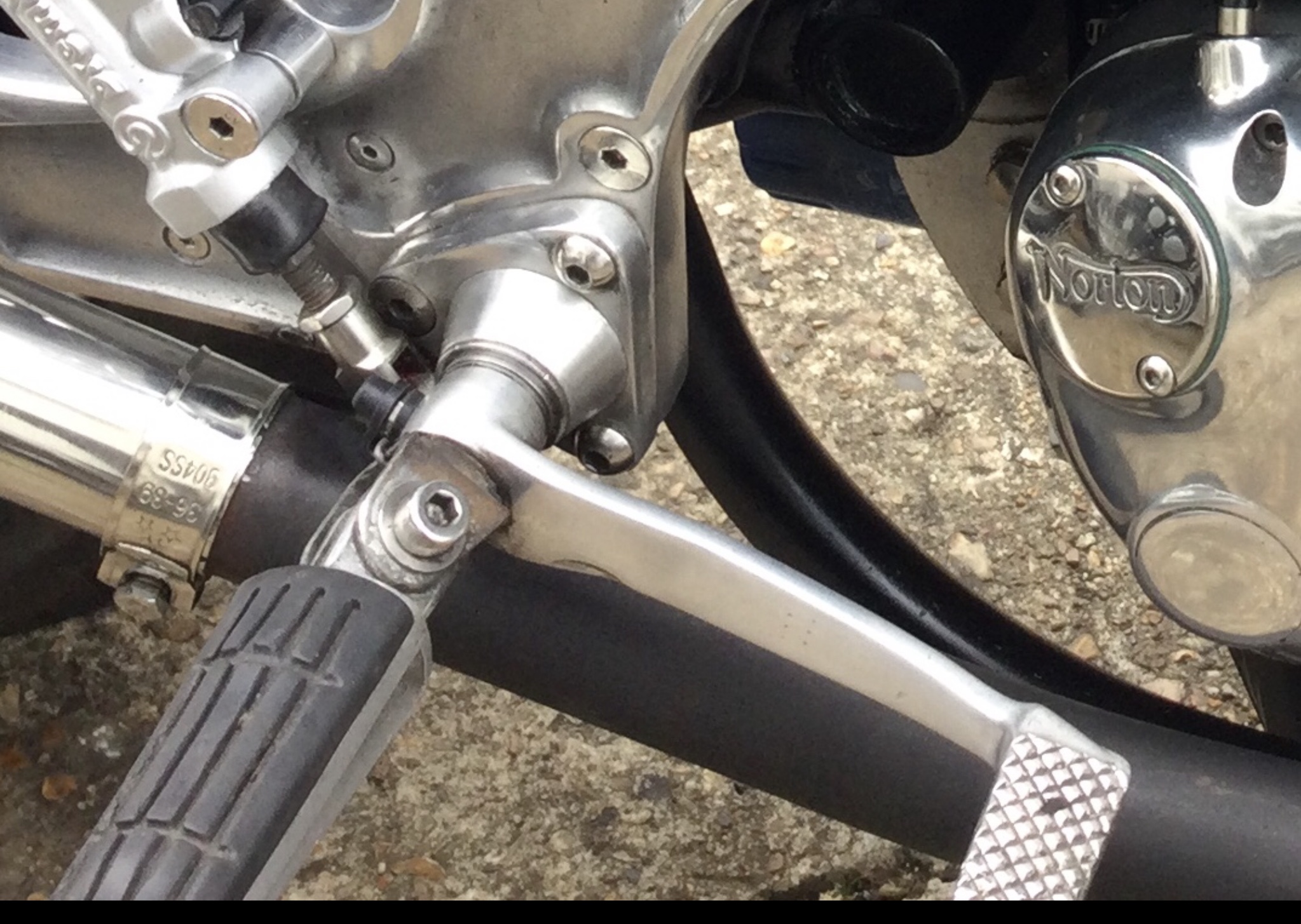

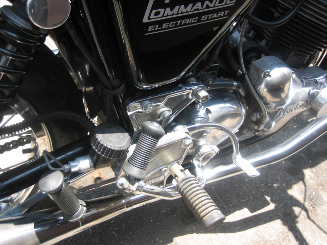

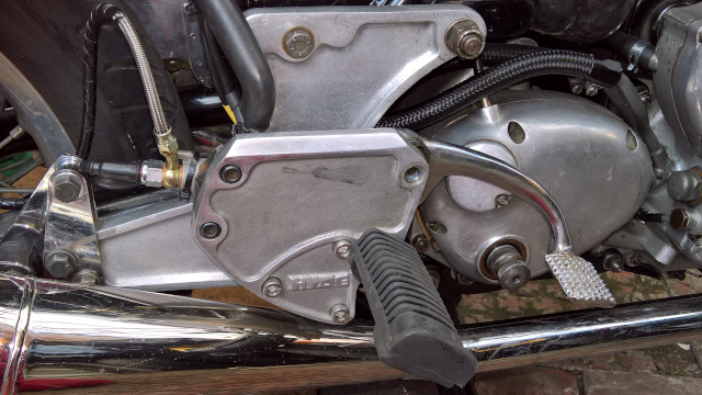

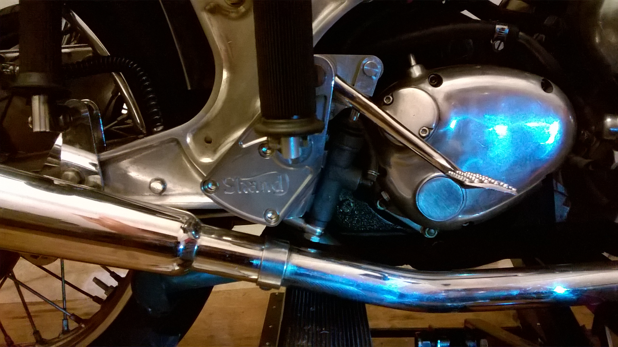

Photos are of the rearsets fitted to my Mk3
Rearsets

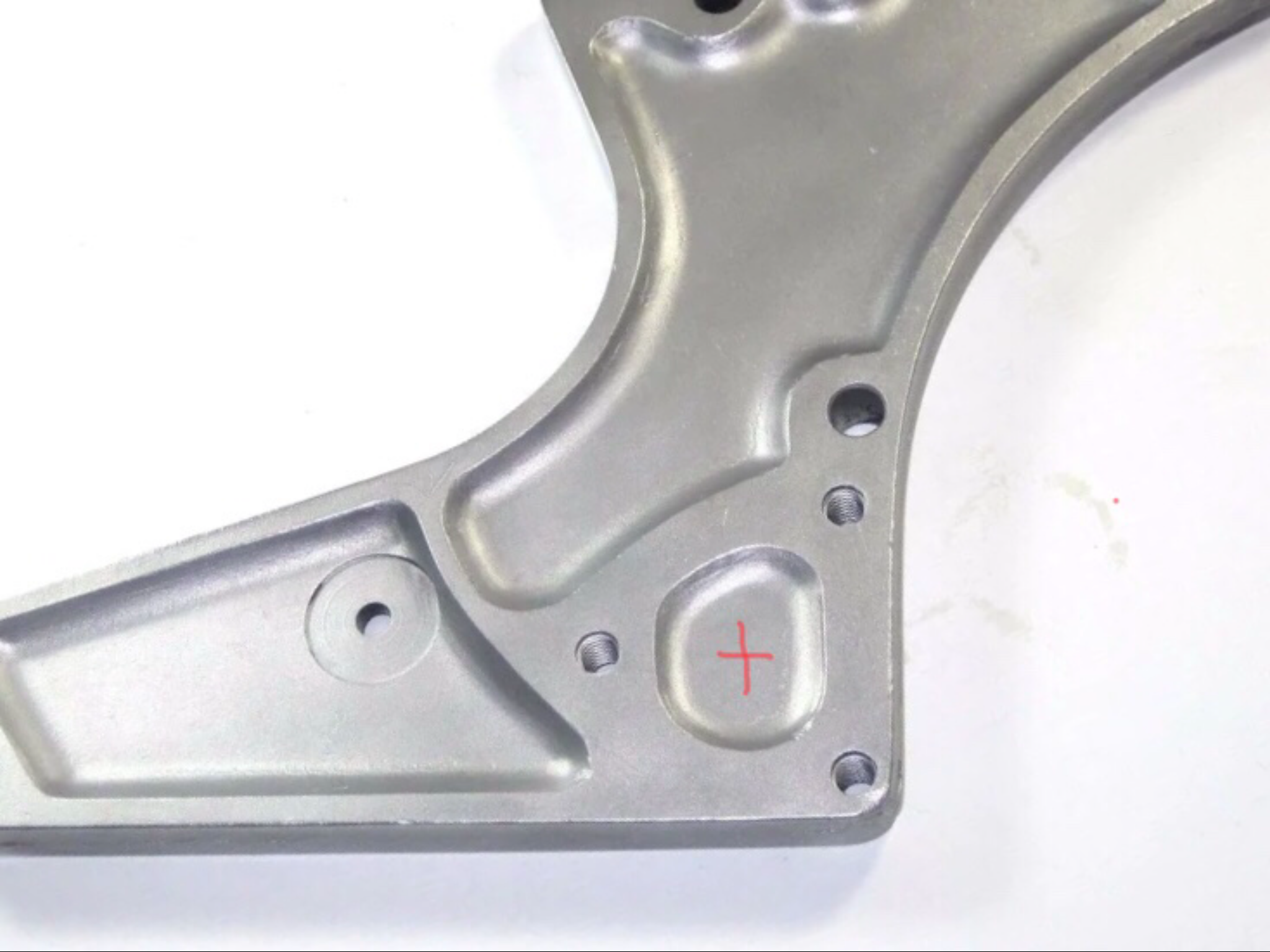

Rear sets help a lot especially on the Interstate as mentioned, mine are roughly at the centre of the depression between the three Z plate holes.

Looks like you gone with the same position as Norman Hyde - roughly the same level as the upper bolt and as far forward as the primary drive allows. Personally, I find the peg is a little high and dropping it down about halfway between the bolts would be better. As would narrowing the stance (how far apart your feet are) - I have a plan...

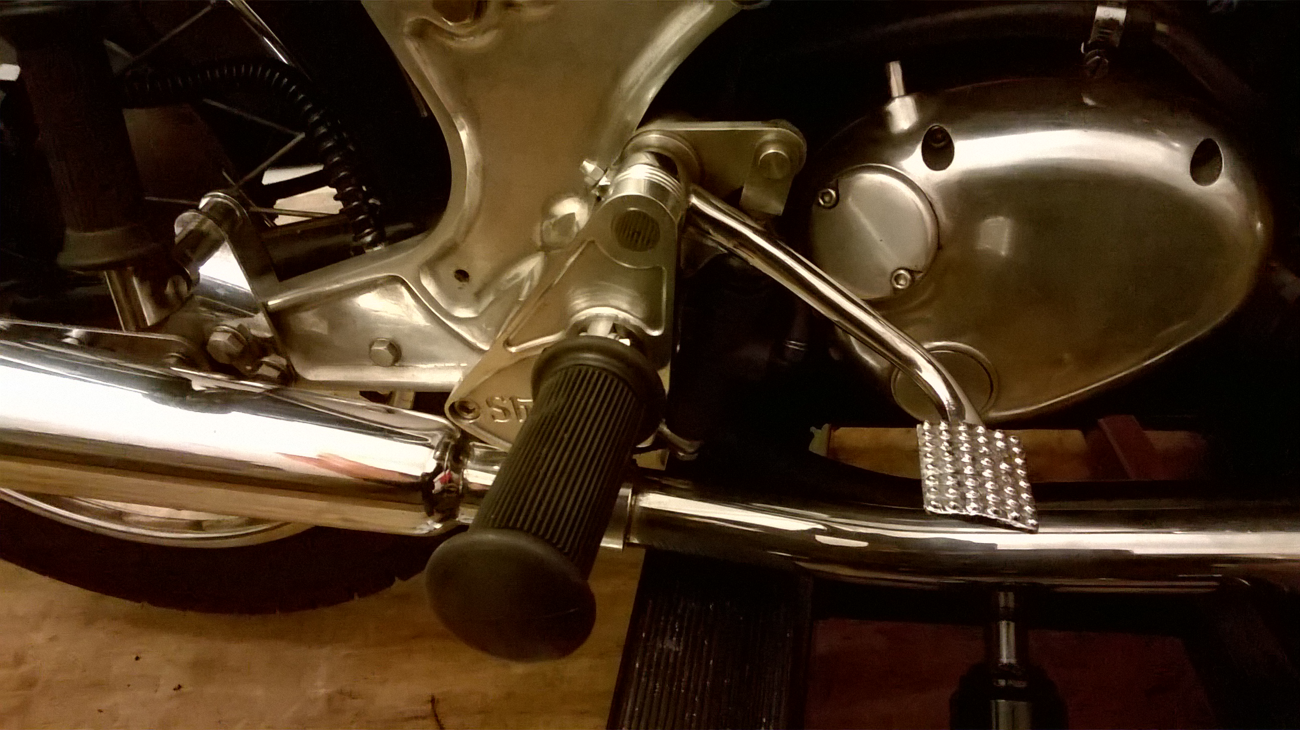

Peter's is rather more svelt than the Hyde offering which uses the original master cylinder (even if I don't):
Where have you hidden the master cylinder?
The hidden M/C
I used a 13mm Grimeca M/C from an auto jumble.
I have a big dislike of the 'loop over' brake/gear pedal that commercial rearsets supply. Getting my Mk3 reliable on the button allowed me to remove the kickstart and fit the rearsets i wanted and also use the original brake lever.
Mk3 Rear Brake Pedals
Peter, it looks to me as if Stan's is using an original lever. The curved type was a feature of early production Mk3s. I've only noted it on those which preceded the *850* engine number prefixes...May 1975 or so and after that they changed to the straight version.
Yes, that is an original…
Yes, that is an original Norton brake lever from a crash damaged Mk3 I bought in 1976.
When Peter referred to 'loop over' I assumed he was thinking of something like the gear lever on Tickle rearsets with a remote linkage. Never seen that pattern used on a brake lever though.
Yes, the kickstart is rendered almost unuseable by the Hyde rearsets, hence why it's not fitted. This shows how the kickstart has to be positioned, and the use of the original brake master cylinder: https://www.garagecompany.com/bikes/european/hydecommando/IMG_6418.JPG
However, we are getting some way the original issue. It occurred to me that it might be possible to bolt a "dropper" plate onto the Z-plates and relocate, or simply re-angle, the Norton footrest hangers down a bit to the OP's taste. It would move the footrests even further out but it's easy to do and, when the ideal position is found, rework the Z-plates themselves.

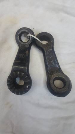

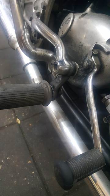

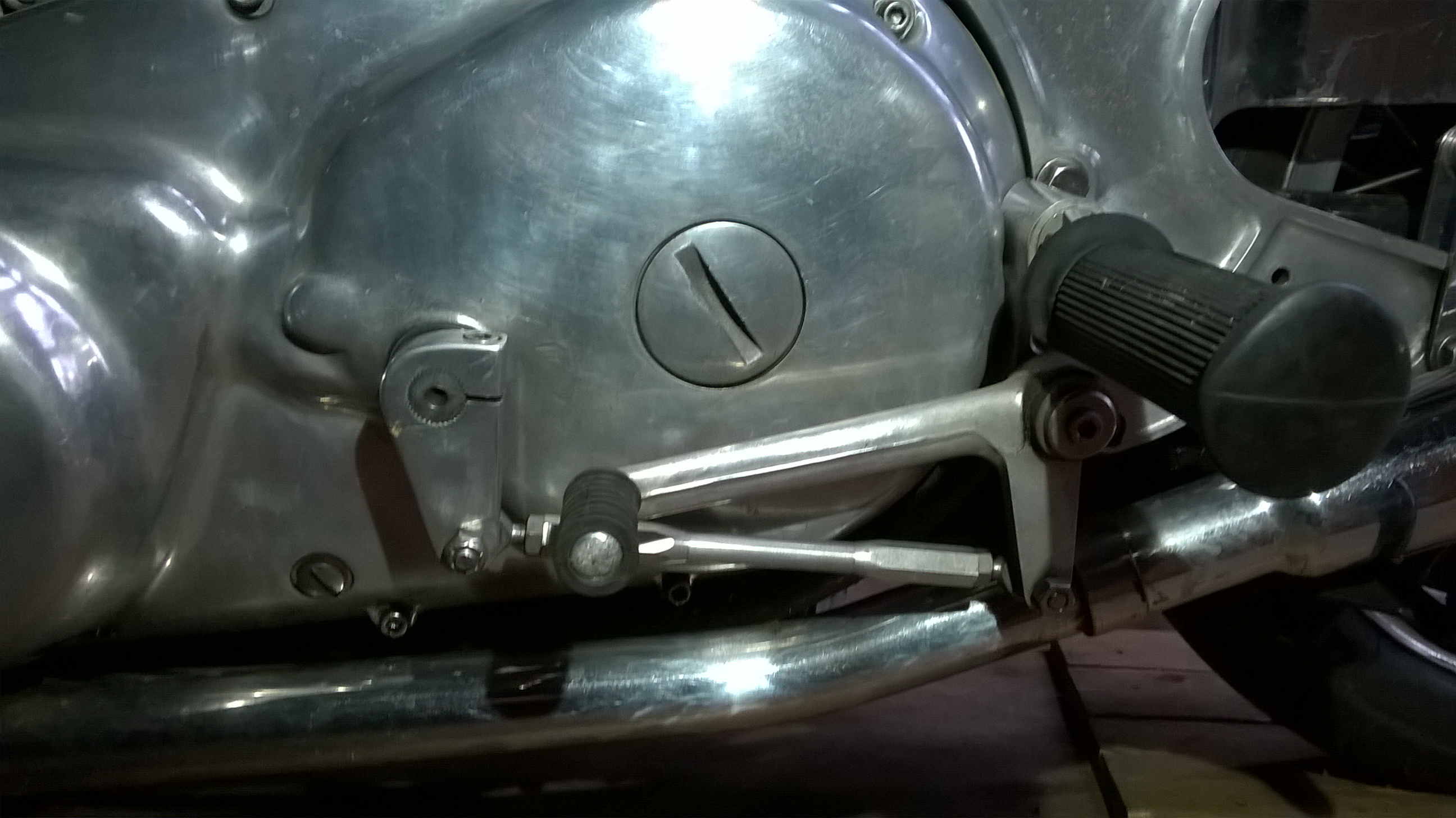

Solution on a Mk1
Heije Meinders of the Dutch club was also tired of the footrest position on his Mk1 850. He had some footrest brackets of unknown origin lying about and used one on the right hand side. For the left hand side, he tilted the footrest downwards by relocating 2 of the studs in the alloy z-plate. The pegs left and right are at the same elevation.
He is quite happy with this mod.
Attached the pictures he posted me.
BMW /7 pillon footrest…
BMW /7 pillon footrest hangers at a guess.
