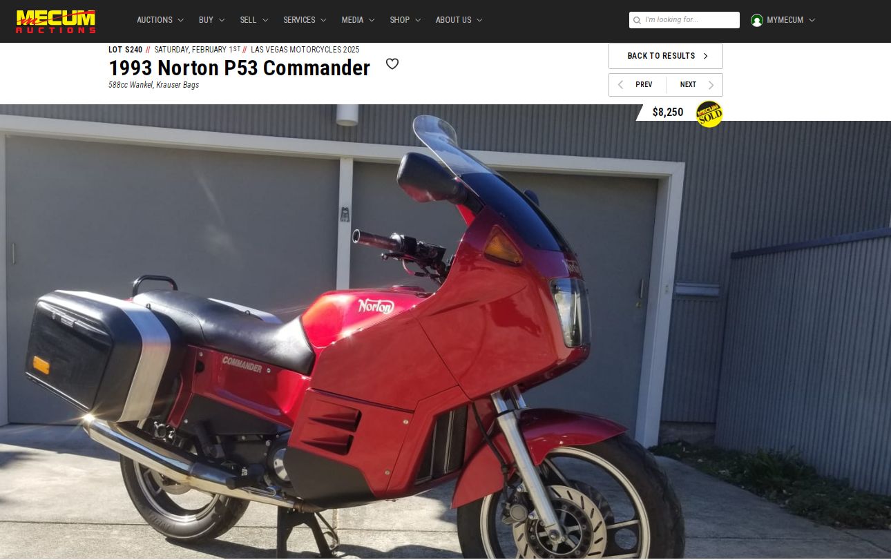

Now that my concerns about engine oil burning have eased, I must keep a look out for a decent bike coming on the market.  I spotted the ex Dubai police bike that was sold by Mecum Auctions in January.  I would have jumped at the chance for that one, but I do tend to only spot such auction bikes after they have sold!  I couldn't see what price it achieved - anybody know?  If there was a similar one around, I'd love to know.
