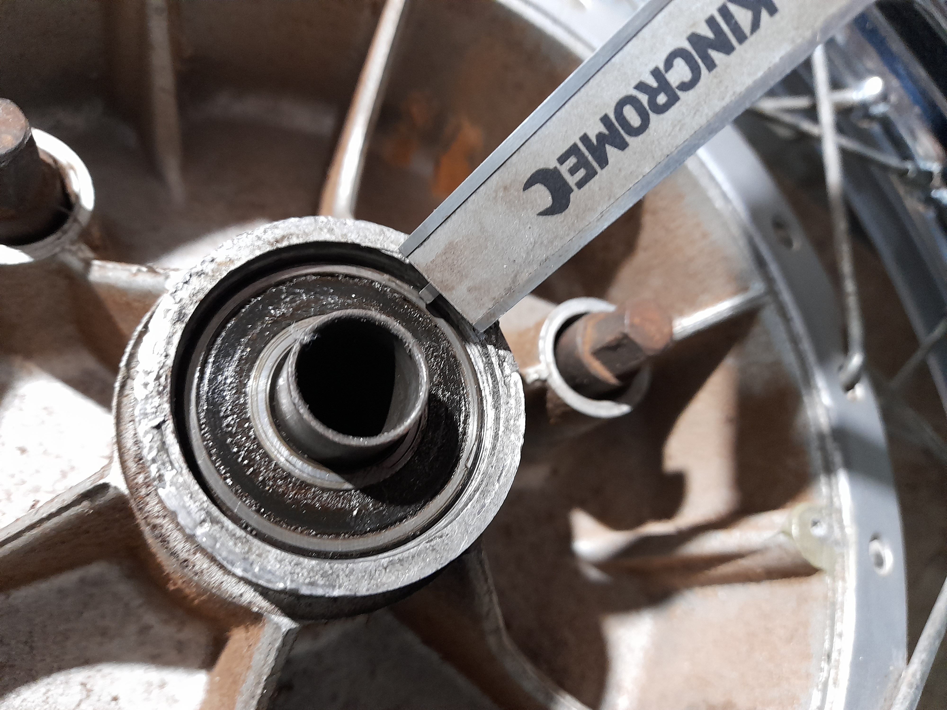

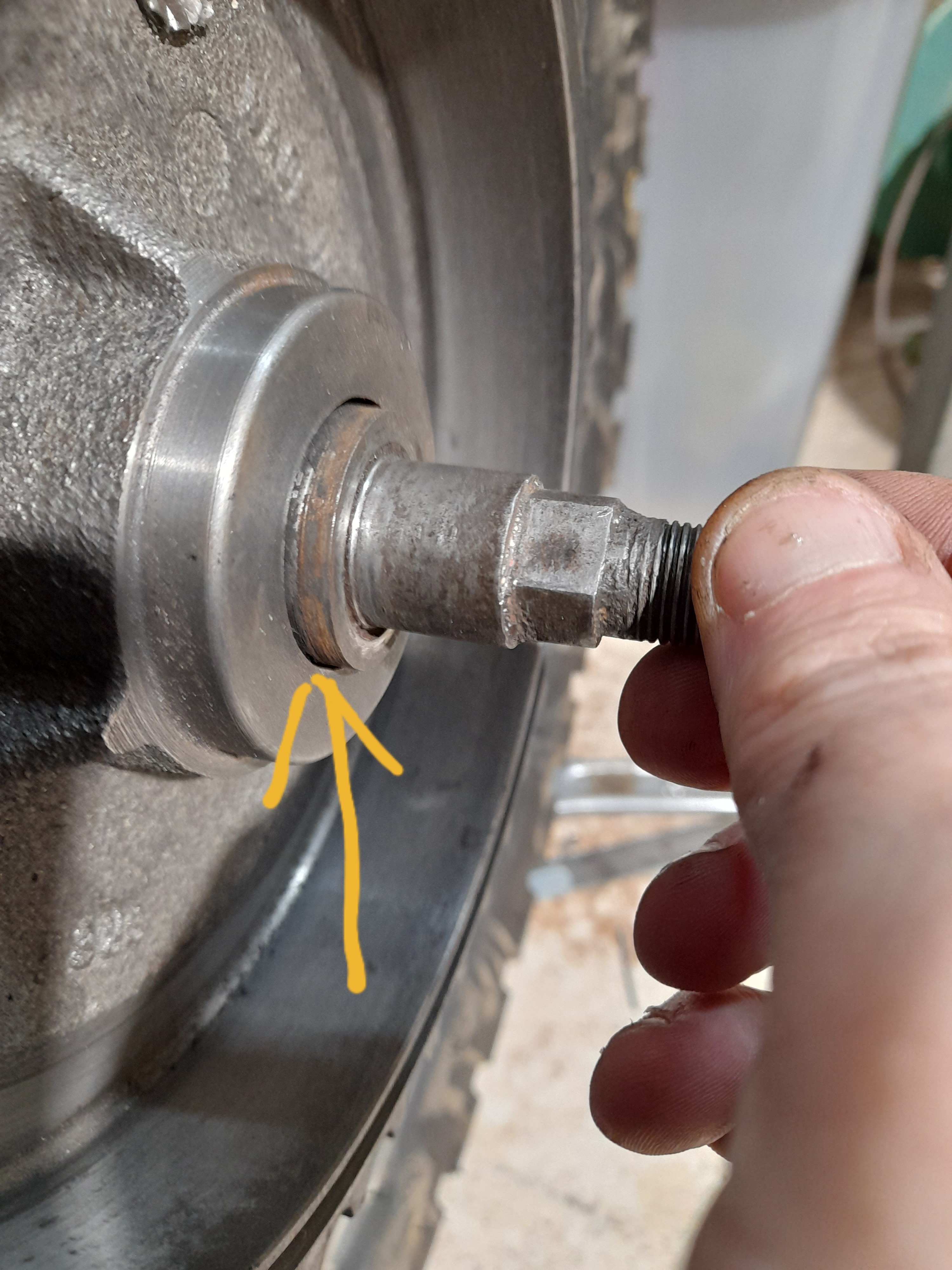

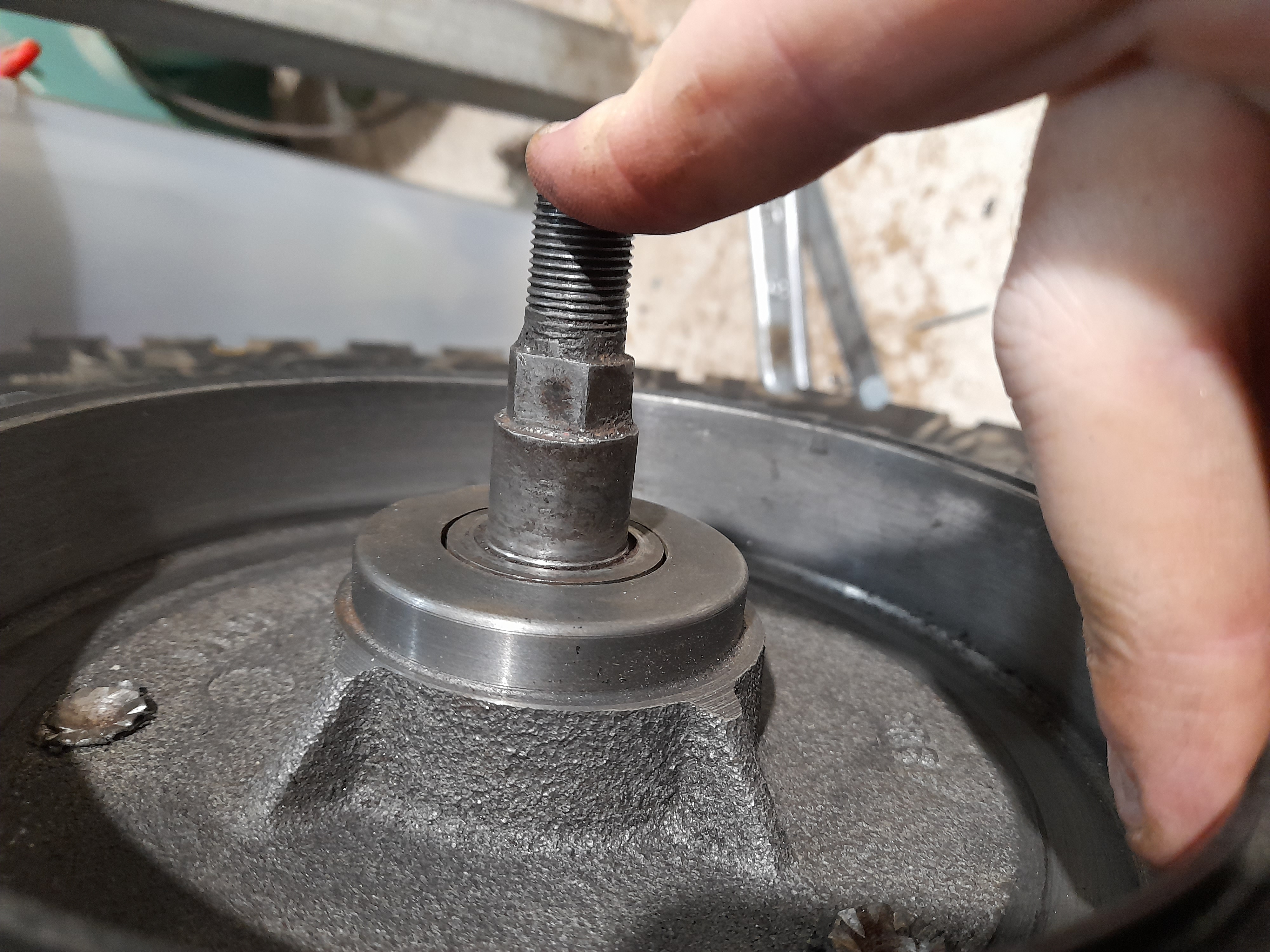

I believe my dominator rear hub has the wrong bearings installed. The outer hub plate wasn't sitting in the groove and noticed it was sitting on this lip. I'm sure it should be flush.
I undid the other side (with the left handed thread) and smacked it with a rubber mallet. It then came down flush where it should be, however it pushed the bearing to the other side now giving little area to screw the left handed bearing cover back on.

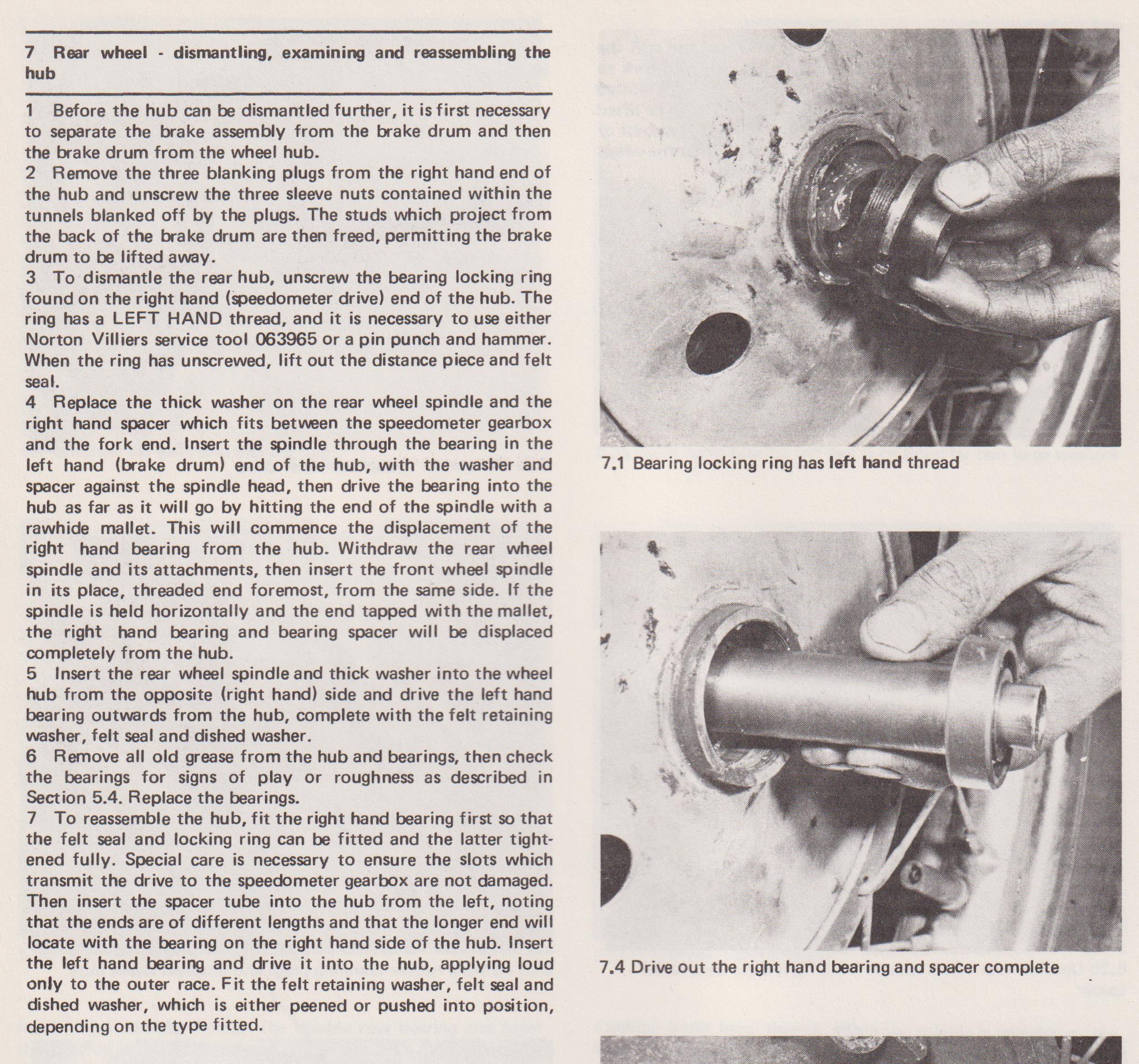

This is a known problem that can occur when the inner spacer sleeve is fitted incorrectly.  It is about the only time that the Haynes Manual gets a re-assembly procedure right.  In my Manual the answer is in Chapter 7 Wheels, Brakes & Tyres sub-section 7 and paragraph 7.   See attachment for more details.

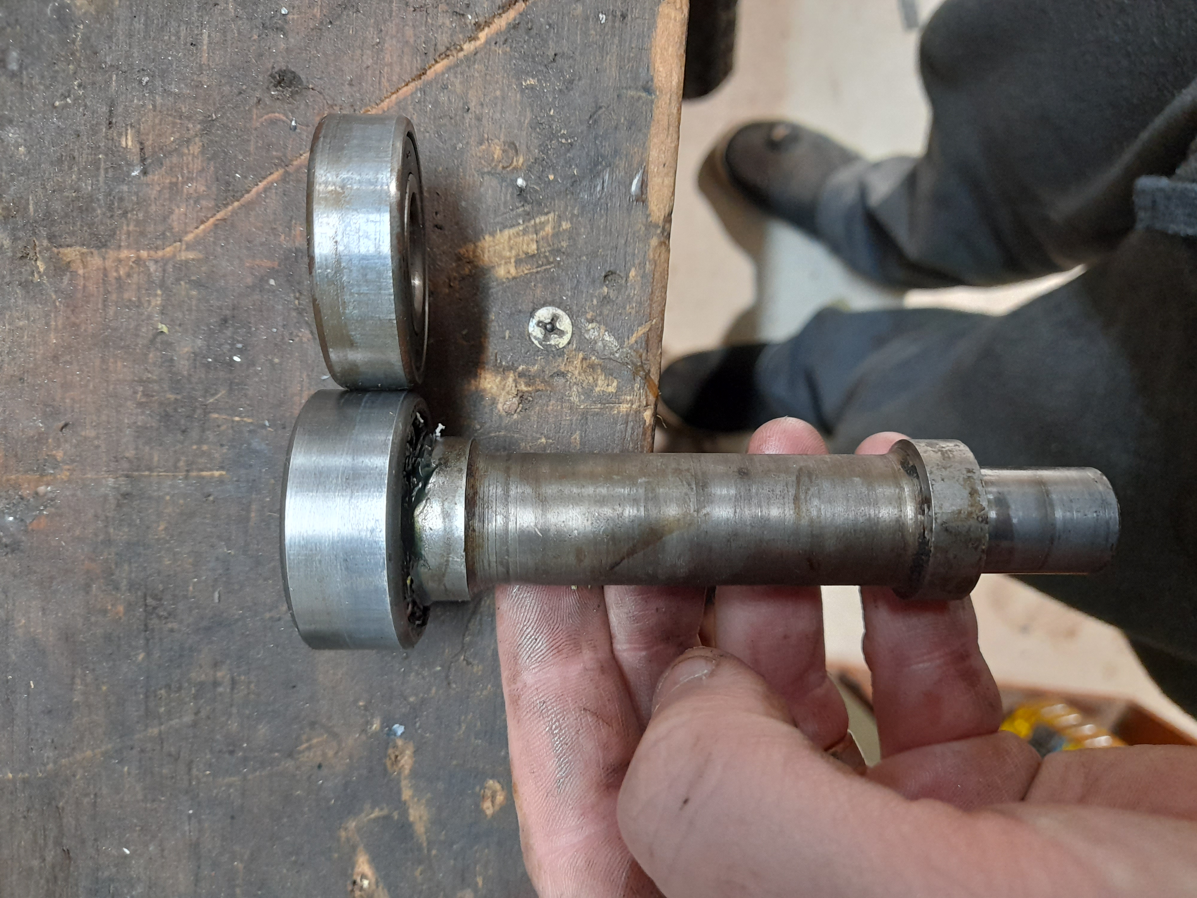

Basically the sleeve has a short shoulder that the right side bearing fits on and a longer shoulder for the left bearing. Get this sleeve spacer the wrong way round and one of the bearings will sit proud.

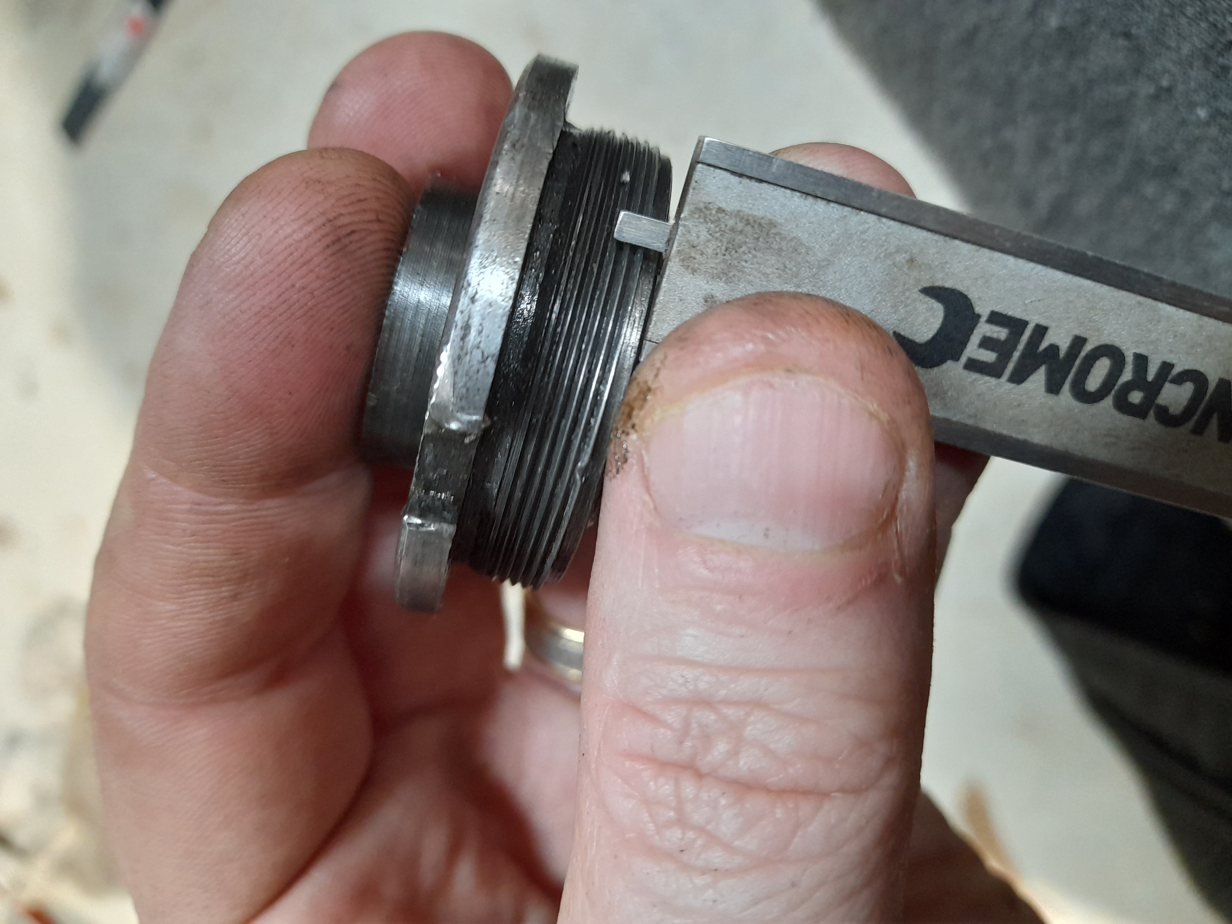

The right side bearing sits under the screwed in locking ring. This is the side to sort out first. Remembering that this locking ring has a left-hand thread.

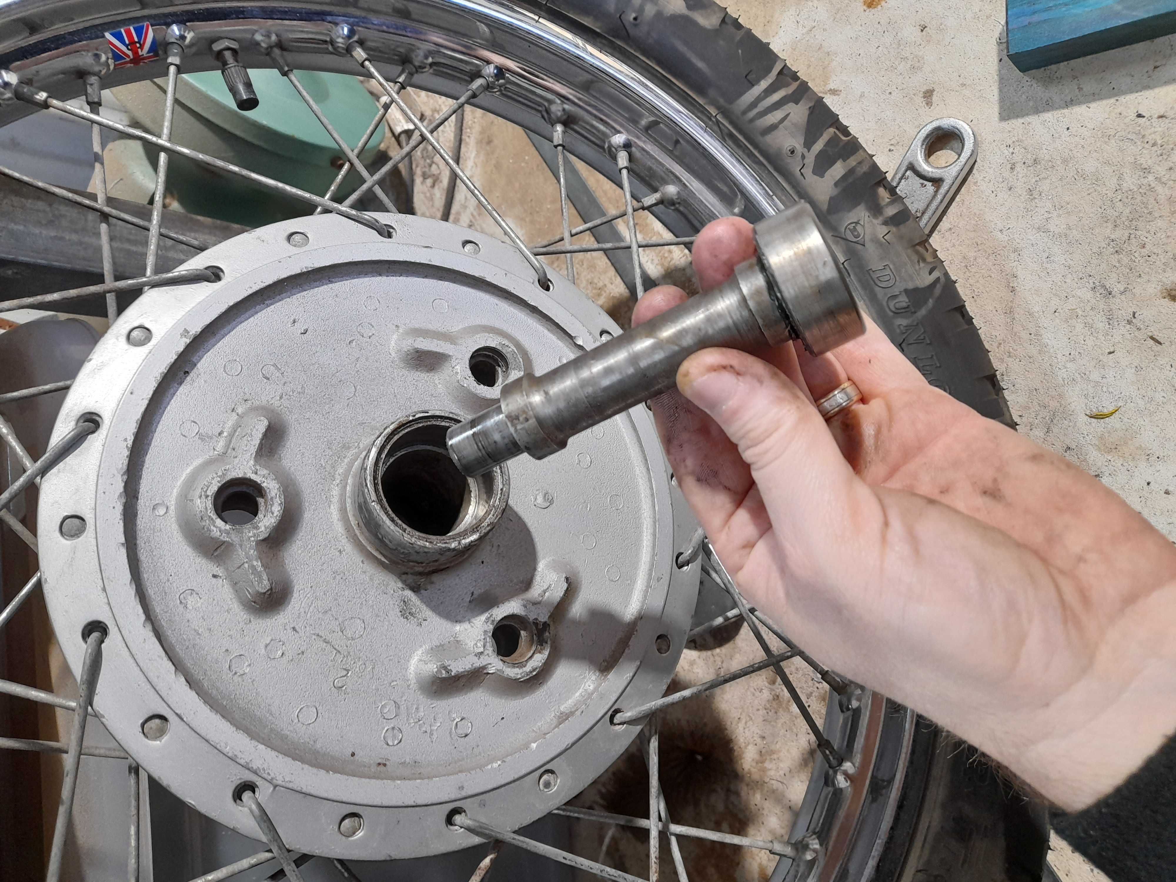

Popped out the bearing and sleeve.
This is how it was, photo attached
Easy solution then........well done Haynes.
The extra chunk of spacer tubing holds the Top Hat Washer central in the Speedo Drive Box.

Although, I went to turn it around and one bearing is fatter than the other....
The 2 bearings on the Andover Norton link I posted are
10. BEARING 6203-2RS 17 x 40 x 12mm
11. BEARING 17x40x16mm
so 11 is 4mm wider and is on the sprocket side of the hub.
