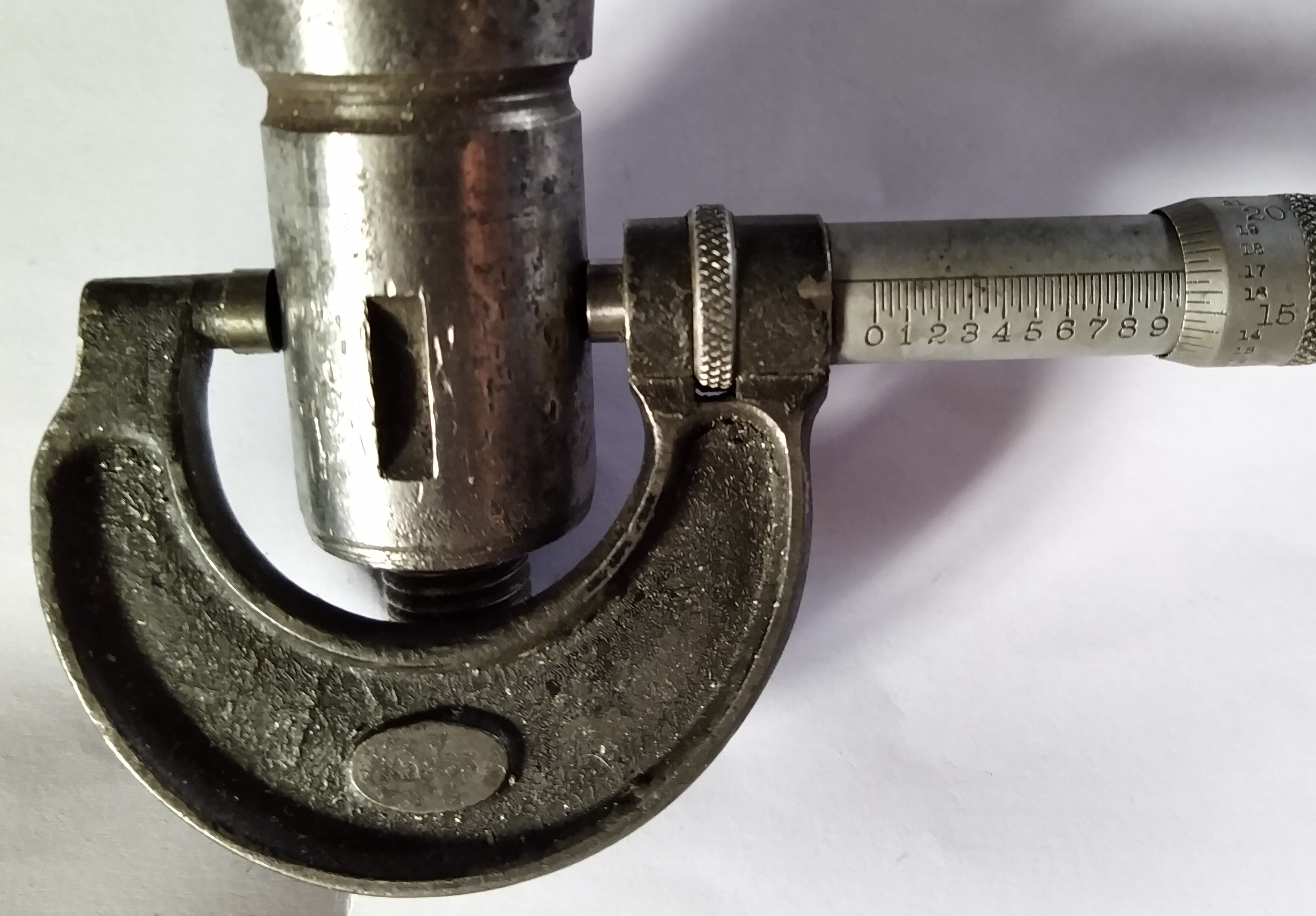

My Navigator crank shaft measures 31/32" (0.968") diameter, I've also measured a Jubilee crank that is the same.  The rotor is a good fit on the crank, as it should be.

The crank dimensions are THE SAME on all 3 models, so the magnetic rotor is ALSO the same on all 3 models (Jubilee, Navigator & Electra). However, the stator (coils) are different for the Electra (it is wired 2 coils + 4 coils), as opposed to the Navi & Jubilee (3coils + 3coils).
The crank dimensions are 0.9670" to 0.9675" - which, as you can all see, is a whisker less than 1"

So sorry. The Wipac rotor of the Electra is the same as measured by John.
Just measured both.
