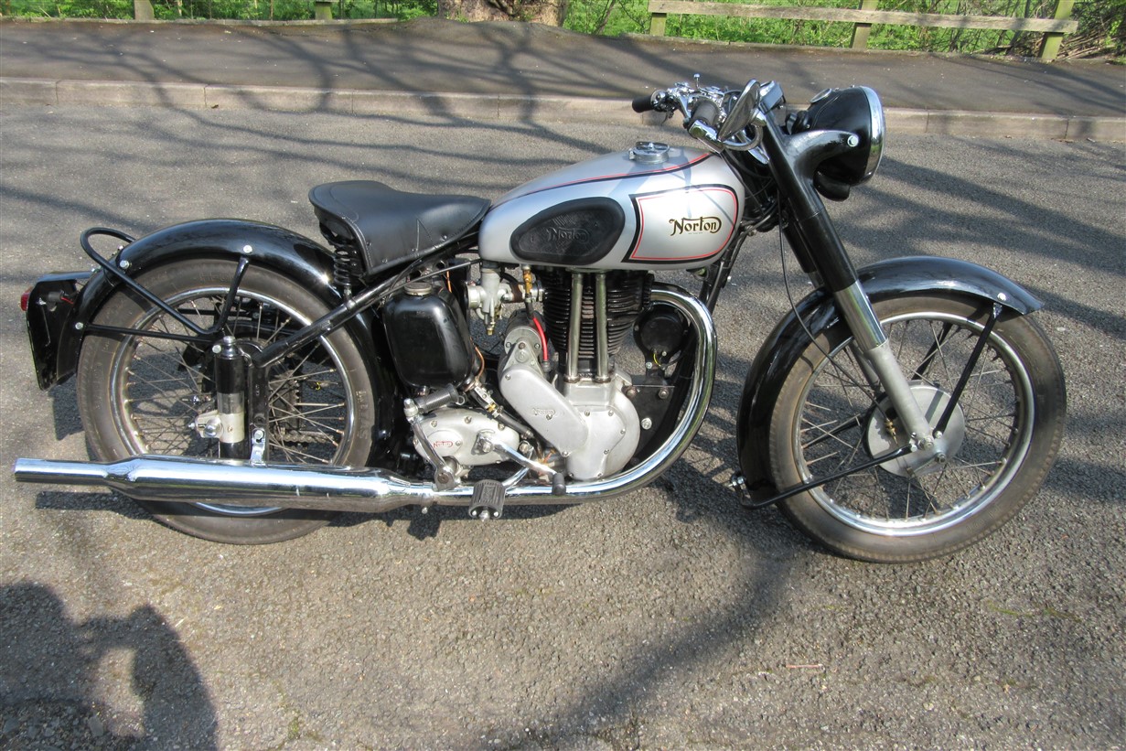

The Paragon paint gives a high gloss finish; is touch dry in 24 hours and it's very hard. This photo flatters it a bit - I'll be redoing the mudguards as there are some flaws but smart enough for the time being. BTW the oil tank hasn't been repainted.
