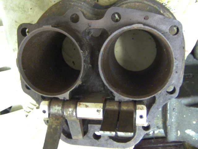

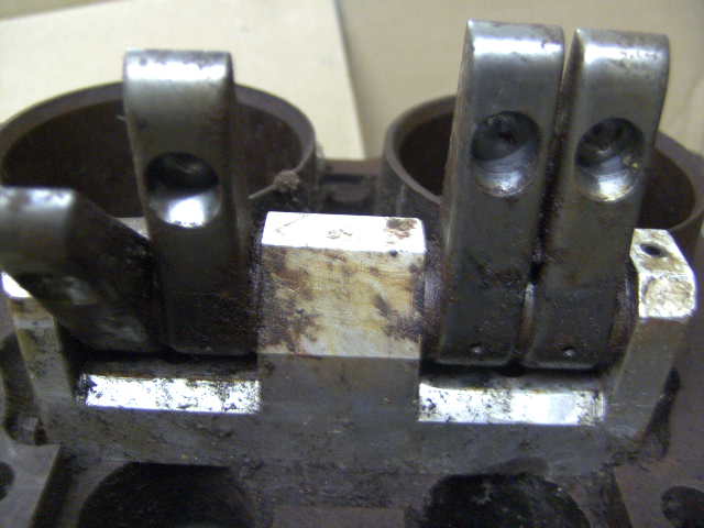

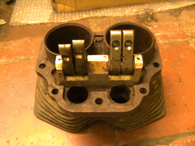

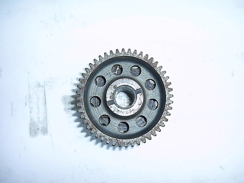

This bike had the 1.6" rod journals, the needle bearing cam and timing gears, bucket cam followers etc. but it used an iron cylinder. This is a recent photo of it, it is race-ready. Heinz tuned it and preserved it for the last 48 years!
The 1.6" crank was broke, but Heinz found that the standard 1.5" crank was just as good or better if it was used with steel Carrillo rods. I would like to see a real Domiracer turn up someday, but the Kegler bike may be the last bucket-follower works twin left intact.....
Here is it's spare valvetrain:
http://img213.imageshack.us/img213/7809/valvetrain1.jpg
And a close up of one of the special bucket cam followers:

There is a link to a photo of bucket tappets etc. in the link earlier in this thread. It is part of a page with photographs and information on the Norton sport/racing bikes from the Domiracer era that can be browsed by anyone. I think there might be a close-up looking down the throat of one of the tappets there.
