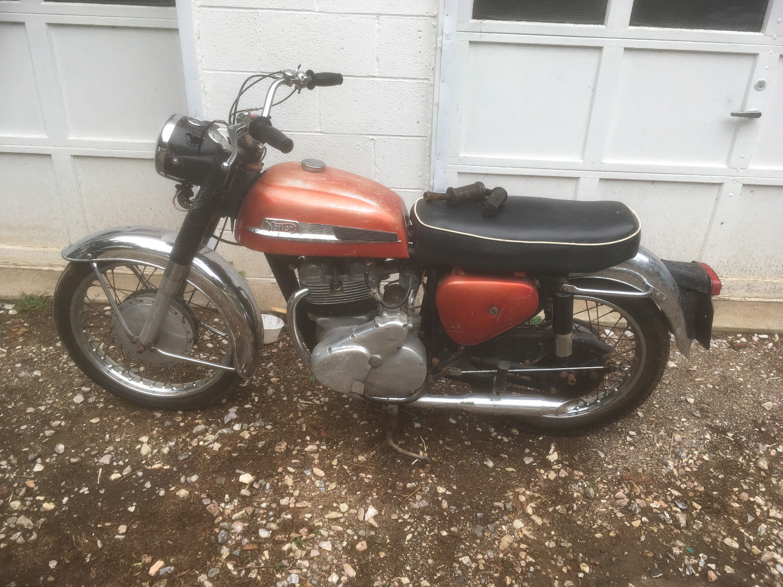

Thanks for all the supportive comments.  I have a number of steps to go before my Electra is road-worthy including clearing 25+ years of rust from the petrol tank.  But it was bought as a project and I'm not cutting corners to get in on the road.  The end result is meant to be a rideable bike with patina - not a full restoration.
A current picture of the Electra would just show a partially assembled bike on a portable lift.  So I've attached one of what it looked like when I bought it.  As always pictures can be quite deceiving and in the case of this one my heart sank when I got the bike and began to take it   apart.  But I'm so pumped up now that I'm considering the remaining tasks as enjoyable rather than daunting.

Hi i,m also a Holgate that owns an electra be glad when i get the gearbox sorted on mine
Great picture Jack, the bike looks as though it is in good original condition with only the colour (I think the original Electra colour was silver) silencers and handlebars not original and the handle bar end indicators missing - all readily available if you want to get it back to original spec!   Is it a US model or one of the few which stayed in the UK?  It looks like you have got a great starting point for a sympathetic restoration - very envious!  My Navigator was in a similar condition with reasonably good original paint so I have retained that patina and concentrated on doing long overdue deep maintenance.   As always there was masses of cleaning, then new tyres, front rim and spokes, fork stanchions, bushes & seals, brake shoes, wheel bearings clutch, chains, carb, cables, wiring harness etc etc!!!) curing the oil leaks (it can be done.....although that is a constant battle!) and getting it running as well as I can.   I shudder to think of the cost!    The only things I have changed from original are fitting Pazon electronic ignition.   I can highly recommended this - it has completely transformed the engine and bike which is now quick and easy to time accurately, ticks over like a swiss watch and runs cooler, more smoothly, and more powerfully which vastly improves the riding and owning experience!   I have also converted it to 12v electrics (you already have that!) and changed the original cheap and cheerful handlebars and levers for Norton flat bars and good quality levers.   It is now a very practical, reliable and enjoyable bike to ride with superb handling and is remarkably nippy for a 350 although I try to treat it sympathetically!   Good luck with yours and keep us posted with progress and any problems we can help with - there is plenty of experience out there to draw on!    Nick
