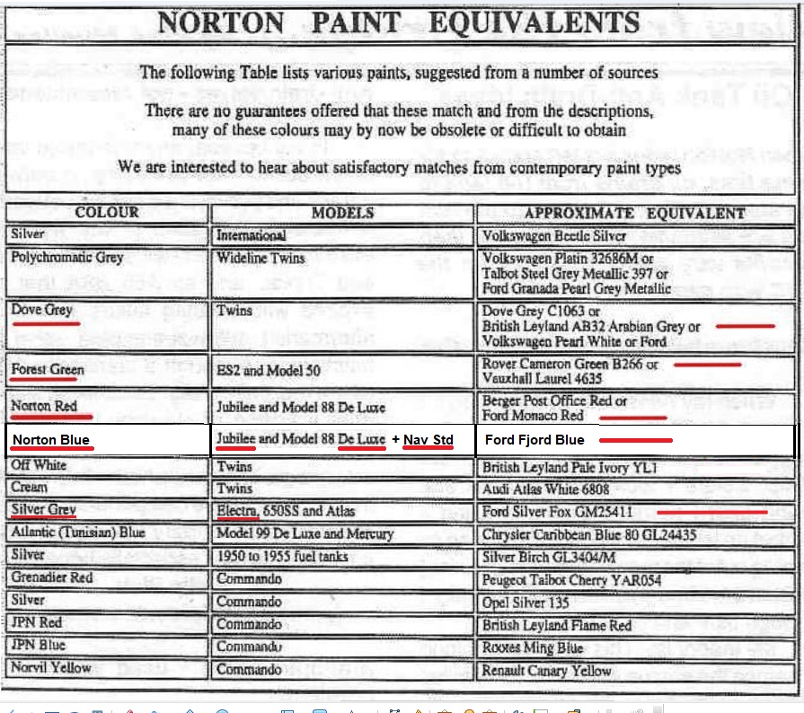

Dove Grey definitely has a hint of Grey in it, and was used on the two-tone Domi De/Lux and the Lightweight (Birmingham built) bikes. The closest match I have found is British Leyland Arabian Grey, as Phil Hannam says above. (Phil is close to God in Domi matters....)
Some time ago, a helpful chart was produced - I have marked in Red the colours that apply to Lightweight models. I have added in the Pale Blue colour used on Jubilee & Domi De/Lux - (looks like Ever Ready Battery Blue) - Ford Fjord Blue - see attached.
Enjoy!
A good match for the old Ford Silver Fox, is Holts Auto Spray Paint HSILM 25..
Available in a rattle can from Motosave.  (Other outlets are available).
It's a two stage paint, so needs a clear lacquer top coat.
