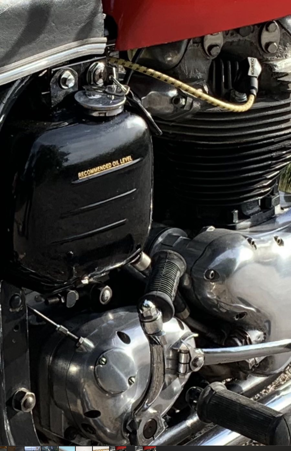

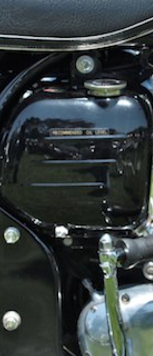

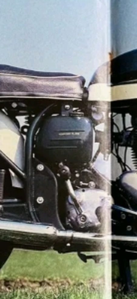

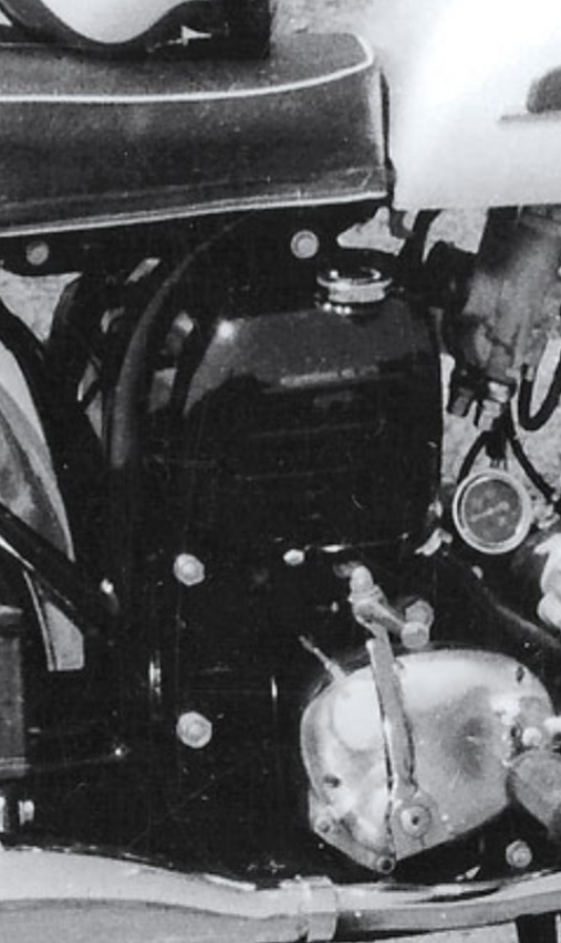

Hi all
Could someone please let me know the correct position for the oil level waterside on the oil tank on a slimline dominator.
I've seen photos showing it ontop of the top Ridge line and some show directly under the top Ridge line.
Steve
Just above the rib. Every Dommie owner needs a copy of Bacon's Norton Twin Restoration. For period pictures etc.
