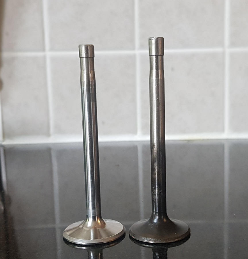

Norton used two valve lengths in the life of the Commando, as Steve has found above. The change was to add stellite tip, but instead of reducing the length by the thickness of the tip to be added they seemed to have mis-calculated and cocked it right up. If I remember rightly, the thickness of the tip to be added was 0.036'' so how the hell they ended up over 3mm longer is anyones guess.
All other parameters remained the same, so it seems really strange to lengthen the valves in the later life of the engine
Evident by the valve gap adjuster running close to the edge of the valve.
Valve ComparisonThere is a reasonable possibility that the one on the right was originally fitted at Bracebridge St in mid 1961.
I expect that the tappet adjuster now be in a reasonable position.
The valve head is slightly smaller. and thinner, so possibly 5mm difference or 5 threads pitches.
As the only variable is the distance from the valve seat to the tip of the stem, difficult to account for with all other dimensions the same, pushrod length must explain it.
