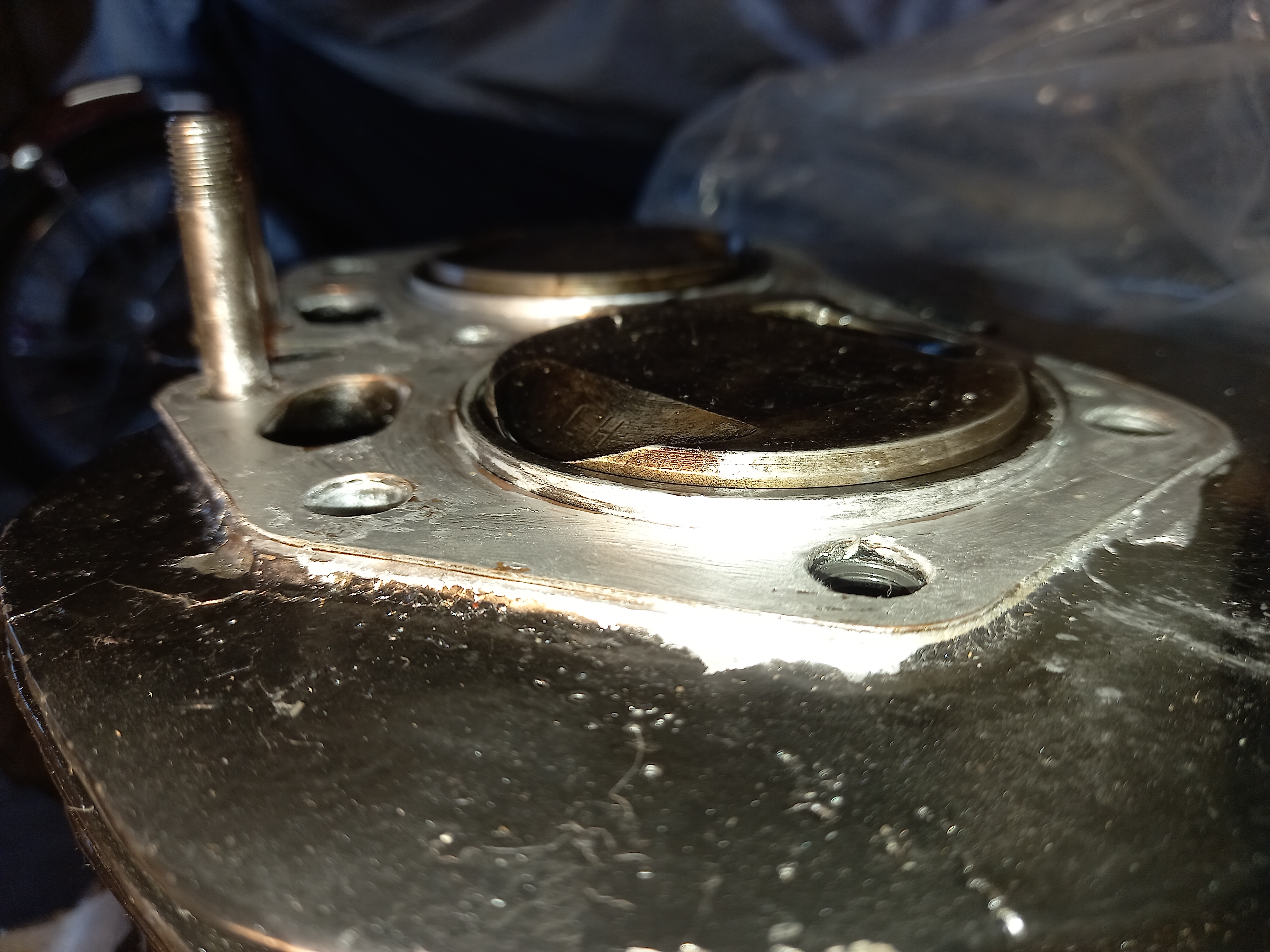

I was interested in your comment that the pistons were 3mm above the barrel deck. Are they Gandini/GPMs? I installed Gandinis in my 500 and this is what they looked like (see attached).
That’s about 3mm above the deck, but the valves did not hit the pistons - checked with engineer’s blue and plasticine. The valve cutouts are pretty deep. The tops of old pistons were below spigot level, though.
That piston crown height…
That piston crown height looks correct for the HC pistons in the HC heads. If flush they are low compression.

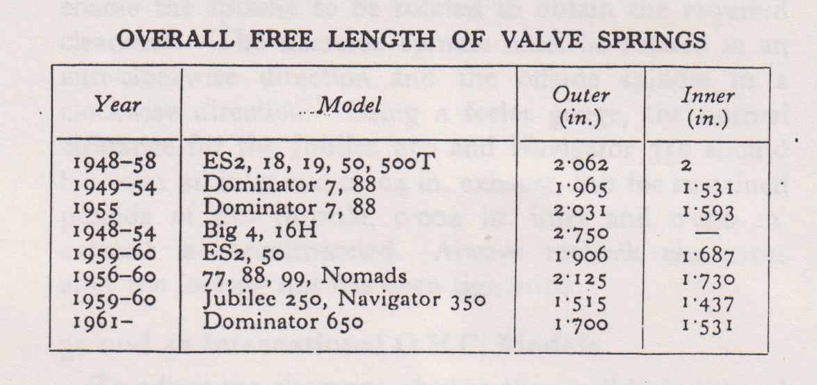

Valve Springs
Bob....I do believe that you are correct in that there appears to be three versions of springs.
Attachments show lists from Garratt and RGM. The latter is the common length sold currently sold for SS head. These are now all 0.10 shorter than the standard 750 Commando type. This being done to accomodate/overcome the Combat cylinder head problem of springs becoming coil-bound when heat resistant washers were fitted under the spring cups.Which themselves had become taller to lift them off the inlet surface. This also helping prevent obstruction of the inlet oil drain hole by the cup..

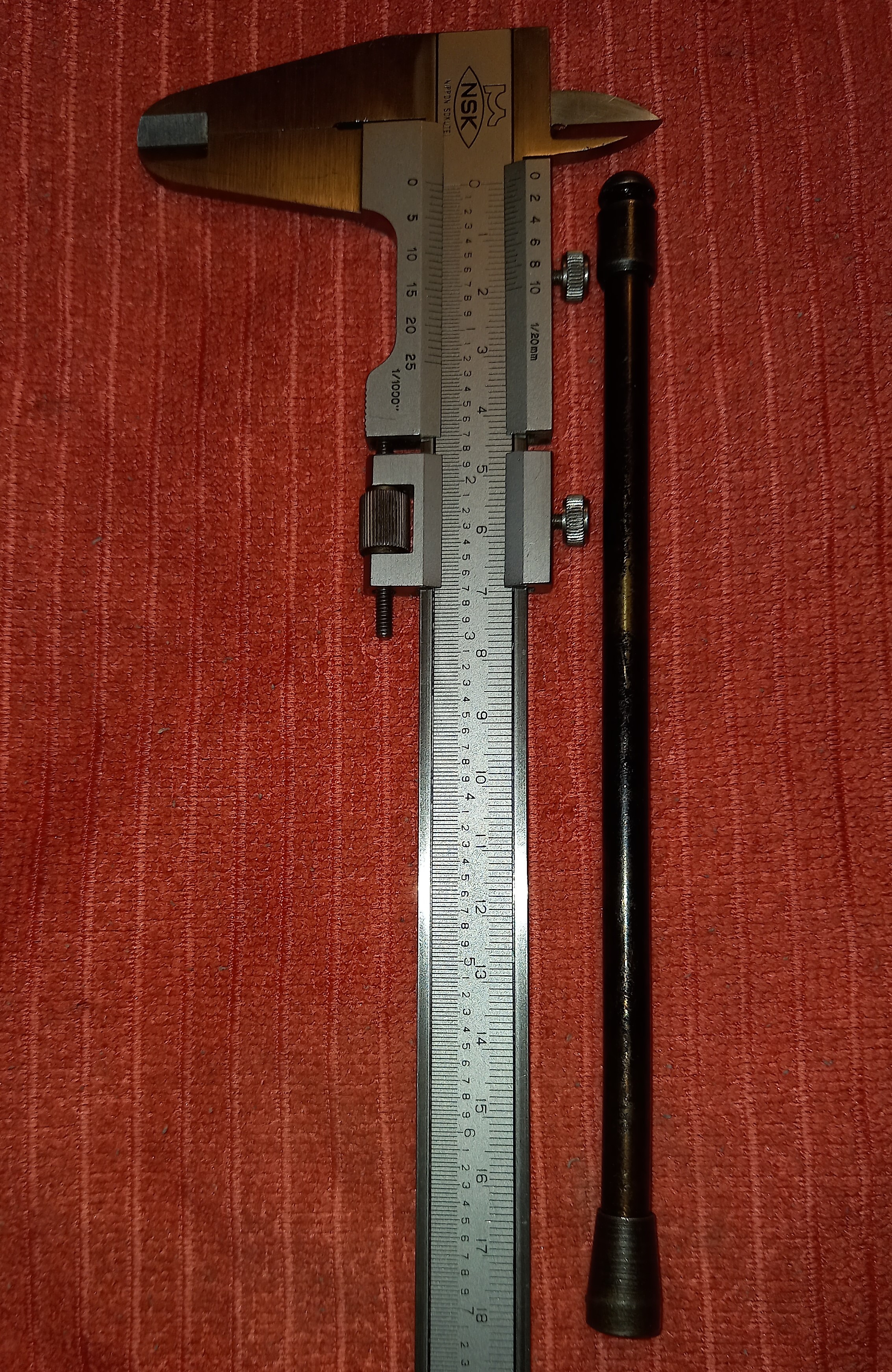

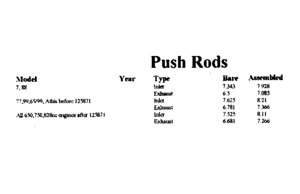

..... I don't quite understand. My photo (Pushrods 7.1 mm dia, 7.0" and 7.9" - 178 and 201mm), do you think they are correct for the early 500 ? Mine is about 1956, it is a dynamo engine. I assume the head is correct but I don't know for sure. What I do know for sure is that the pushrods are the wrong length, too long for the exhaust, too short for the inlet.
I would guess they should be about 173 and 207 mm.

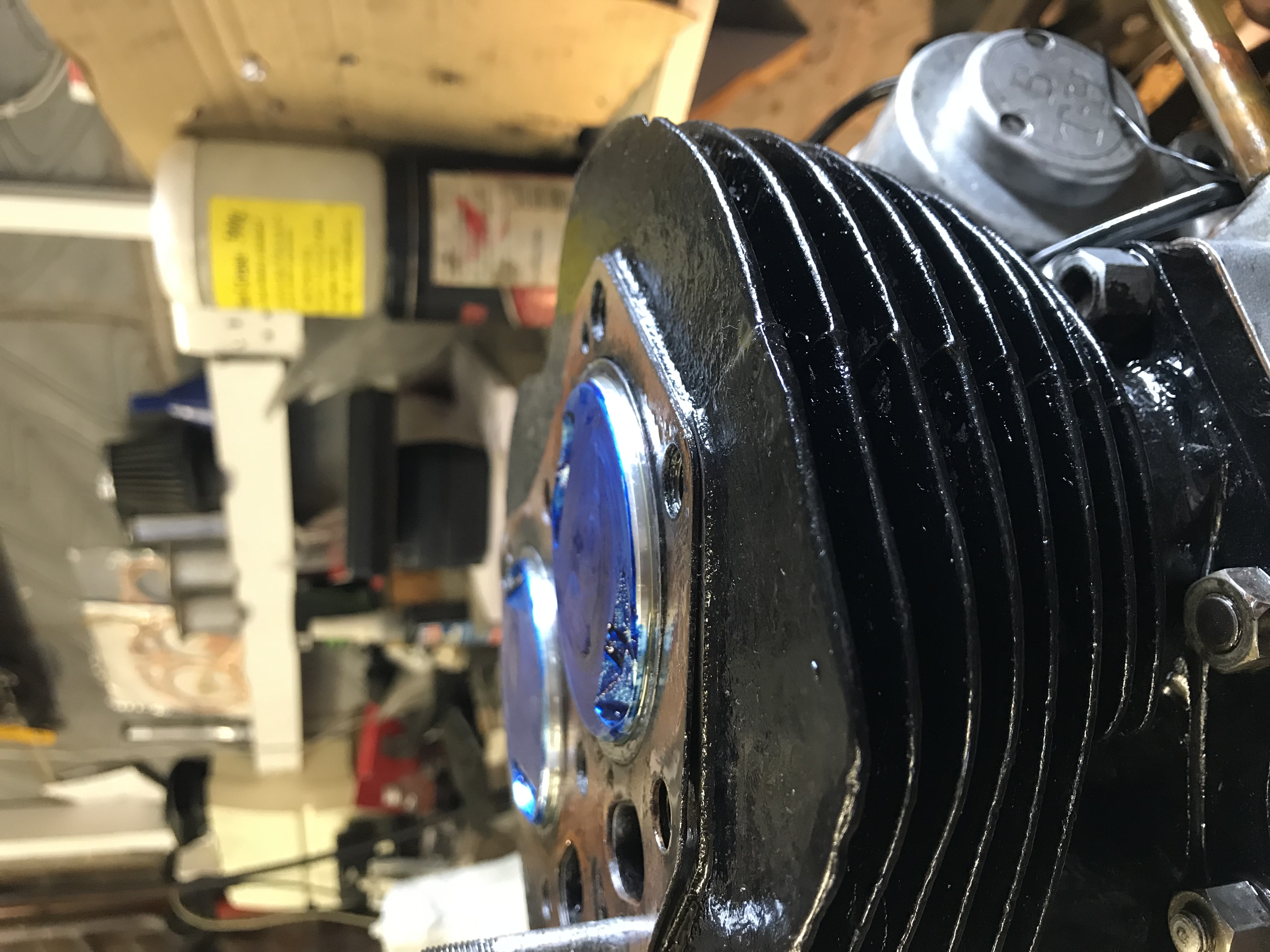

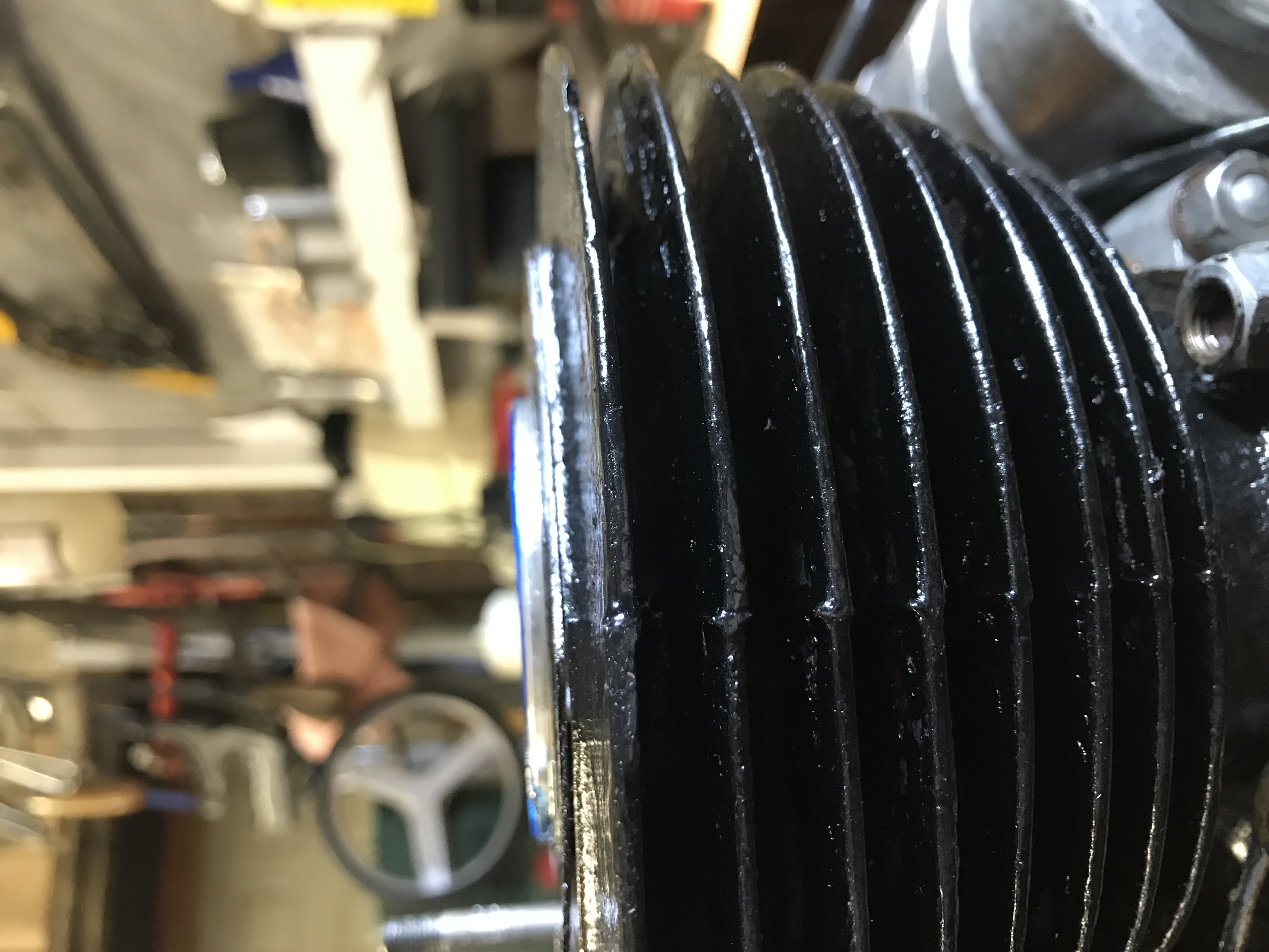

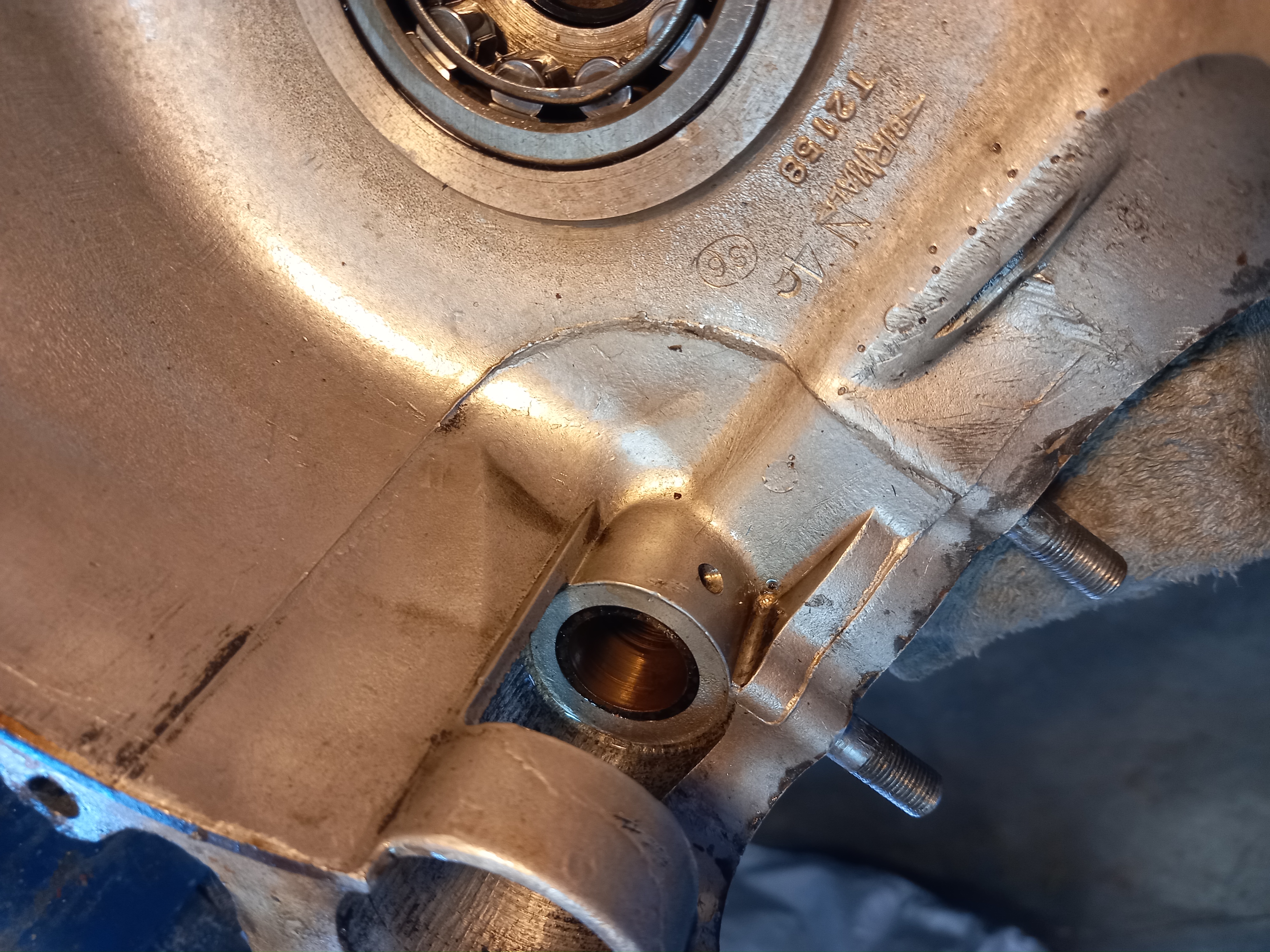

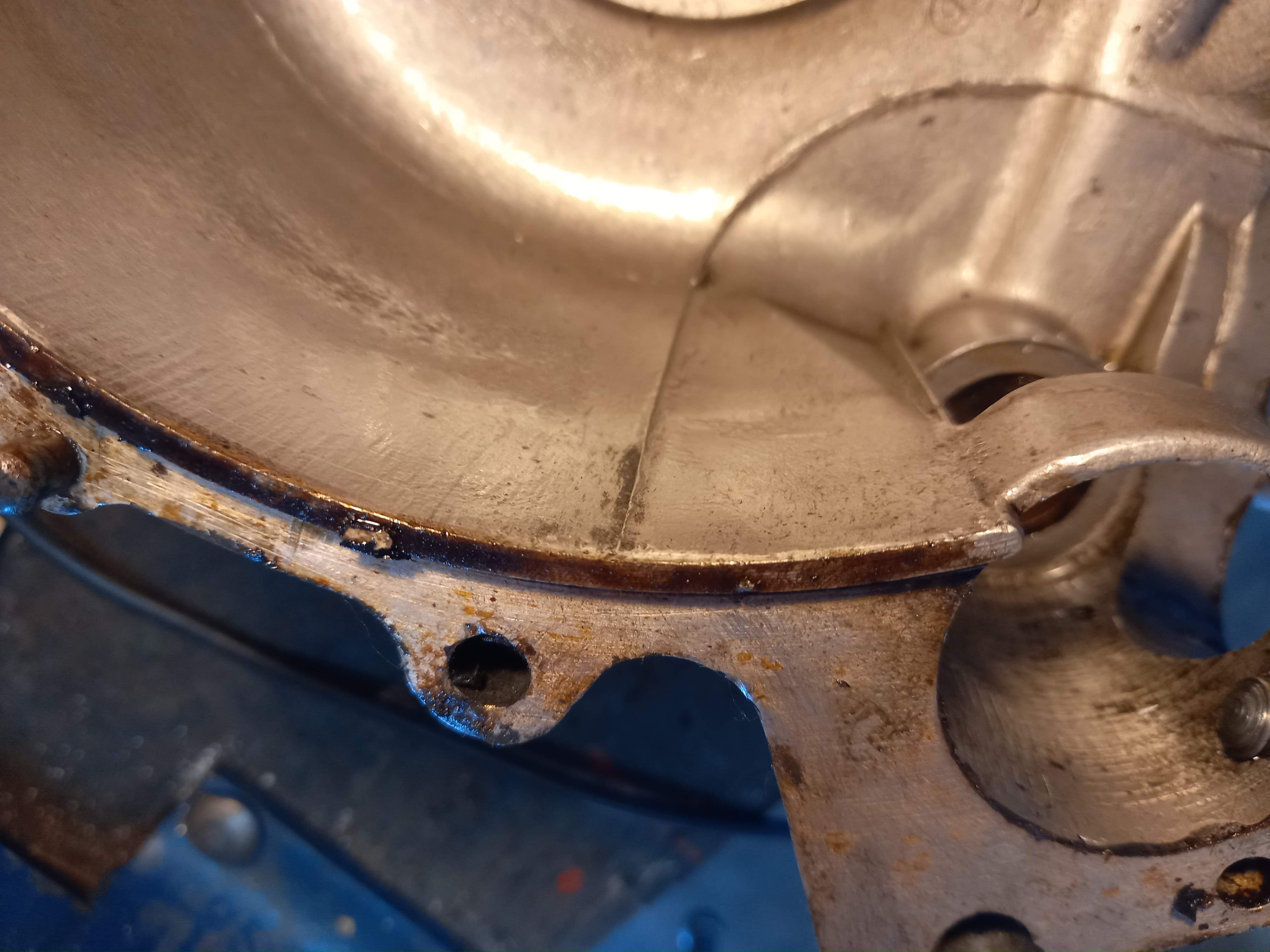

Crankcase crack?
Oh dear, another unpleasant surprise - I hope not.
I've now got the engine apart and found what gave me a nasty fright - but I'm not sure.
The attached photos show what looks like a crack right around the camshaft boss. However it doesn't travel through the flanges, and doesn't appear at all on the outside of the case.
Is it a casting mark? Please say yes!

The lift on my cam is measured at 0.29" - as David Cooper said the standard cam should be.
Russell gave me the following valve spring data:
Outer: 32.77mm ext, 24.87 int, 3.25 mm wire, length 40.68mm
Inner: 23.79 mm ext,17.6 int, 2.32 mm wire, length 36.9mm.
Mine are:
Outer: 31.8mm ext, 24.7 int, 3.6 mm wire, length 52.8mm
Inner: 24.0 mm ext,18.7 int, 2.6 mm wire, length 44.0mm.
So the diameters are correct, but the wire diameter and lengths are very different. If Russell's figures are correct, then the springs in my engine are vastly too strong, probably up to 100% additional loading on the cam and the followers.
Can anyone tell me which spring data is correct for the 88/99?
Thank you all.
Valve springs
Hi Richard
having set this hare running I thought I would pitch in again. P. 31 of the Norton Twins technical digest v1.1 has the following from John Hudson. Apparently, the earlier springs were longer. Having said this, I ran the later springs in my 1960 engine for about twenty years, until I knew better, and it worked fine.
Thank you for this Russell
I have the correct length springs, but I would like the wire thickness confirmed. I have seen one comment that mentions thicknesses a lot less than mine.
