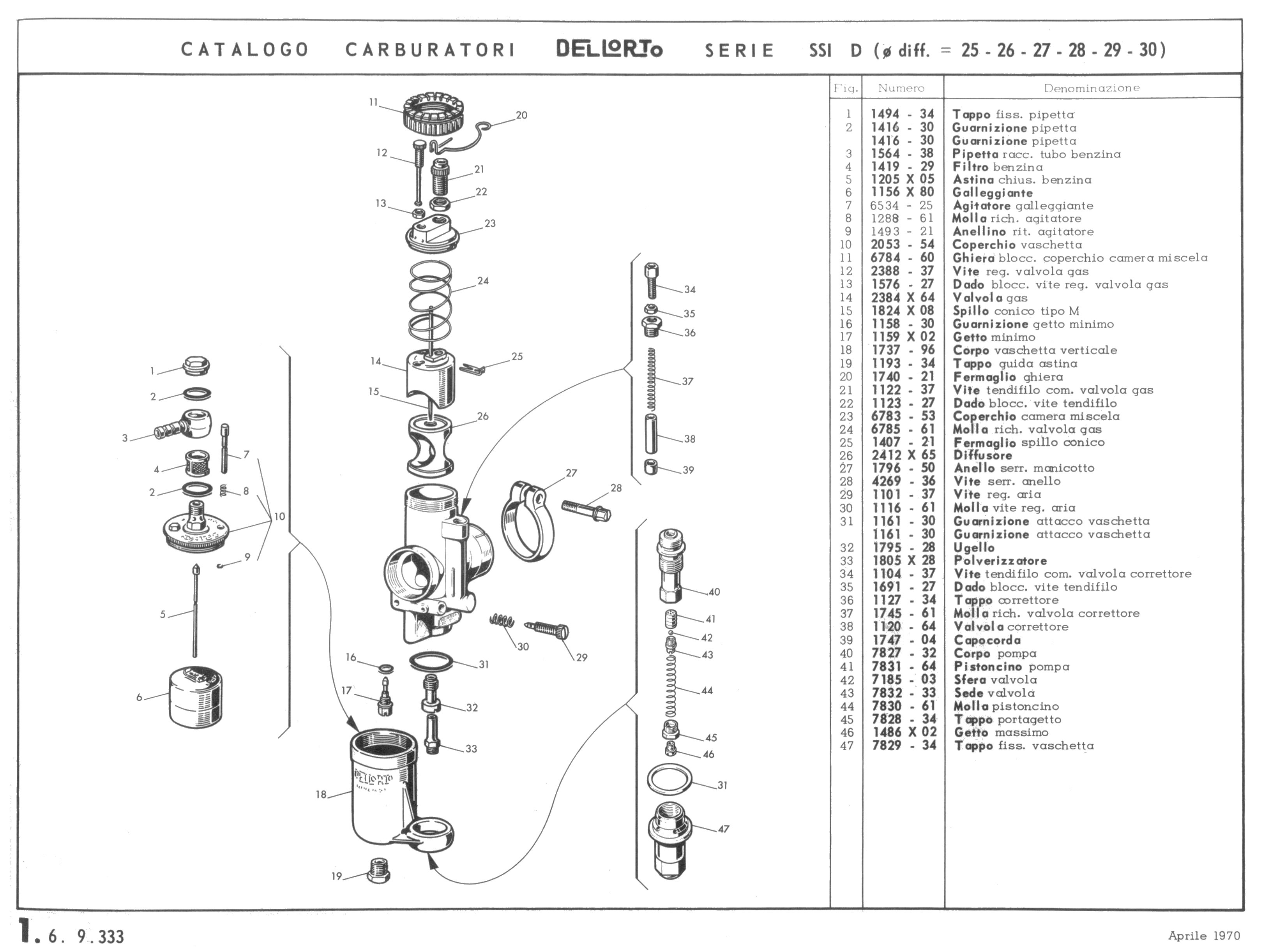

The Dellorto SSI carb is like the TT , no stop but has a slide holding rod that can be adjusted from the carb top. I think that a couple of solder blobs on the bottom of the slide would be a simple solution.
Amal TT came from Amac TT which developed from 1924, and was in production by early 30's, before Dellorto company existed in 1933.  Unless of course Dellorto took theirs from a predecessor Italian firm?
I see that the first web site hit for Dellorto spare parts says the throttle stop above is 'no longer available'.  But it does give a good picture of one.
My PO put a threaded collar on the throttle cable to allow the slide to hang.  It's useful to set a tickover when on the stand, but not stable enough to be of use on the road (ie,g, at traffic lights).  At least it does not make permanent alterations to the carb.
I have an SSI29  carb on one of my bikes, It has the slide stop feature . Not easy to use as its under the tank. Its not as reliable as one would like and I will be putting a couple of solder blobs on the bottom of the brass slide to hold the slide up a little.
