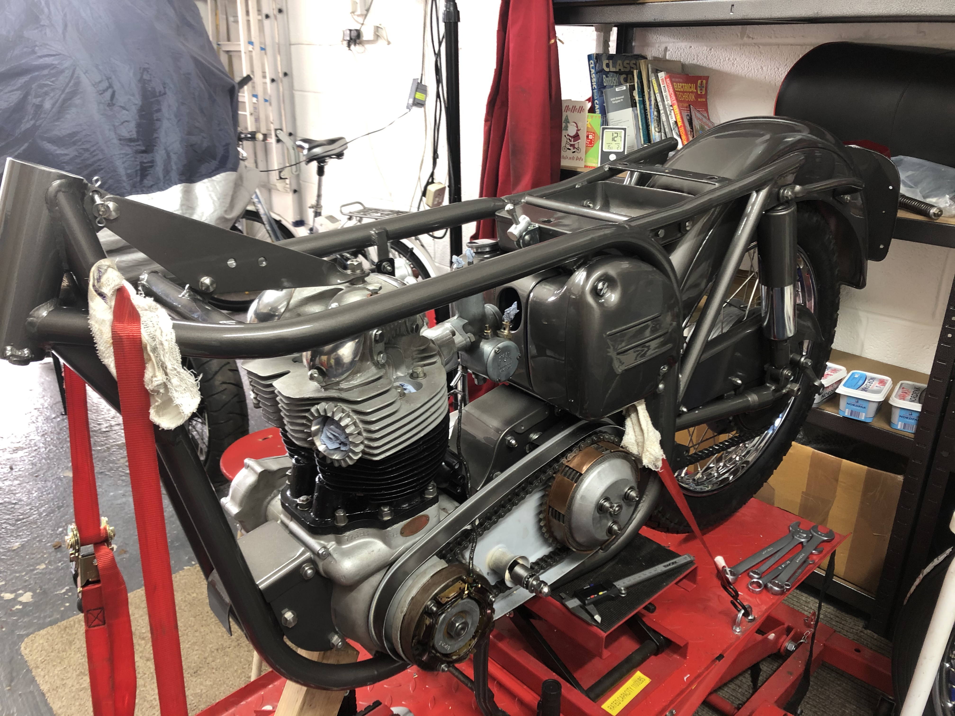

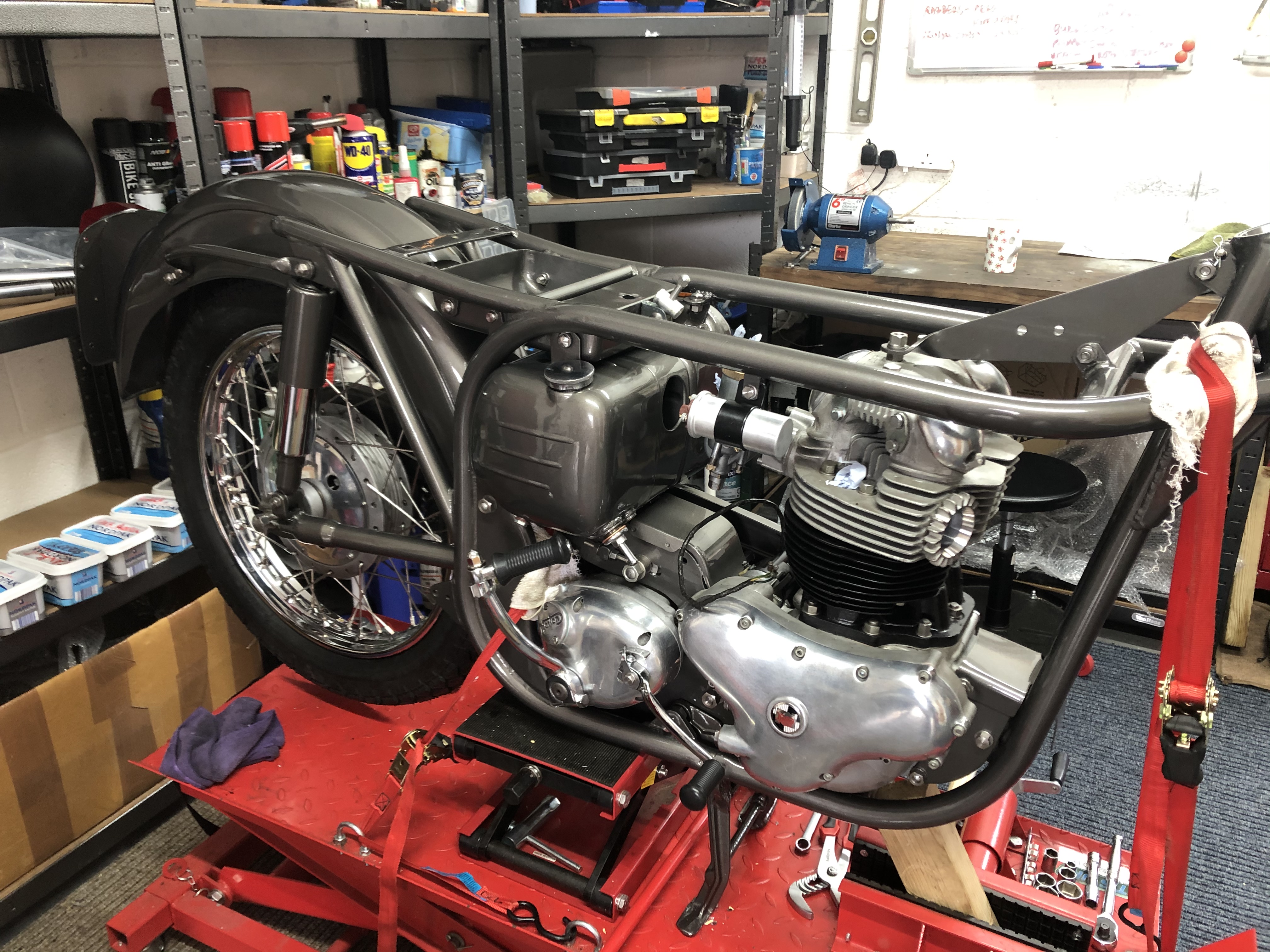

Please can someone advice me what is the correct method for getting 75/70 ft lb torque onto stator and clutch nuts during a renovation!
pics show stage I am at. I have tried assembling clutch and rear brake and had helper sit on, engage top gear and rear brake but cannot get torque on stator nut before clutch slips - putting a lot of stress into the gearbox I imagine.
(I have tried pry bar in engine sprocket - and I now need a new alternator casing)

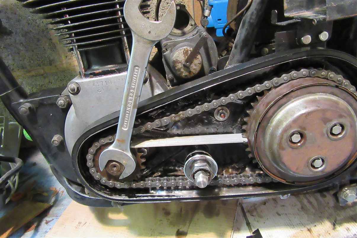

What you need is called a clutch locking tool. Available from the likes of RGM or Andover Norton.
Basically a clutch plate with both outer and inner tangs so the clutch is locked solid when inserted. You have to pull your plates off the clutch before using the tool.
An arm is attached to the special plate so you can react the torque applied on the clutch centre nut.
Personally, I find it best to extend the arm so that it rests on top of the pillion footrest for tightening rotor nut and clutch nut. Then to release these nuts rotate the pillion footrest 180 degrees and have the arm captured under the pillion footrest.

... a sprag between the teeth of the engine and clutch sprocket for this kind of job. It locks them together with no need for compilcated holders and doesn't damage the chain or sprockets unlike wedging things in there.
Easily made from a bit of  scrap alloy, copper, or even mild steel.
As far as the clutch centre goes I use a Commando exhaust nut C spanner - I think there was a mention of this in the current Roadholder.
