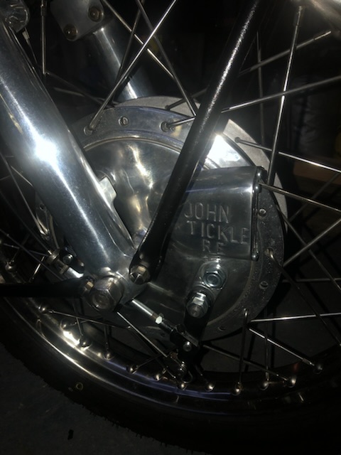

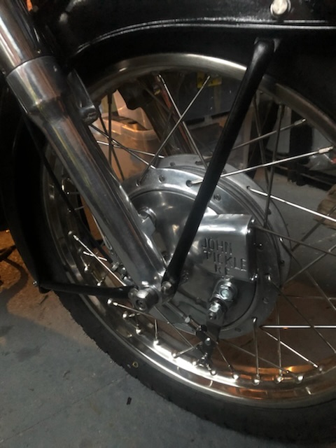

I fitted a John Tickle TLS brake to my ‘63 Atlas with 7” yokes without problems. These come up occasionally on ebay by a Danish supplier as NOS. I suspect only the castings are original, but the stainless fittings are well made and the brake works a treat. I prefer its more rounded shape on a Dommi to the Commando brake. Standard pads fit these and they seem to have stiffening bracket fitted as standard.
