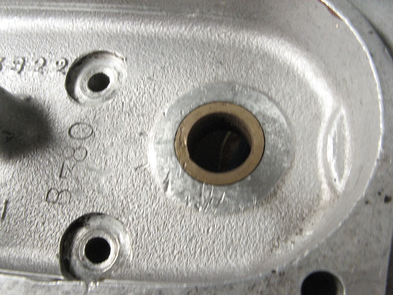

I've got plenty of oil into the Mag/Dyno chain chamber. More than the engineers intended I suspect. The bronze bush looks worn and I would like to replace but can't find one anywhere on-line
Part number C2/19 Camshaft Bush (timing cover) Inlet
anybody know where this might be acquired ?

thank you George ! I thought I had thoroughly gone through the NOC but must have missed that.
I found it on the NOC shop and will order right away.
Well done ! Problem solved.
Regards, Grant

I've just had exactly the same problem, Grant. You can get one at the NOC shop on this site. You'll need a 5/8"reamer. to get the correct fit. George
