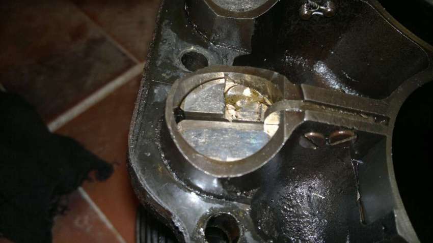

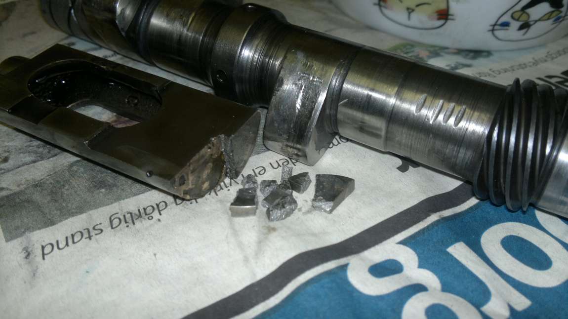

Hi Mac I had a similar so…
Hi Mac
I had a similar sound experience. It turned out to be a broken cam follower. Valve clearence didn't change. Remove magnetic plug and sump filter and check for "Shrapnel".
Regards Leif

Hi Leif
Been there already, with no sign of any metal paricles, what was the cam lobe like after that?
