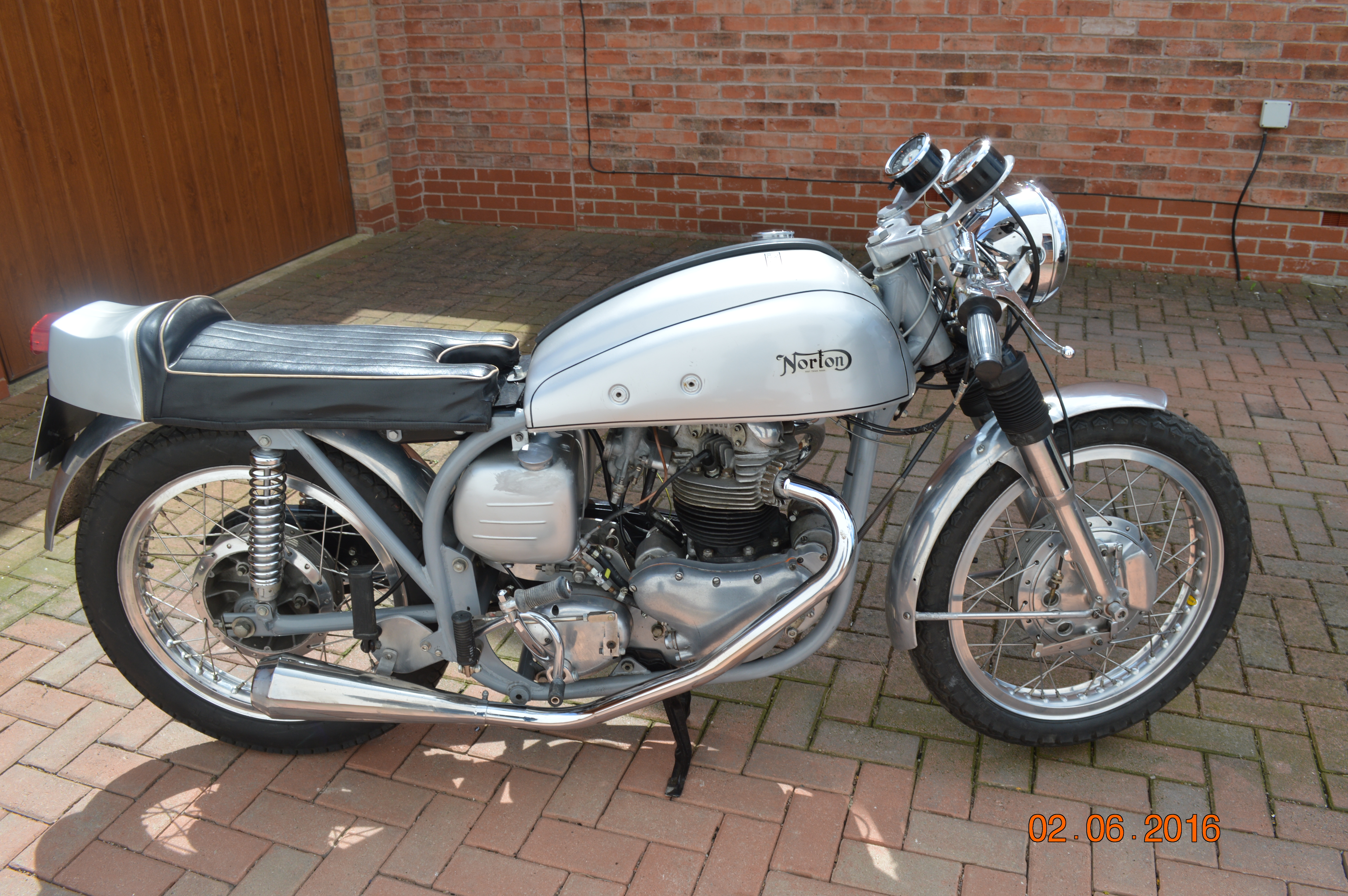

I have been trying to source replacement tank knee rubbers for my1962 wideline 500 twin.
They are the two hole variety and the distance between centres is 105mm.
RGM do them but with 4.5" centres, too big.
Can anyone point me to a place where I might get them?
I have enclosed a pic to help identify them.

Mel, the tank you show in…
Mel, the tank you show in your photograph is a widline tank that goes with a wideline frame, this style of tank/frame was discontinued in 1960, ok so I have owned several dominators over the years and they all had adhesive knee rubber pads, the holes you see in your photo are intended to fix the chrome panels as fitted from 1956.the front fixing arrangement was taken care of by two 3ba screws that also held the round plastic Norton badge.it would seem that these holes have been filled and painted over, you could get some adhesive knee pads and position them over the holes as would have been the case if you had the chromium panels, watch what adhesive you use though,it might react with the paint on your tank,depending on what type of paint is on the tank.

Thanks for the detailed info which is very interesting, I can't find any evidence of filled in holes but I will have a closer look with a magnifying glass. The bike was first registered 1963 but built from older parts, the frame number is 18-103814 and engine number 61023 K 122, which I was given to believe is 1956 engine and '62 frame.
The engine is of the downdraught variety and has twin carbs.
If it should have chromium panels, then I would prefer to source them than use stick on pads.

Mel. 18 103814 is a 1962 6…
Mel. 18 103814 is a 1962 650 frame. They were all of course slimline frames. However, you say yours is a wideline? The engine number indicates a 1955 500. It looks a though it is fitted with twin downdraught carburettors, from the limited view one has from the photograph.
You haven't got the numbers for frame and engine the wrong way round, have you?

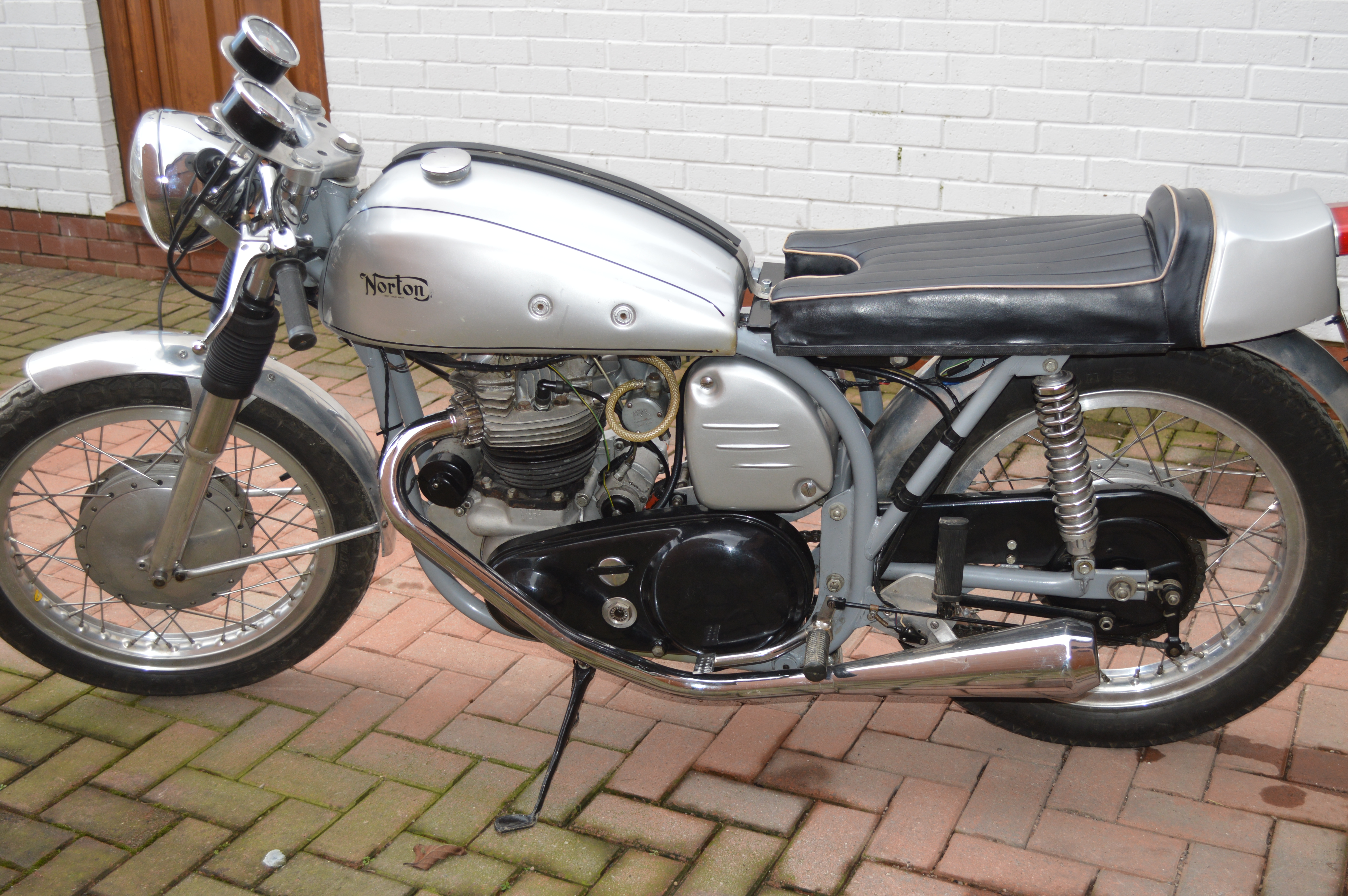

I'm taking the numbers from the log book but I will double check them tomorrow, it was described as slimline when I bought it but the chap that did the rebuild, Paul White, ex Norton TT rider says it is a widelinewith Roadholder forks. I've enclosed a couple of pics that may help show it better.

Yep - I had a "K 122", whi…
Yep - I had a "K 122", which is of course a 1955 Model 88 500 twin. The tank you have is from a later model which had screwed-on chrome tank panels. The good news is that these are being made today - Fred Williams usually has some. The bad news is that they cost a fortune! I think they are still listed in the NOC's spares but I can't access that whilst I'm writing this.
The 1955 tank was chrome-plated with a painted teardrop design and screwed-on tank badges (also still available for a mere fortune!) It's these tank badges which use 3BA screws and the holes will often be filled with paint if not used. The chrome tank panels needs stick-on rubber knee-grip panels to cover the screws. It looks much better that way!
This is a "Bitsa" with a Wideline tank on a slimline frame, although it's difficult to see the exact shape of the frame from your profile pics. If you post any more pics I'm sure the webmaster would appreciate smaller file sizes. 9.5MB and 6.4MB is MASSIVE! Just resize the photos on your software to around 2MB or less. It makes them much easier to email too.
The frame and swing-arm lo…
The frame and swing-arm look very much like my 1955 dominator. Regards Neil.
Never mind the numbers, th…
Never mind the numbers, the photos show a wideline!
In the pictures, I see a subframe with straight tubes, a wide tank which fits neatly on the frame rails at the rear, rear forks with pull-back wheel adjusters (pre-'57, I think), pillion footrest mounts as a small flat lug on the main frame rails, not a sheet metal plate.
so it's a wideline bitsa with a later downdraft head, and perhaps a non correct frame number
Paul
