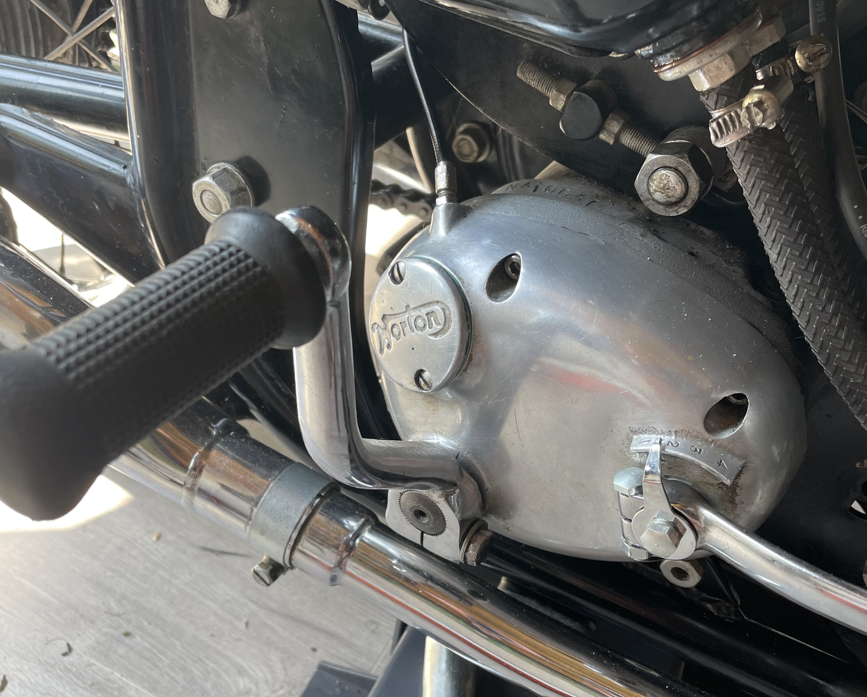

Help! I'm slowly recommissioning a 650ss which seems to have been cobbled together from the parts bin somewhat over the past 60 odd years. I'm also battling my lack of experience with Norton's this being my first restoration of a Dommie.
My issue at the moment is a very stiff and erratic kick start action.
  • the clutch frees off the kickstart nicely when the lever is pulled
  • with clutch engaged kicking the engine over the action is v stiff
  • the action feels different at times or not the same stroke to stroke
  • Occasionally the swing will disengage(?) drop and clunk when being kicked
  • There is a very small amount of end float on the k/s spline
My last kickstart bike was a T140 and that was much lighter than this to kick over. Any thoughts or tips gratefully received.
