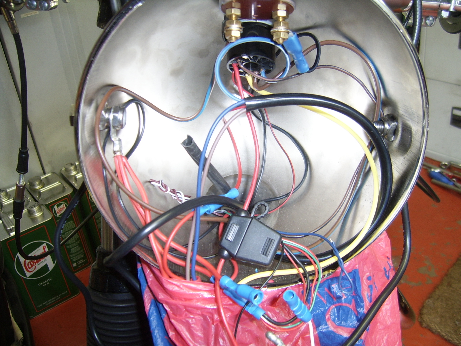

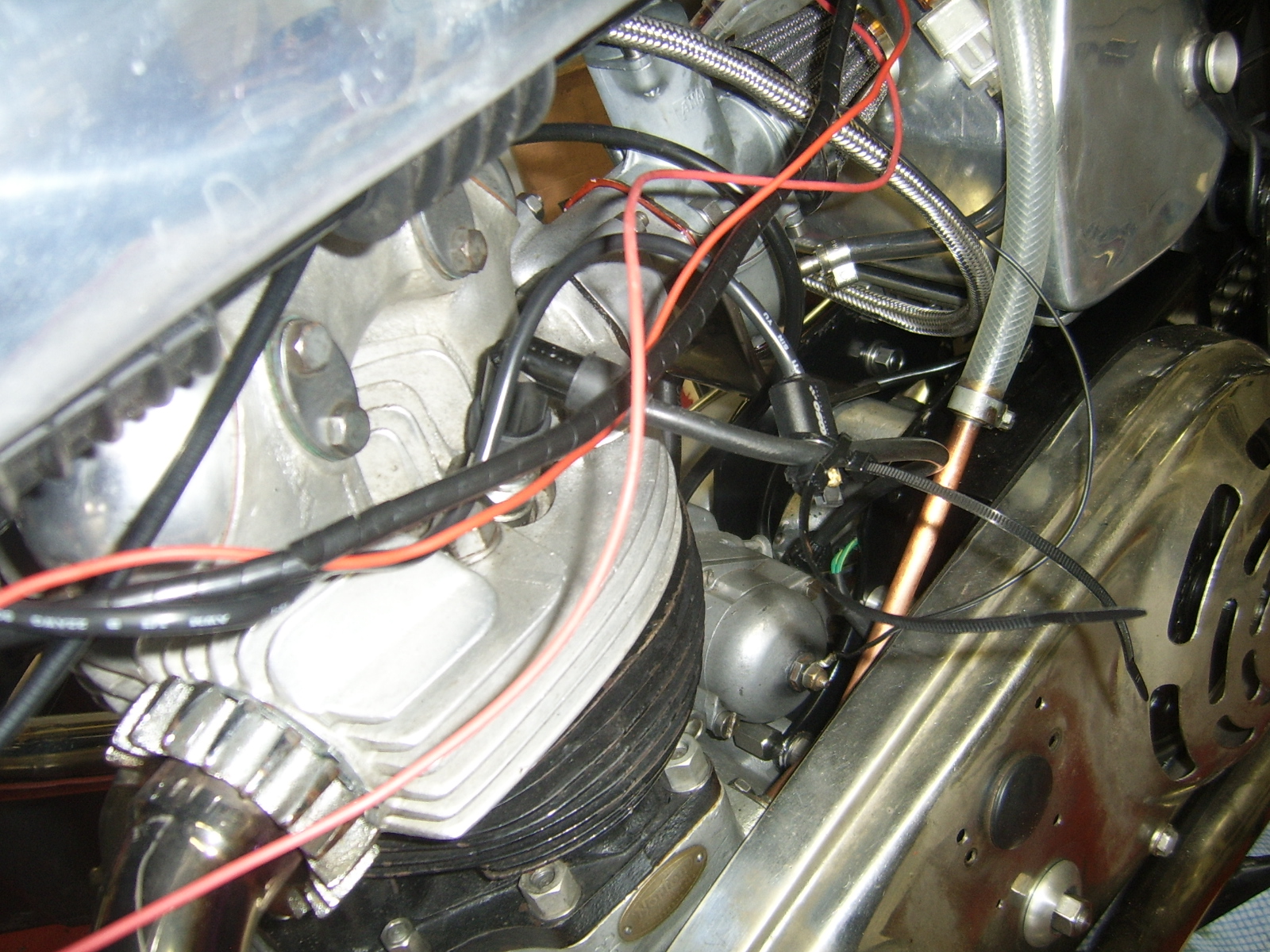

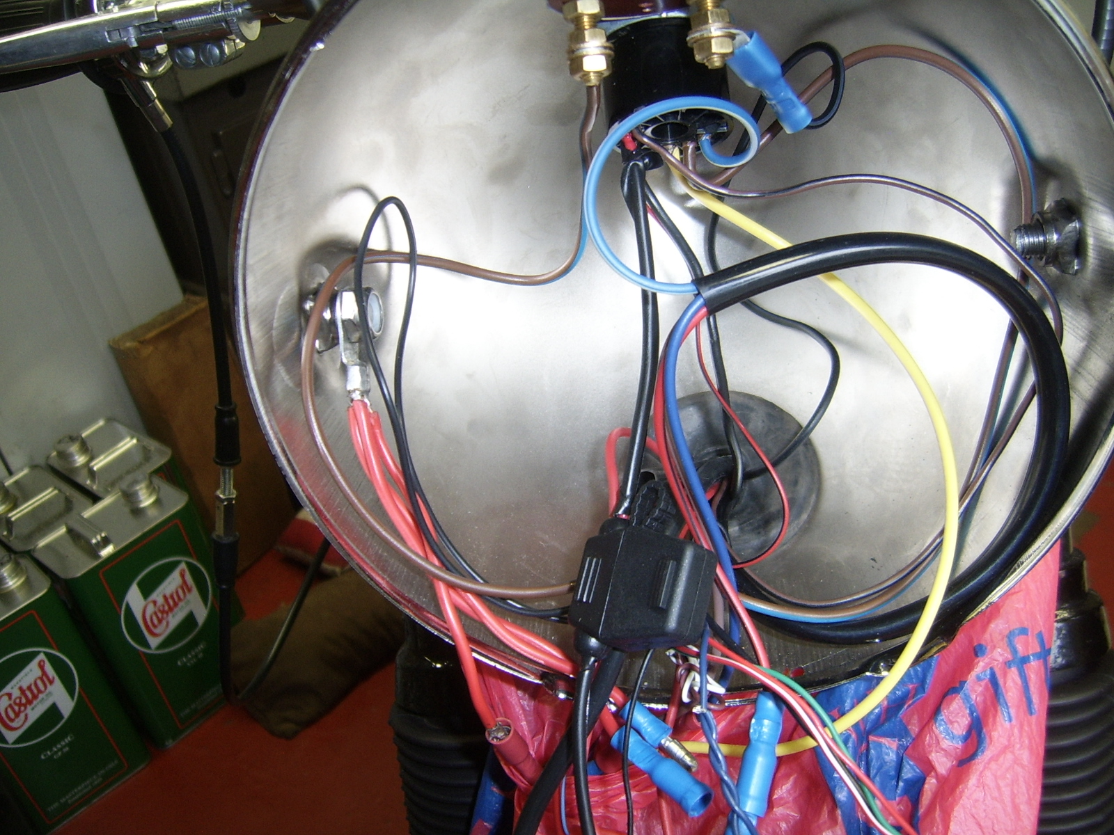

John H's resistor idea is certainly worth thinking about. Pictures below.
Inside the headlamp  (Resistor?)
Wiring under the tank before tidying it up.
Finally the almost finished machine !

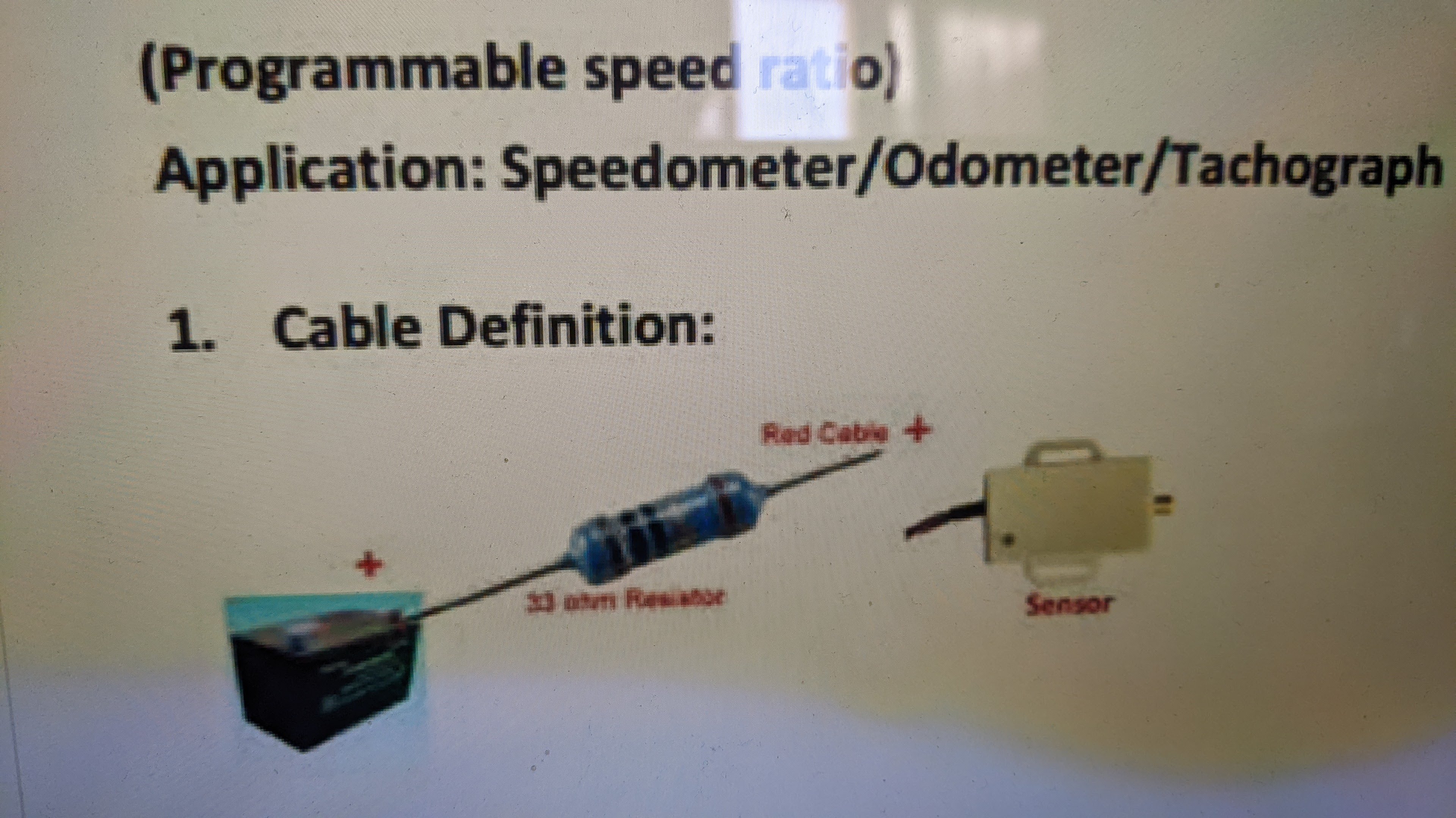

33 ohms was the resistor specified for my GPS sensor, which is odd considering its stated input voltage tolerance of 6 to 32V.
Resistor
Cheers John.
First thing is to find a 33 ohms resistor
Then connect to the red cable to the battery, I assume inside the headlamp,
This must also include the sensor.
