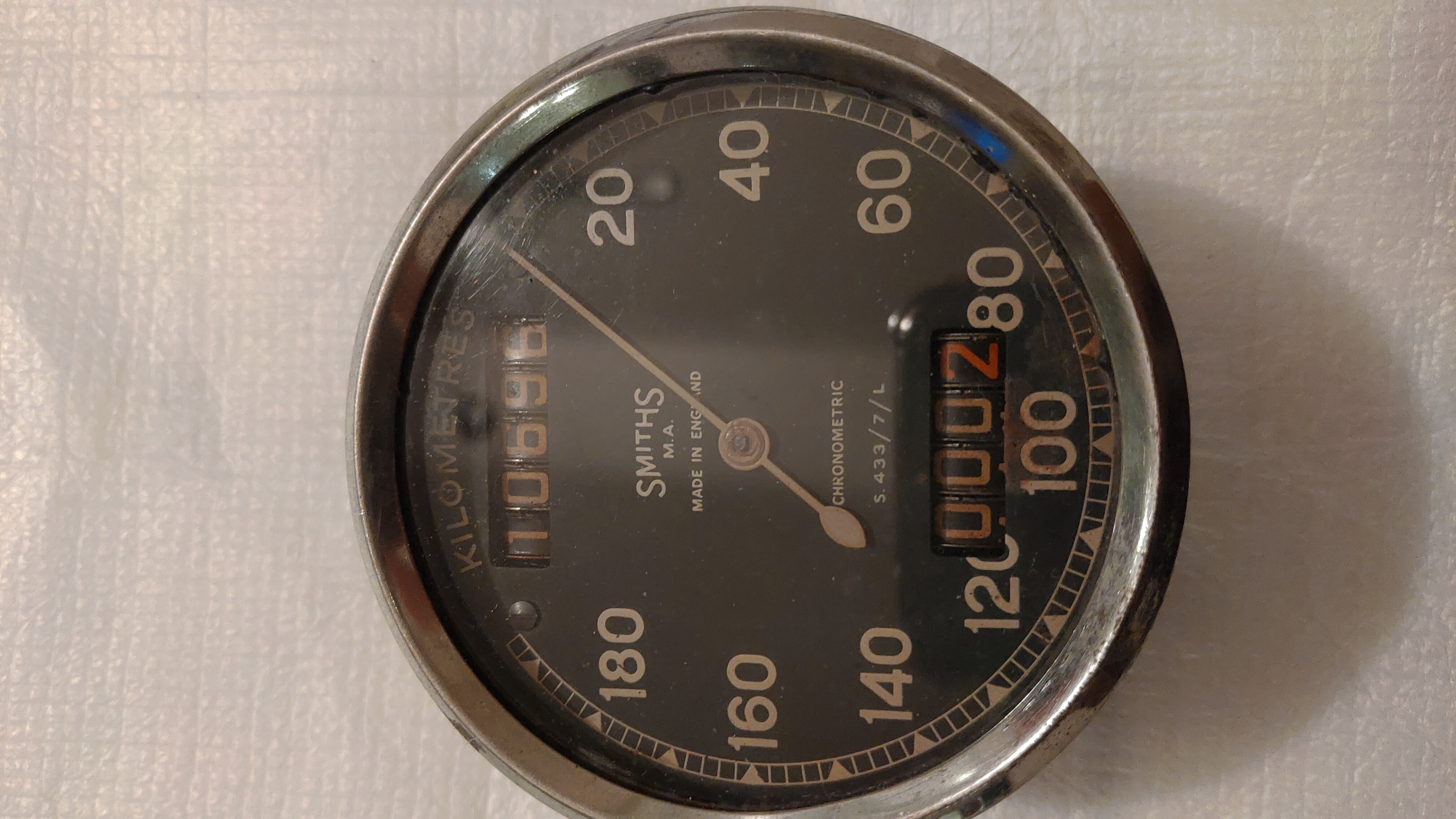

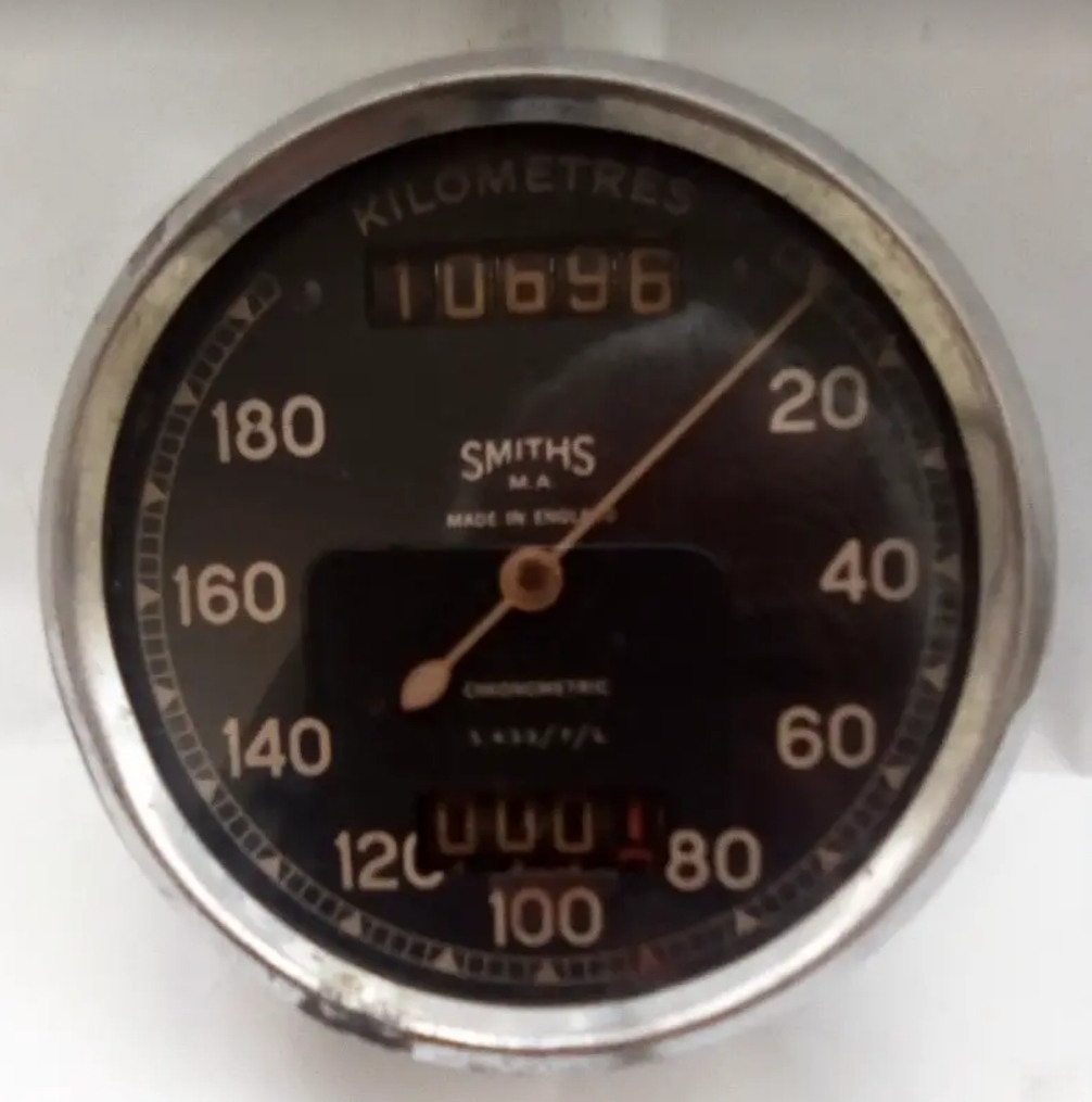

@Holger: the speedometer…
@Holger: the speedometer dont have any additional numbers below the dial, I attach a picture to explain
@Paul: thanks to highlight the possible strange behaviour may happen.
Still remain my curiosity to understand the Smiths codes. I dont know if any Smiths service expert read my post...
At this point I found, after the speedo code itself, the number may be from 1 (80 mph), 3 (120 mph) or 5 (140 khm), 7 (180 khm).
@Howard: maybe you are right. As I was not sure which code identify the trip reset lateral or vertical.

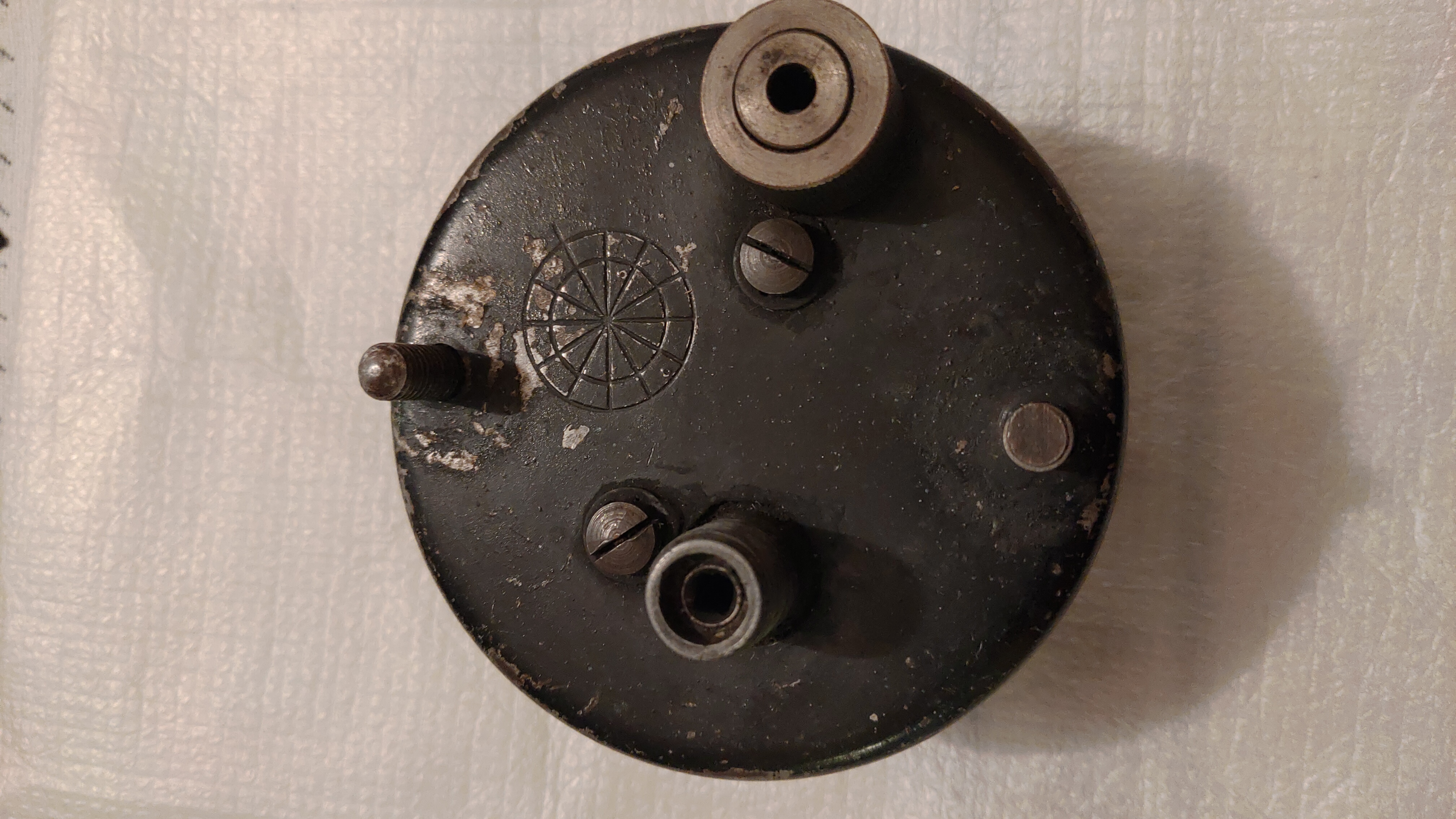

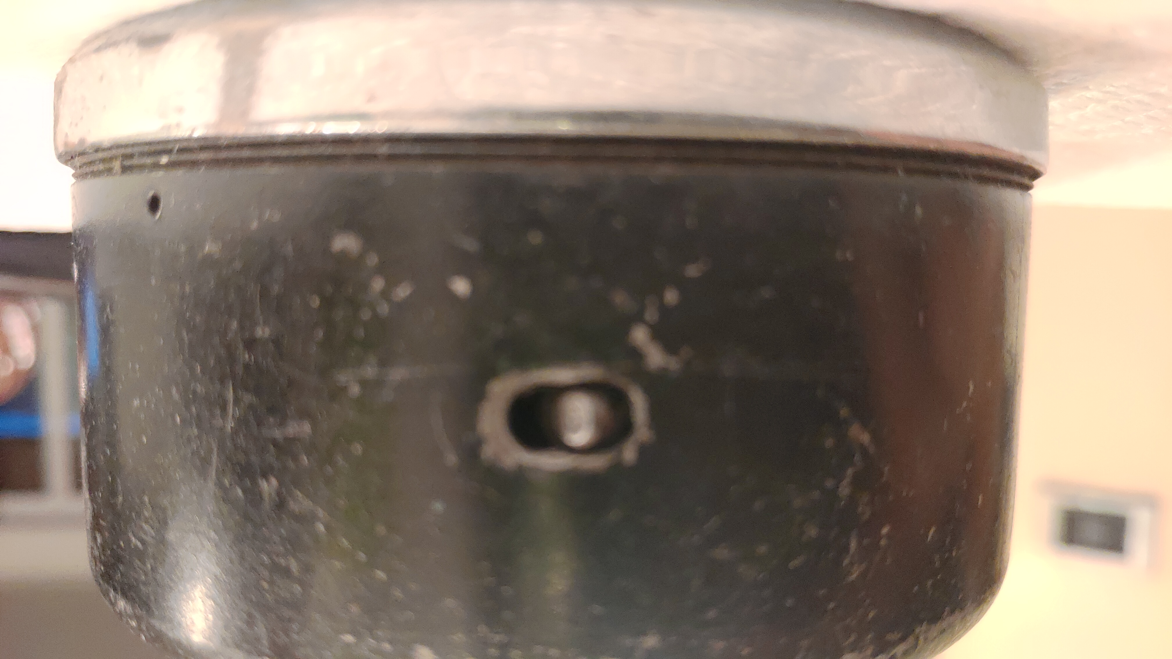

Finally I have the…
Finally I have the speedometer in the hands, I post the pictures and I have a couple of questions on the layout on the back of the instrument.
There are two screws to fix, one for odometer cable, and the others?
Speedo fittings.
On the underside there are the fittings for the speedo cable and for the globe assembly to illuminate the dial. Undo the knurled nut to fit the connecting wiring cable.
The side pin is to fit the missing trip meter reset knob
