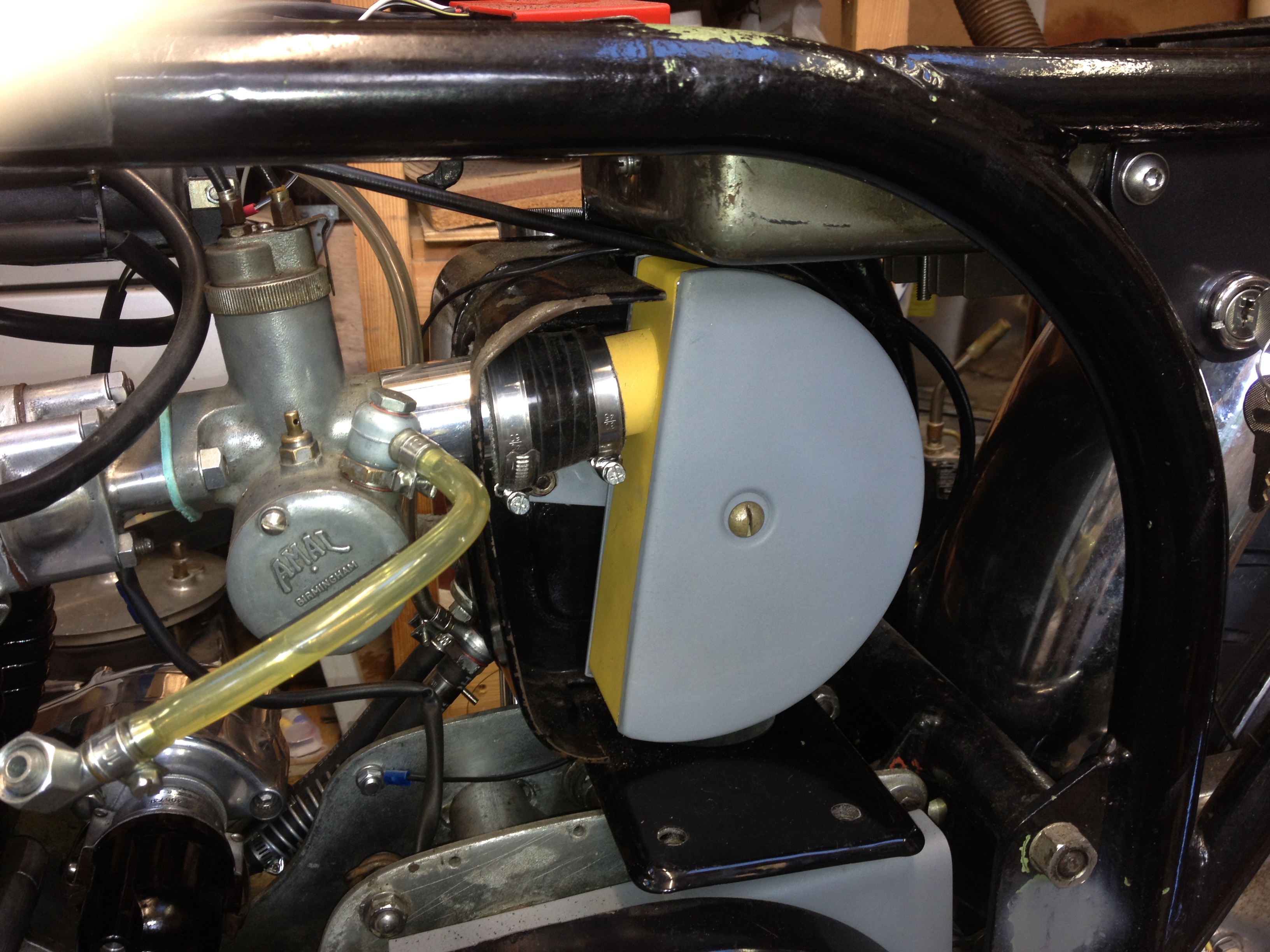

The threaded holes have been there at least  since the start of the slimline. They are the mounting points for the box filter back plate. I have one on my 60 99  It was produced by Les Emerys co and is a copy of the one Norton made. It works with a single carb. and connects to a carb ring with a short concertina hose. onto a stub outlet from the filter box. The filter element is not purpose made but can be fabricated from half an Austin Mini one. The battery box has to be removed to get at it. A bit clumsy but better than nothing.Next time I take my battery out I will take a photo. Who Knows by then I may have learnt how to post one.

I fitted an air filter to my 59 - 99, I believe it's called the 'Vokes' type and used an Austin Mini filter cut in half as the element.
It works great and gives me peace of mind being on a plus 60 bore.  And yes, you have to remove the battery box to get at the filter, but I made that relatively simple by using some quality wiring connectors.

Hi Bob Matthews, Yours is much simpler and easier to fit than mine!. A different design.Mine is the size of the oil tank  and not the better for it. Yours is Vokes type.. May not fit my bike which has the earlier non DD head I think.
