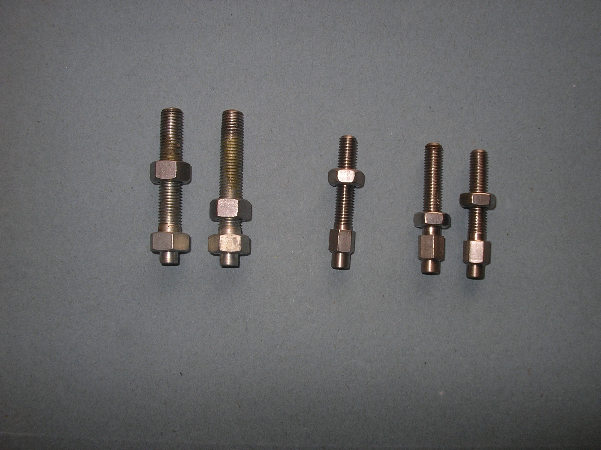

All of the Featherbed Frames (Wideline & Slimline) from 1955 onwards, used the same 1/4" Cycle thread wheel position adjusters.  Including the Mercury which was produced alongside the Commando.  The Commando used a good many UNF threads and this included 5/16" UNF thread wheel position adjusters.  See photo below......

Adjusters
Robert - A word of warning. Dommie adjusters have a reduced hex for the head of the bolt that rests against the spindle bolt and nut.  The reduced hex stops the adjuster fouling on the swinging arm.  Usually the Commando ones do not have a reduced hex because there is more room. So you will need to reduce the hexagon on the Commando adjuster to make the repair,  The 5/16 inch unf thread form will have a nut spanner size of 1/2 inch AF and this will foul the Dommie s/a.  1/4 unf is 28 tpi.  Good luck, Howard

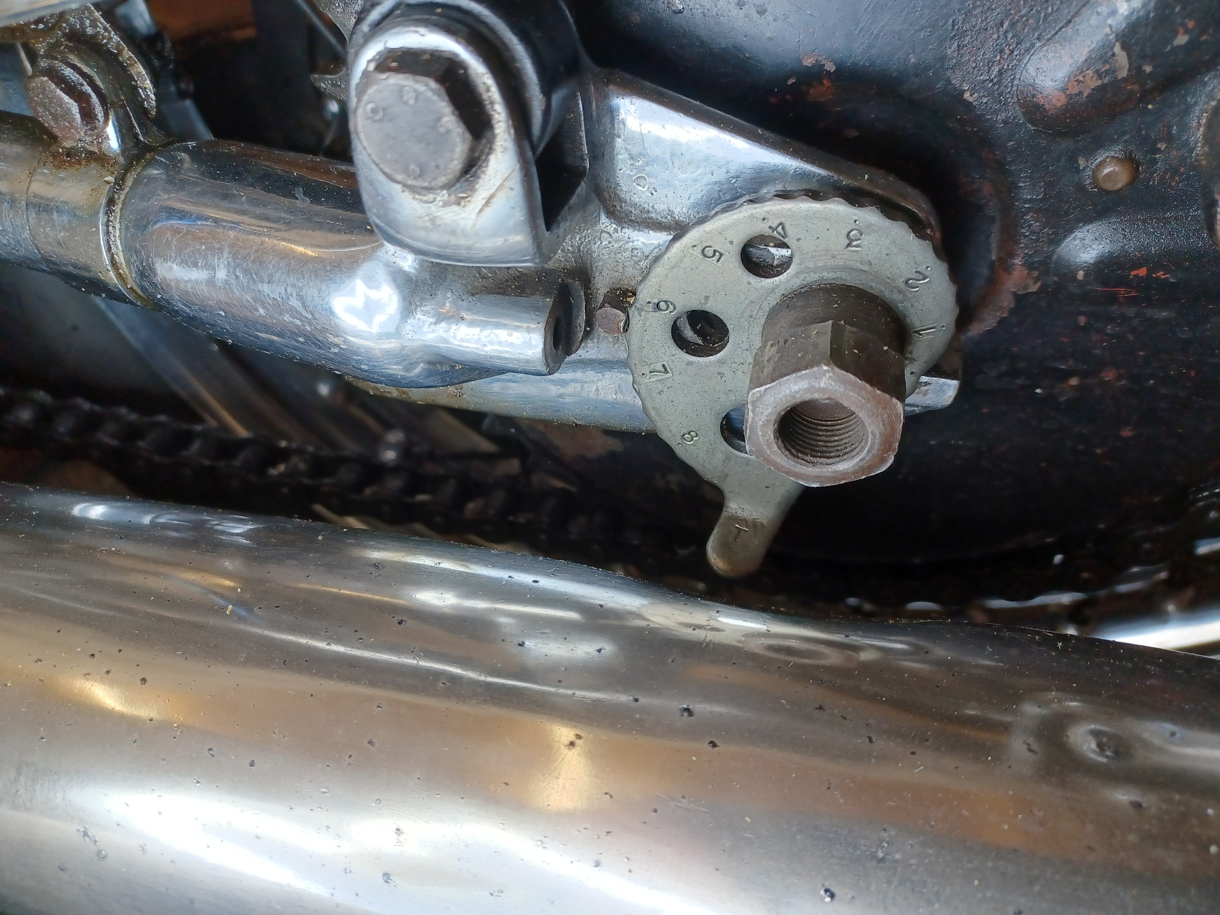

Another way to fix the problem. Improving the situation but ignoring originality is to fit snail cams.
The snail fits on the rear axle very easy. The only issue is fitting a high tensile screw into the swinging arm as a stop. Its position is very crucial. But subsequent rear wheel adjustment becomes a doddle and the original issue of bent bolt adjusters is gone.

Snail cam adjuster as fitted to my Dommi in 1978, still working well.
This is a 1970s Yamaha part although Royal Enfield made similar ones, so much easier to adjust chain,  but, as Al said, they do need to be accurate.  My left adjuster is one notch ahead of the right hand adjuster.

The Snail cam looks surprisingly doable,  however the orriginality freaks would not be happy. I have several Recoil kits , but they would pose a few more issues with the access being so awkward. As I have done this job before (  in a different century!)  ,I must still have the necessary bits ( if not the energy) to do it again with the thicker 5/16  adjusters  that will be stronger and not really notice as non standard .
The Manx has different adjusters than other featherbed frames. Pulling backwards.
Could it be possible to make something similar?
