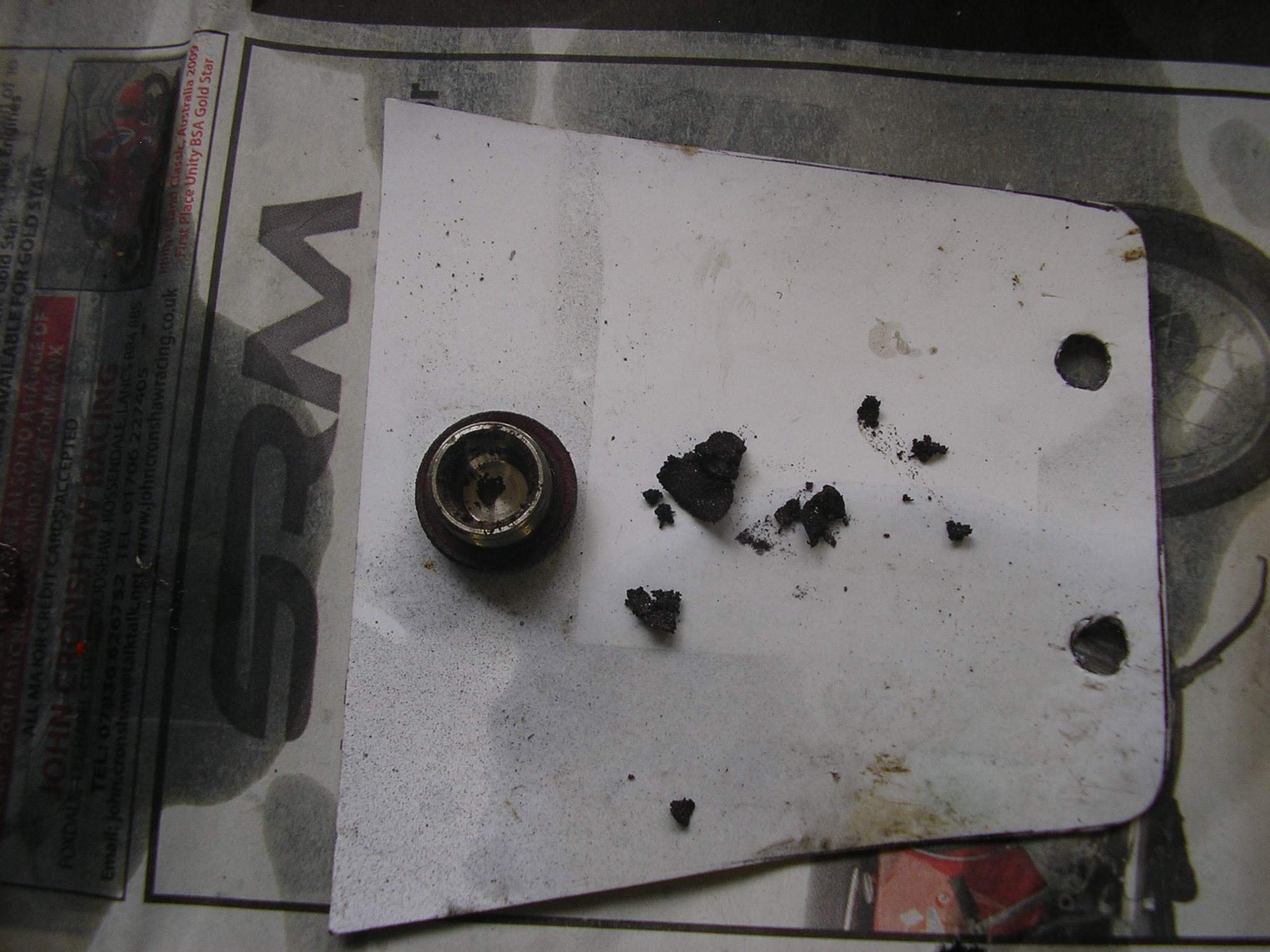

I have covered over 10,000 miles with this Concentric carb and noted several issues right from the beginning.
1)  When the carb was new the engine needed full choke to start and catch plus even after several  minutes of warming up needed some choke to pull away.  That lasted about 3 months.
2) I have three separate filters in my fuel line but the float bowl fills up with black gunge every 1000 miles. If I don't clean it out then the main jet gets blocked. I suspect it is coming from the anodised slide.
3)  My pilot screw is 1 3/4 to 2 turns out. It is really difficult to get an even tickover.  My Wassell was much better at giving a smooth tickover plus 60+ mpg.
Photo below shows carb rubbish.  Note the amount!
Yikes
That's alarming to hear and to see that amount of gunk.

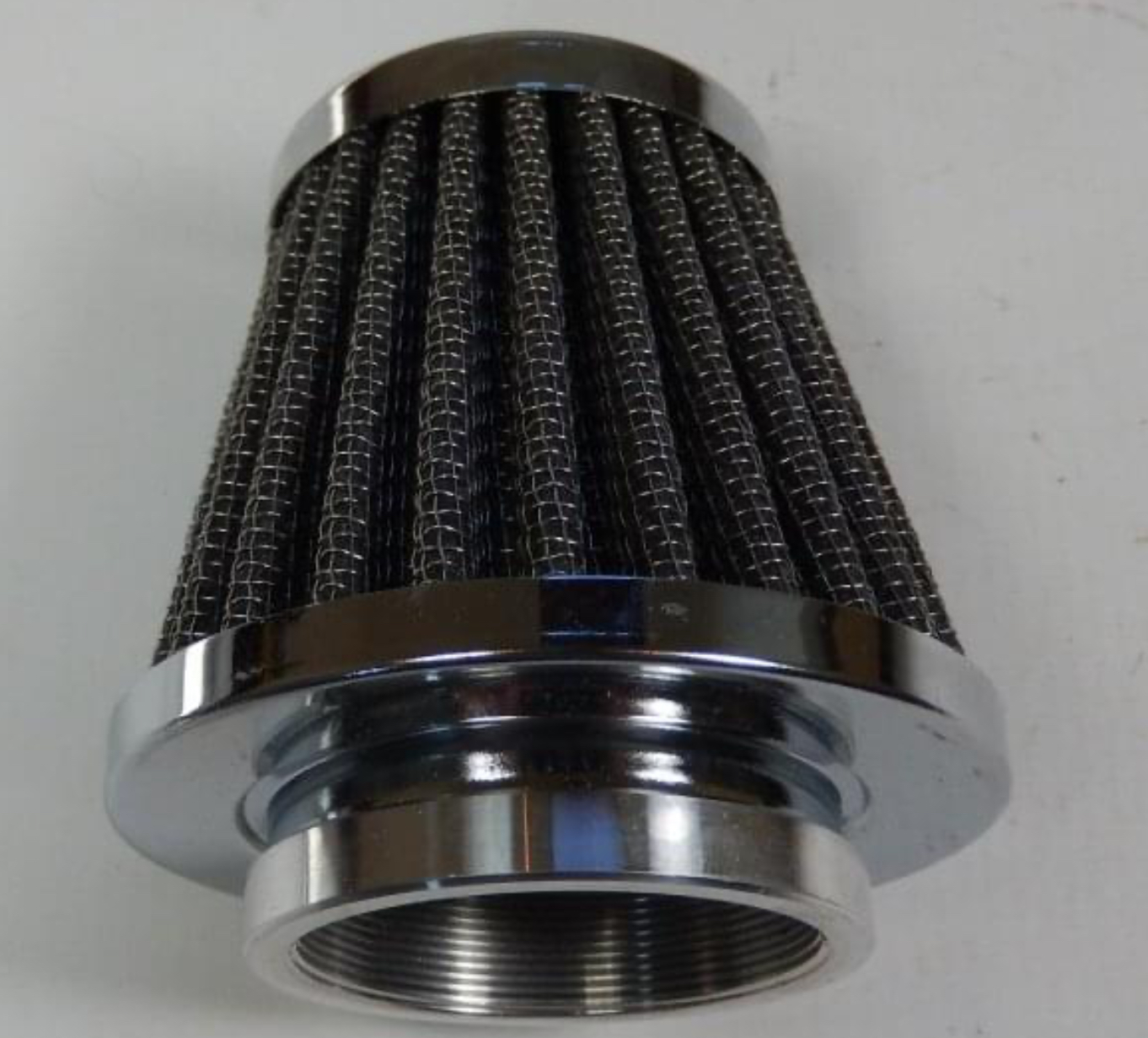

I'll also try a 270 jet as I…
I'll also try a 270 jet as I have a 280 at the moment and a wire air filter - this might help with the current richness even though the needle is on the lowest setting. Every day is a school day!
One of these - an Amal…
One of these - an Amal threaded cone filter for the 600 series.

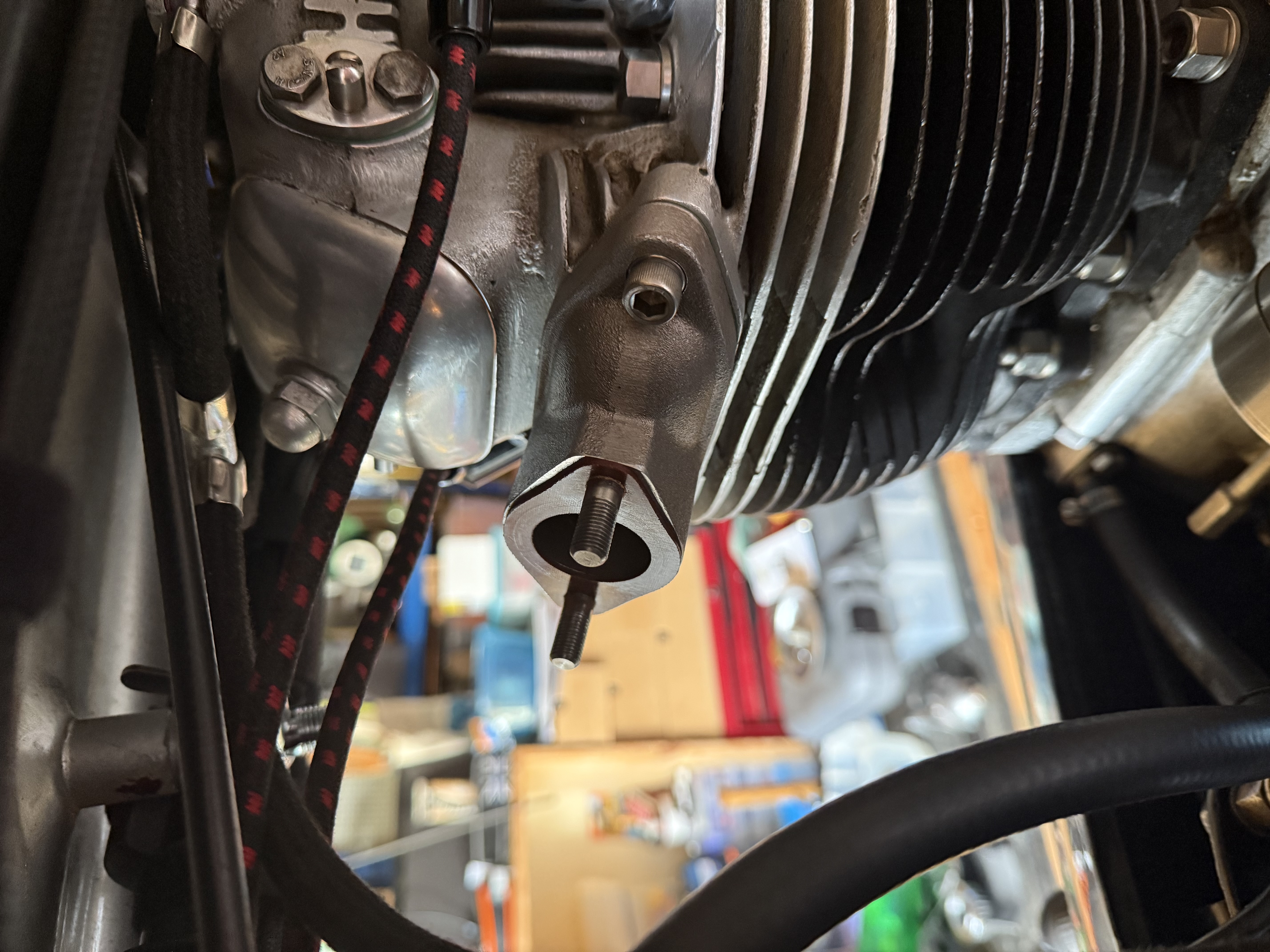

15 degrees of tilt?
Just a thought as I wait for the gaskets to arrive - could the 15 degrees downward angle of the 650ss head be causing issues for the carb float? The manifold is a straight item and so the carb is leaning forwards at 15 degrees.
Obviously the carb is not horizontal across the axis of the float bowl, so could that degree of lean cause the float to be open and for the bike to run rich?
I'm pretty clear that the bike is not running lean as both the spark plugs are wet and black.
My old Atlas
I can't see the angle of tilt being an issue. My old Atlas had the standard downdraught head, and the 2 monoblocs were fitted with straight spacers, thus the downdraught was not affected.
 Otherwise why did Norton bother developing a downdraught head....
I don't know which single…
I don't know which single carb manifold that you're using on your 650SS head but it doesn't sound like any of the ones that I have used. The ones I have used bring the carb back to an almost horizontal plane. I once saw a Commando manifold used on a Mercury and the carb was uphill but it ran fine. The carb on my Mercury was almost horizontal . It would be possible to mount one such manifold upside down but the carb would be very steep downhill (ie > 25 deg). I did have twin Concentrics on a late 650SS and they were mounted on the parallel alloy spacers (with balance unions) - so they were pointing down at 15 degrees, as you point out, and they were designed to run like that from the factory. Good luck, Howard
Happy Days
I got the manifold from Norvil and so far as I recall there was no option to purchase one with a 15 degree bend!
I'm going to have to go back and see if I missed a trick but I'm starting to wonder if this might be an issue. That lean might throw the float out enough to make it run rich.
For what it's worth....
... the carb on the Electra is similarly tilted down towards the cylinder head. I had a single carb manifold on the Commando and I'm almost sure that was straight, meabing the carb was tilted as well.
I actually think the Concentric is better than the monobloc in this respect as it also doesn't mind side to side tilt.

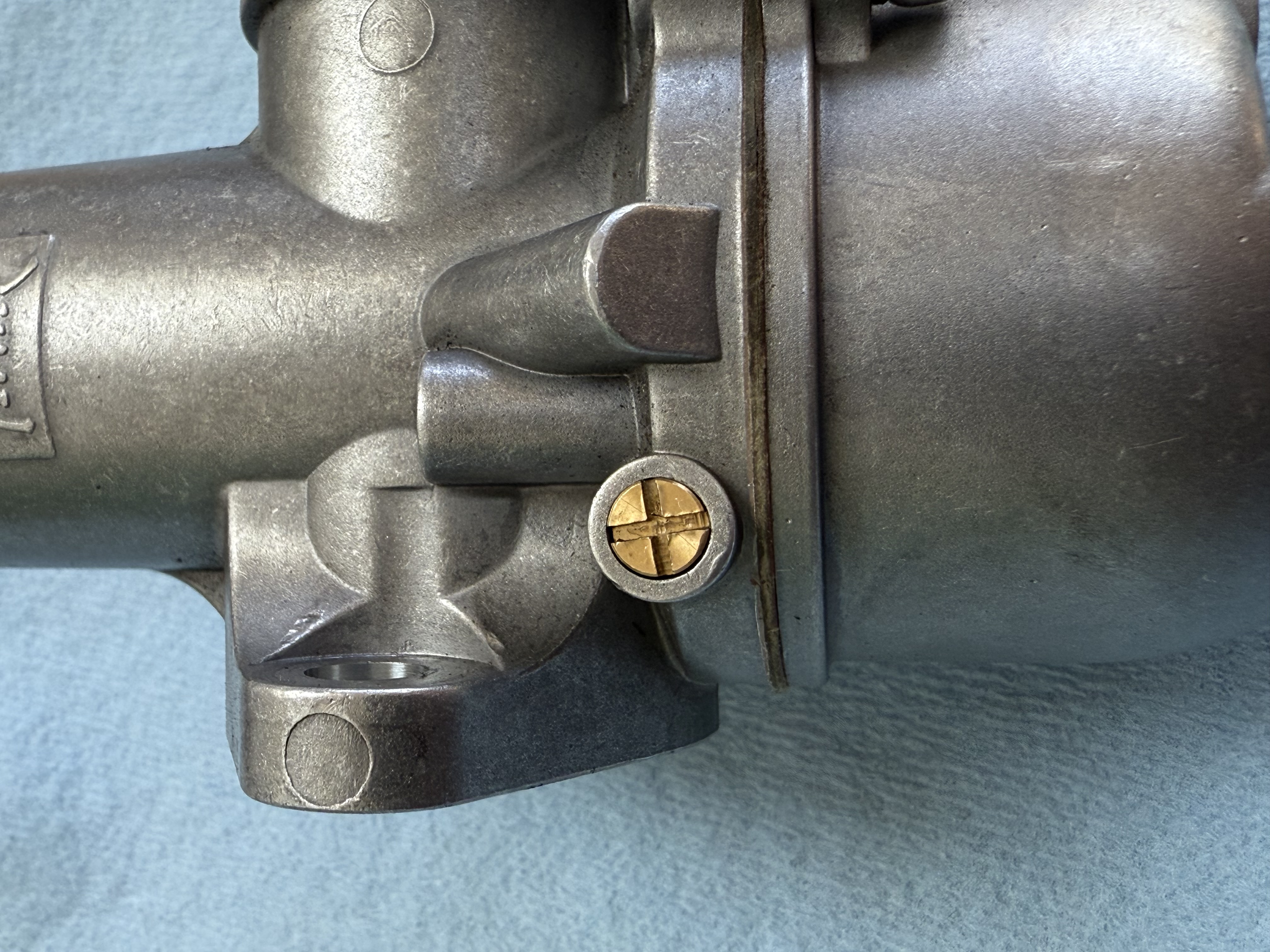

Are you quite sure you are running with the choke off - i.e. lever fully back? I have known a couple of riders caught out by this, one very recently.
brass screw
That one you pictured is an ACCESS screw to the pilot jet circuit, so is kept fully screwed in. ( I recently temporarily removed the one on my single carbed Commando 850 MK3, to enable pilot circuit cleaning, for which I had purchased a set of varying cleaning wires and miniature bottle brushes, which worked very well.)
   The 650SS was sold with twin downdraught carbs at same angle as yours, and I have never heard of a problem with those.

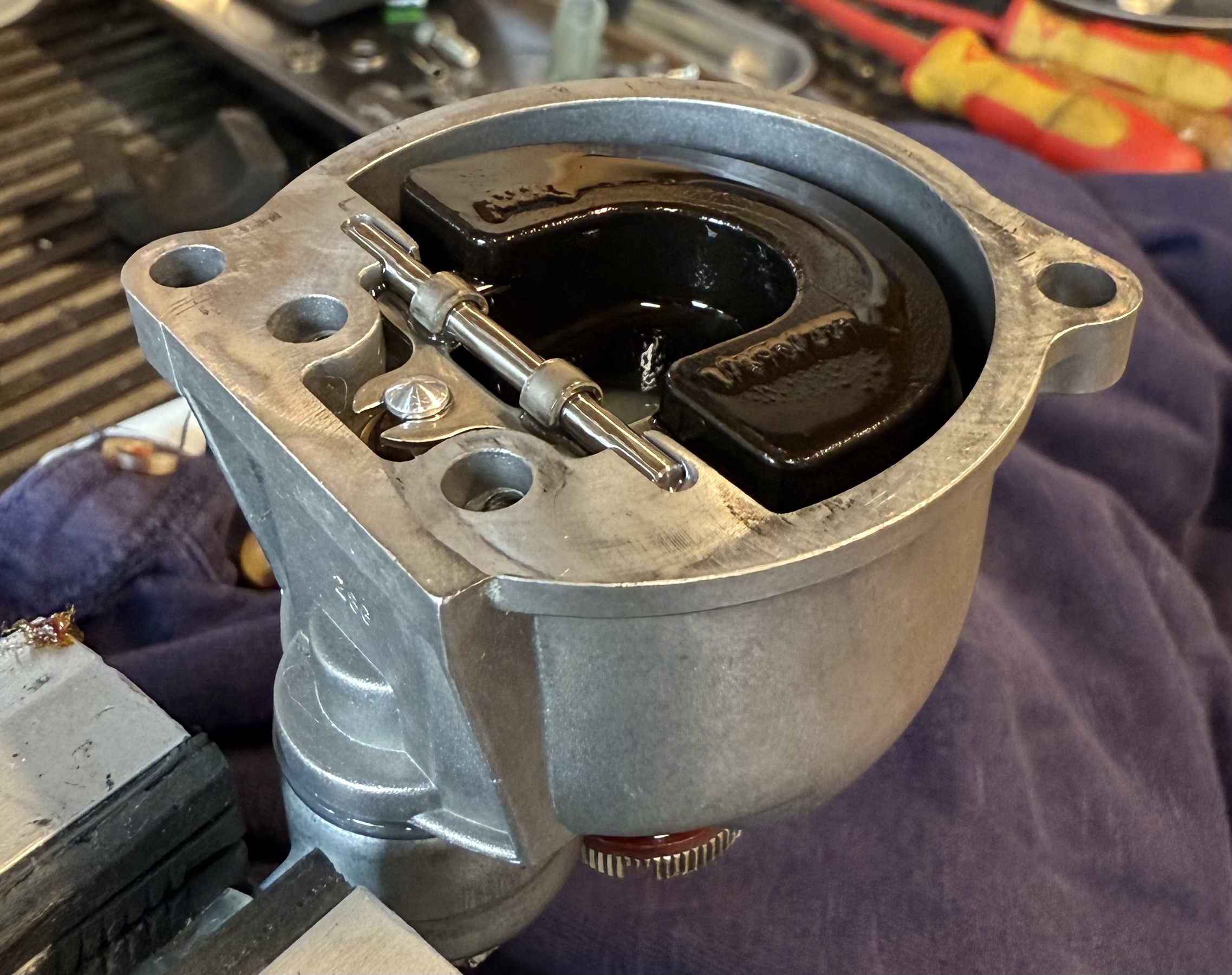

I did check that the float (a new stay up float) was at the correct height as per the Amal Technical data from their website. I did this by eye and even with the bowl tilted forward 15 degrees this didn't seem to be an issue.
The correct fuel level for all Mark 1 Concentric carburetters is 0.21" plus or minus 0.040" below the top edge of the float bowl. Thus when the needle valve is being held shut by the tangs of the float, the level of the fuel will be between 0.17" to 0.24" (4.33mm to 6.35mm) from the top of the bowl.
If this persists then I'll try with the bowl off the carb and using fuel to test as suggested. What fun!

"That's not 1/4" below top…
"That's not 1/4" below top of float bowl!"
See how easy it is to check.
Updates
Ok - the float does what it should and when it should when at 90 degrees to horizontal. (See pic 1) with just under 5 mm of gap.
When tilted forwards at 15 degrees (see previous comments) to mimic the position on the bike, petrol does spill over the edge of the bowl for a while before the float kicks in. The additional angle of lean does bring the float higher and halves the gap to about 2.5 mm. I'm thinking it might be sensible to adjust the tangs (as described in the Amal tech notes) to prevent this overflow. Any thoughts?
As the carb was off the bike I took an opportunity to blow through all the pilot tubes with compressed air. All good and clean. Pilot jet is well seated.
