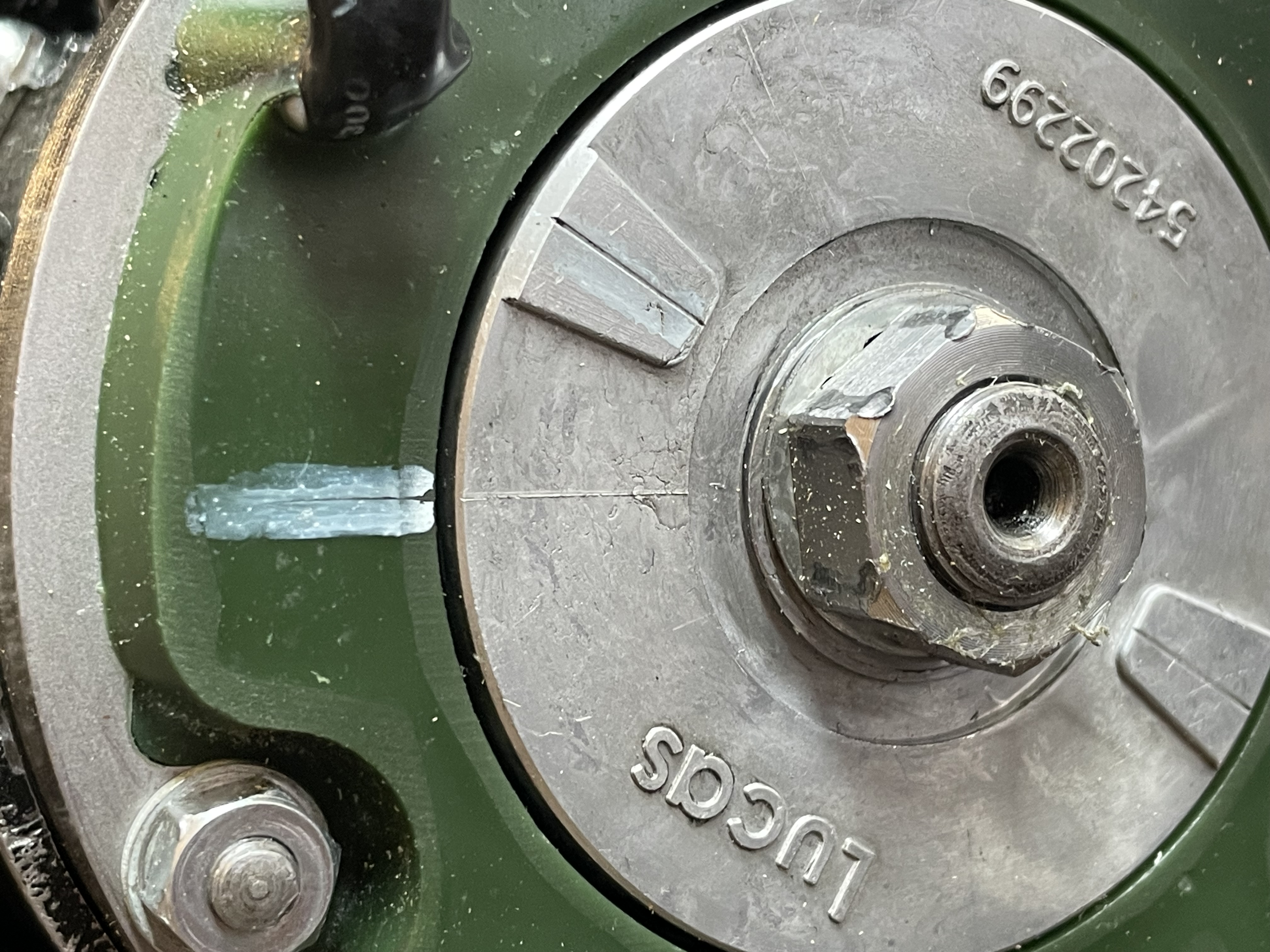

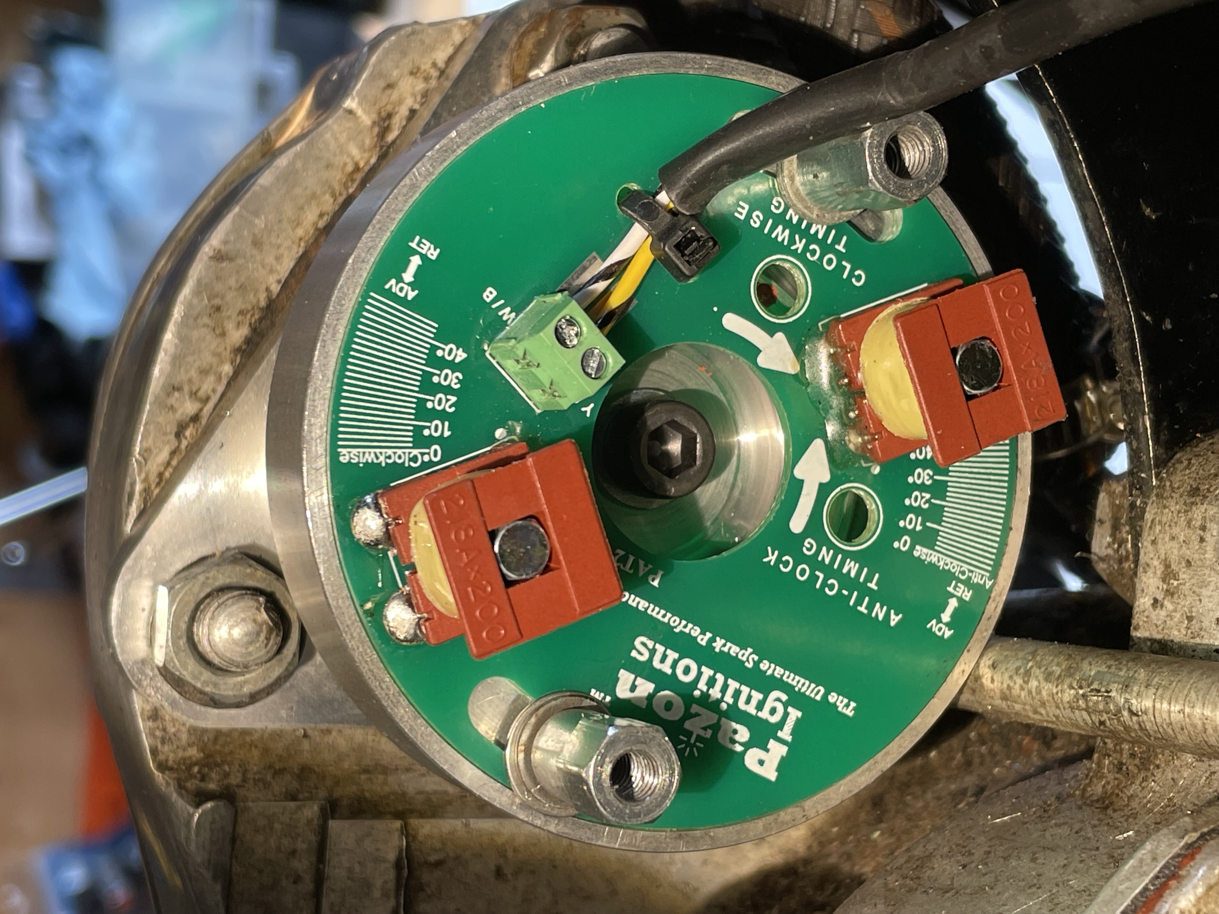

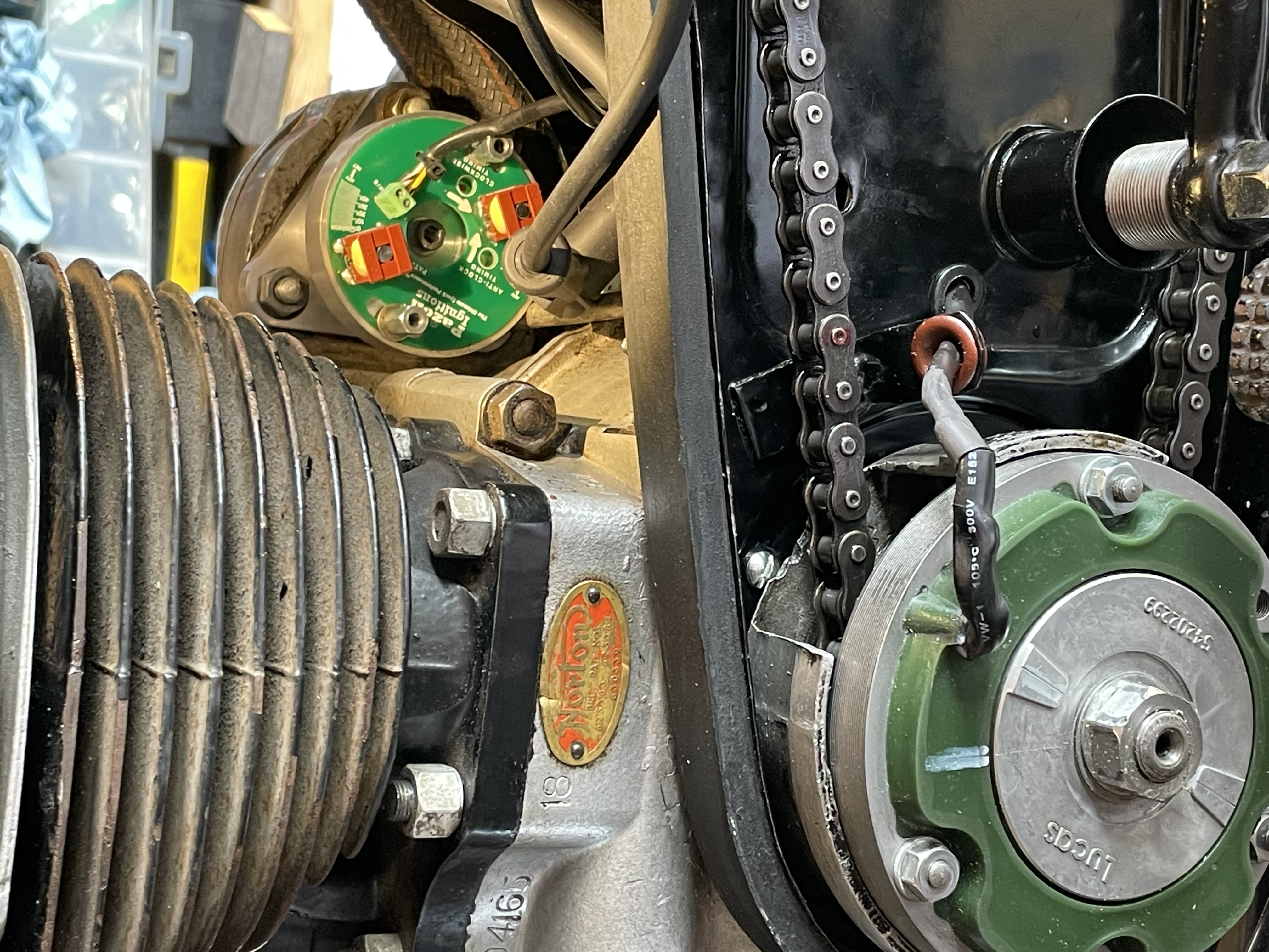

Photos attached to show the rotor with marks at 32 BTDC and the Pazon unit with orange button where it should be.

Think it on the wrong clock. Although the engine runs clockwise,the ignition runs anti clock due to the timing gears .
The rotor behind the plate turns clockwise and the manual says clockwise for an Atlas so I assumed…….

Wasted spark means that both ignition coils fire at the same time, most likely 2 off 6V coils in series running on 12V.. Both ignition coils firing at the same time means there is no longer any left/right with ignition. But be aware that the ignition point you set on the Boyer Bransden, Pazon, and others and Lucas RITA is for the firing point to be in front of the pickup coil, bear in mind the direction of rotation. So ignition timing point is in front of the coil. Ie anti or clock is not relevant as long as the rotating bit is in FRONT of the coil.
Thanks Alan that makes sense. So as long as the spark is delivered on the compression phase and before TDC - in this case 34 degrees (as a start point) then we should be good.
'So as long as the spark is delivered on the compression phase and before' yes but this is nothing to do with the 'orange' button on the Pazon being 'in front' of the pickup. This being in front gives you the advance curve and is the trigger point for the ignition.
Now the white mark on the stator? What does this mean?

I imagine the 'white mark' referred to is to accentuate the 32 degree BTDC position (easier to see with a strobe light). It might be worth doing the same to the mark on the alternator rotor as it all helps to make things more visible when adjusting the timing (try and keep the line/marking narrow to reduce any errors).

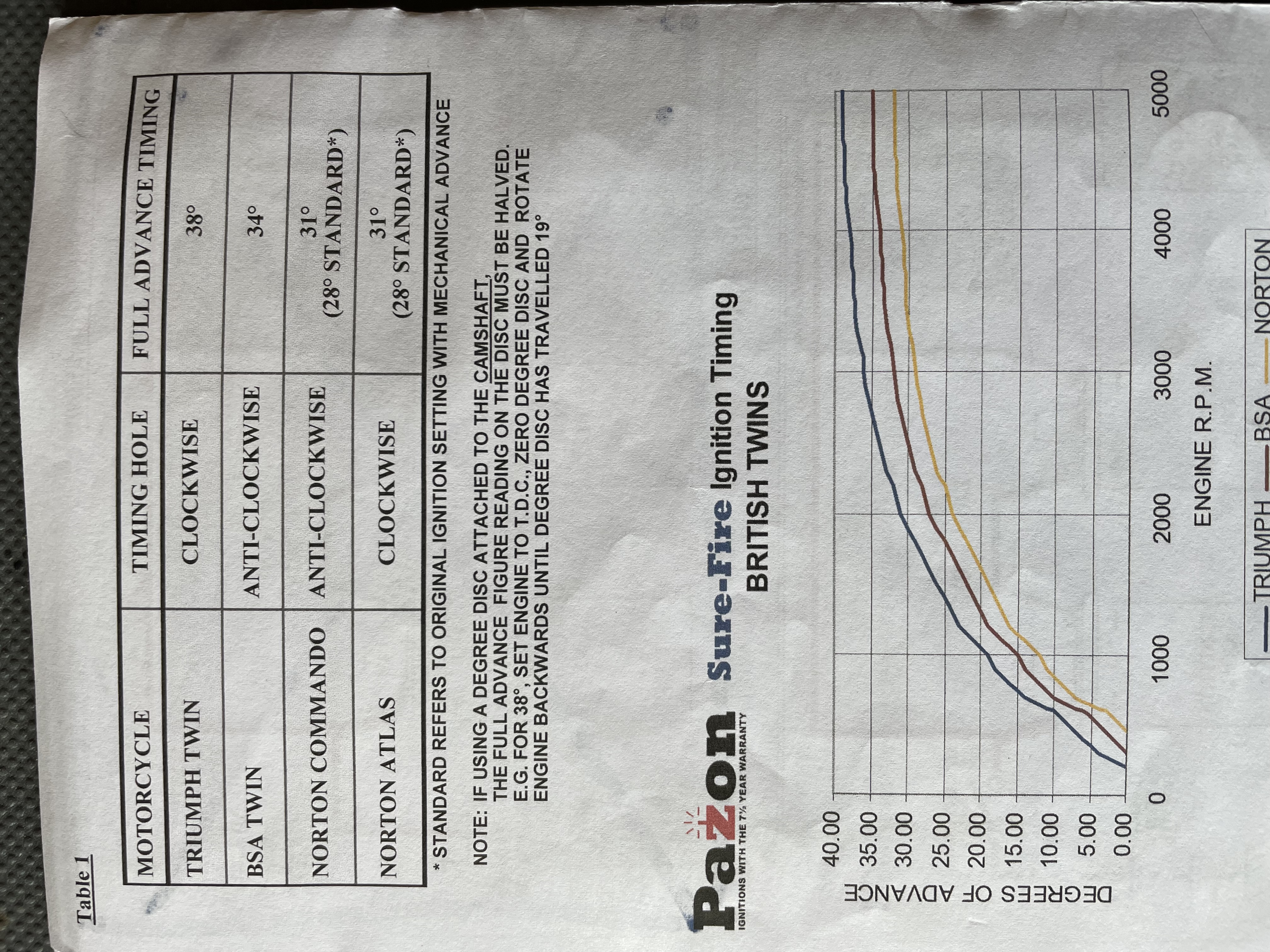

The Pazon manual states Atlas is a clockwise timing. See attached.
Ok this is a 650ss but in effect it’s the same. Right?

Lots of comments stating that pre-timing cover ignition - i.e. any engine with magneto or points behind the cylinders - rotated anti-clockwise. Yea, when viewed from the timing cover side, the sprocket does rotate anti-clockwise. But when viewing the points (or electronic ignition rotor) the cam/rotor rotates clockwise.

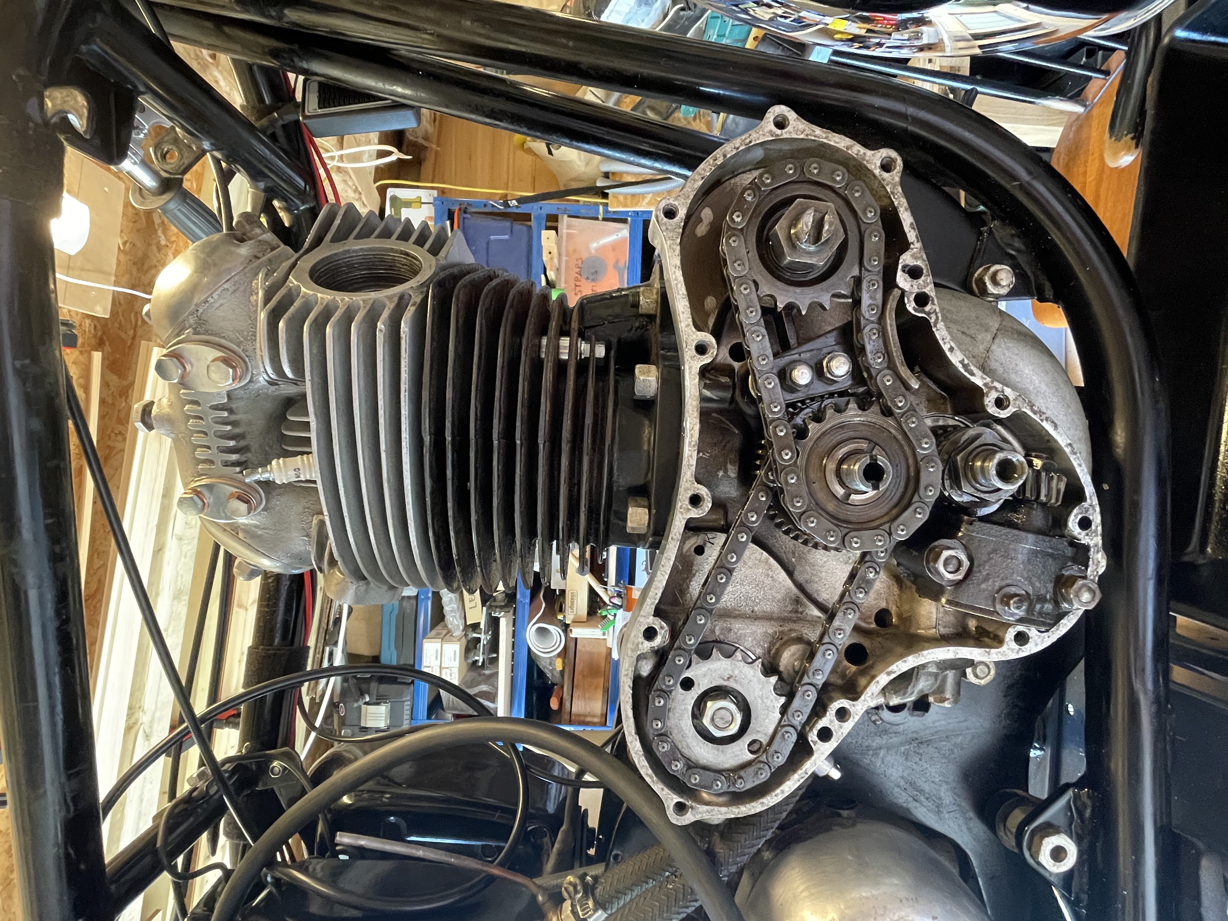

Kit, can you confirm that the valve timing is set with the crankshaft timing marks in the correct positions as I could not tell from the recent photo you have posted.
Hi Paul - so far as I know they are set with 10 links between the dots. Each of the dots are visible on the picture and are at 12 o clock on each sprocket. All looks good to me but this is my first Norton so assume I’m an idiot!
Is the central gear aligned correctly on the crank? The alignment marks are invisible behind the chain and need to be supplemented with paint.
Also...how did you establish top dead centre accurately? (Sorry if that's been asked.. this thread is getting very long...)
TDC was found using a TDC tool and marked at the start of the ‘plateau’ when the piston arrives at TDC. I haven’t checked the central gear alignment on the crank as this ‘appeared’ fine when checking the previous owners work. Starting to have suspicions but trying to keep an open mind
"Start of plateau' might be very misleading. The most accurate method is usually to fit a degree wheel and split the difference between when the piston touches the stop. On.the other hand..if it's too far advanced it should kick back of course. And too far retarded it ought to start but run sluggish and hot.
Do you live near a Branch group? A conversation with someone who's familiar with these things might be more help. My bet is the (hidden) timing marks on the crank and half time pinion aren't matched together.

This is wasted spark ie both cylinders fire at once ie at the same time. There is no distributor. The turning direction takes care of it self, turn the engine slowly, note which direction the rotating 'orange button' goes and make sure it is in FRONT of the Pick-Up coil! at the moment you want the engine to fire ie 32Deg BTDC.
