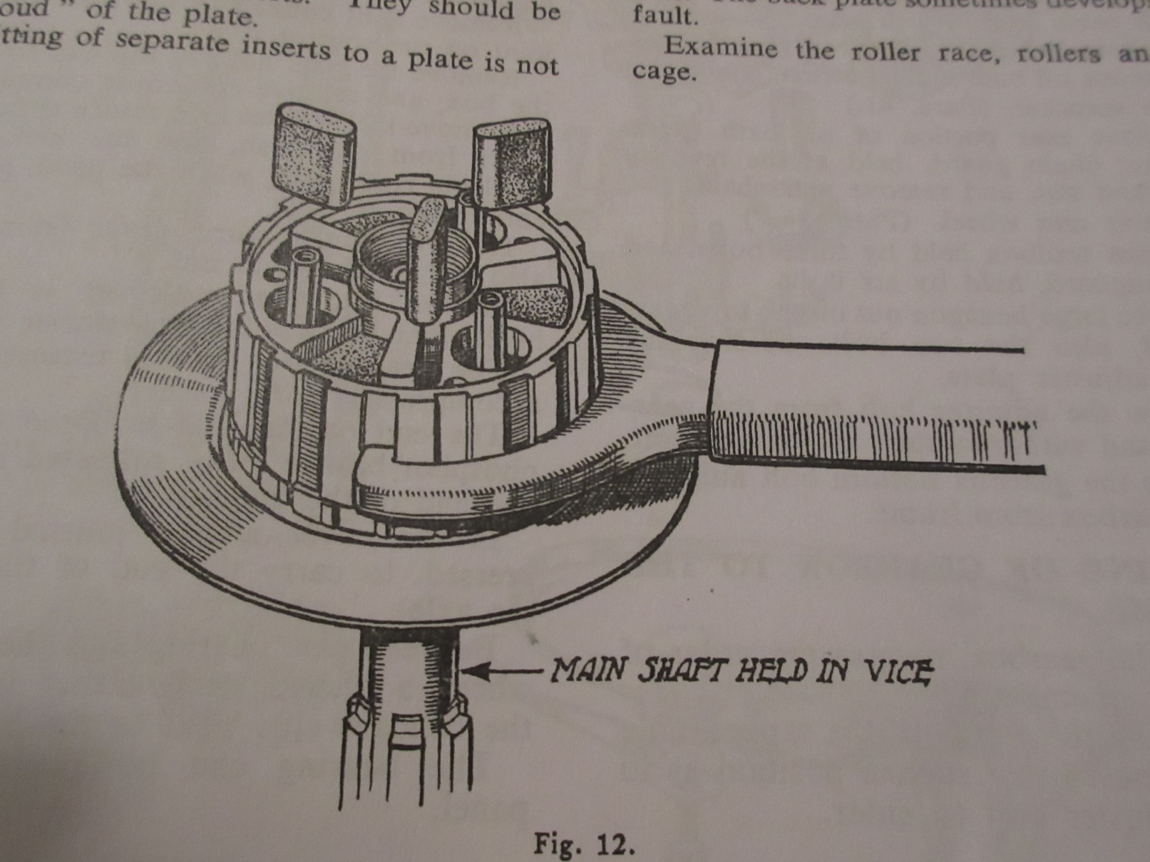

Iâm stuck....Iâve got half of rubbers into the clutch spider with makeshift tools. Managed to press three of them in with a lot of grunt, C clamps and dish soap as a lubricant. As each one was pressed in the ability to compress enough to get the remaining ones in diminishes.
I donât want to risk damage the spider
I canât find anybody locally who has the magic tool; the proper wrench and axle shaft tool for compressing them as pictured in the Norton shop manual.
Does anybody have any suggestions?
Iâm thinking of grinding the rubbers down on the belt sander to just a shade oversize. Then I am sure I can fit them if I do that but perhaps they are meant to be really jammed in there overly tight ?
Are they purposely way oversized or are they meant to be shaved down a bit for a more true fit ?

A spare main shaft to put…
A spare main shaft to put in the vice makes life easier, I didn't have one but made a tool from an old clutch plate and used an old fork stanchion for leverage. I wrapped an old chain around the gearbox sprocket on an old but complete gearbox and clamped it up in the vice so the gearbox wasn't clamped and did as suggested put the big ones in first. It is possible!

Hi,put in the 3 biggest first,then you have more rubber to compress. I have done this job and it is not easy at all.Good luck!
Svein.
thanks Svein
I took your advice and dismantled what I had done and started with the three big ones
2 1/2 beer and some down-east cuss words and I pressed the three little guys in with a c-clamp
So it is do-able without the axle and strap wrench.
I figure it is good for another 65 years ?
Thanks Svein...don't know how I would manage without the NOC
Grant
I know it is a bit late no…
I know it is a bit late now, but I fitted the big ones first then smeared rubber grease on the smaller rubbers and also inside the cavity where they were to go. I then was able to easily slide them in place using the end of a piece of broom handle by simple pushing down.Took only a few minutes.
