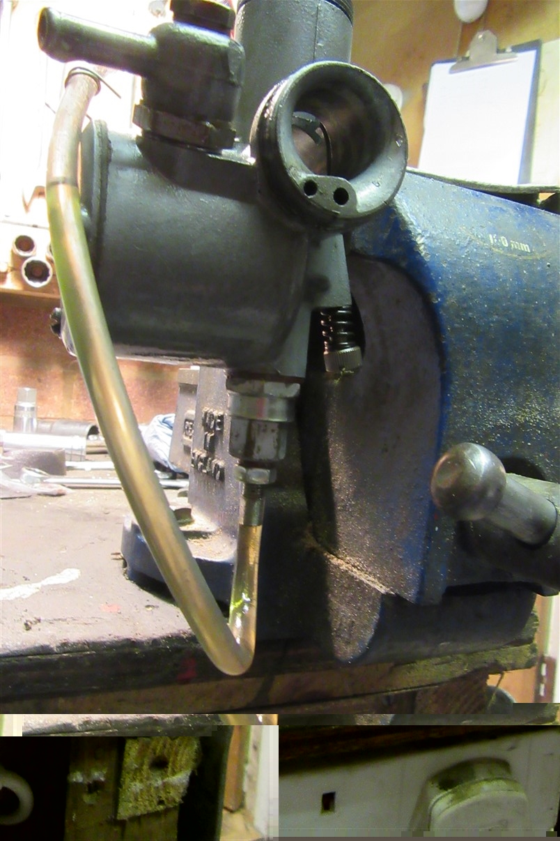

The only problem...
... with making a clear float chamber cover is that it may mask the original problem which could be related to the standard cover (eg the spacer as mentioned by others). It's easy enough to make a level indicator using some clear tube from the pilot jet (or by modifying a spare main jet cover like this).
