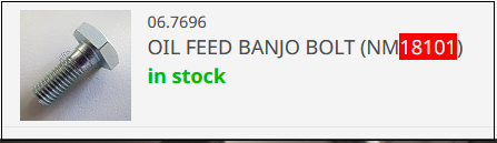

The bolt is the same size for Dommi & Commando. See below.
Plus, on the lightweights, the head steady fixing stud has the same thread where it screws into the head - a departure from the normal Whitworth thread used elsewhere on the bike, where a stud goes into aluminium.
Oil Feed Banjo Bolt
