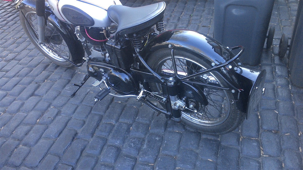

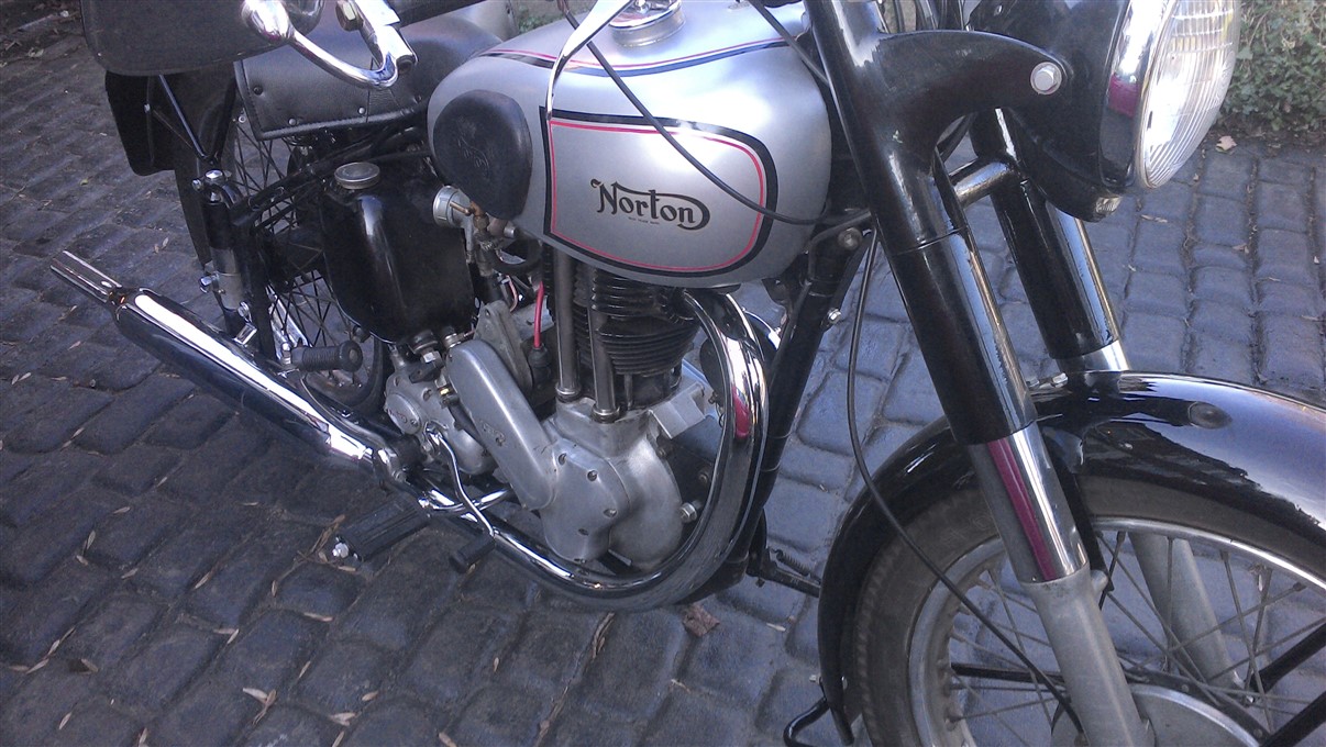

I attach a couple of photos - I'm sure I had a tail light when I set off! The dynamo is awaiting brushes from Tony Cooper hence is on the bench.
