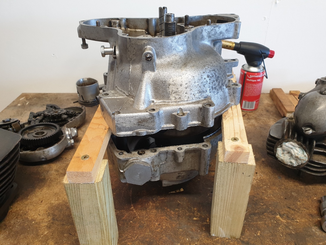

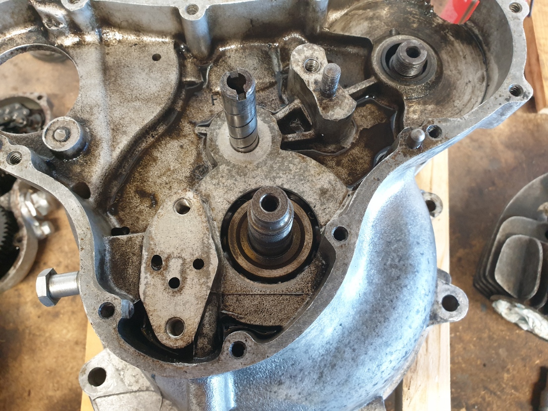

Hi,
Still struggling to remove the ball bearing from the timing side crankcase half on my 1957 Dommie 88. I have made up a stand so that the crankcase is supported with the drive end of the crankshaft just above the bench; heated up the timing side crankcase to "spit-sizzle" hot; hit the end of the crank with a rubber mallet (no good); hit the end of the crank with a lump hammer against a block of wood on the crank end. No good.

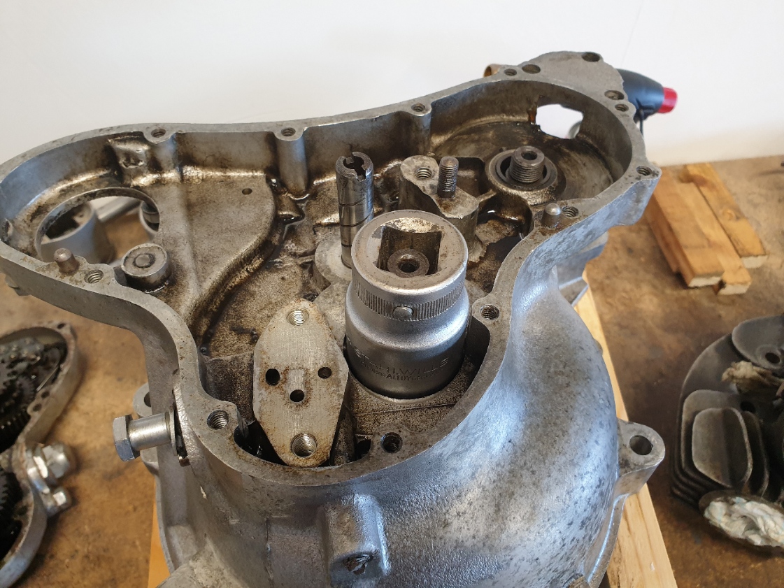

So - wondering if tapping down directly on the bearing with via a 1/1/4" 3/4" drive socket (which just fits over the crankshaft and just fits inside the crankcase housing) might be the next step?
Before I do I just wanted to check....that the bearing is an interference fit on both the crankshaft and in the housing and that there is nothing else holding the bearing into the housing, or onto the crankshaft??

Hi Aston , one simple thought having looked at your set up in photo2 . I think a lot of force is being dissipated by the wood in the support flexing and taking the woomph out of the thump . Maybe needs to be metal with some thin cardboard protecting the faces . Hope this simple idea is helpful, Best of luck

The books say "do not drill the case flange and drift it out from behind". But perhaps needs must? Has it been staked or glued in place to prevent spinning?
