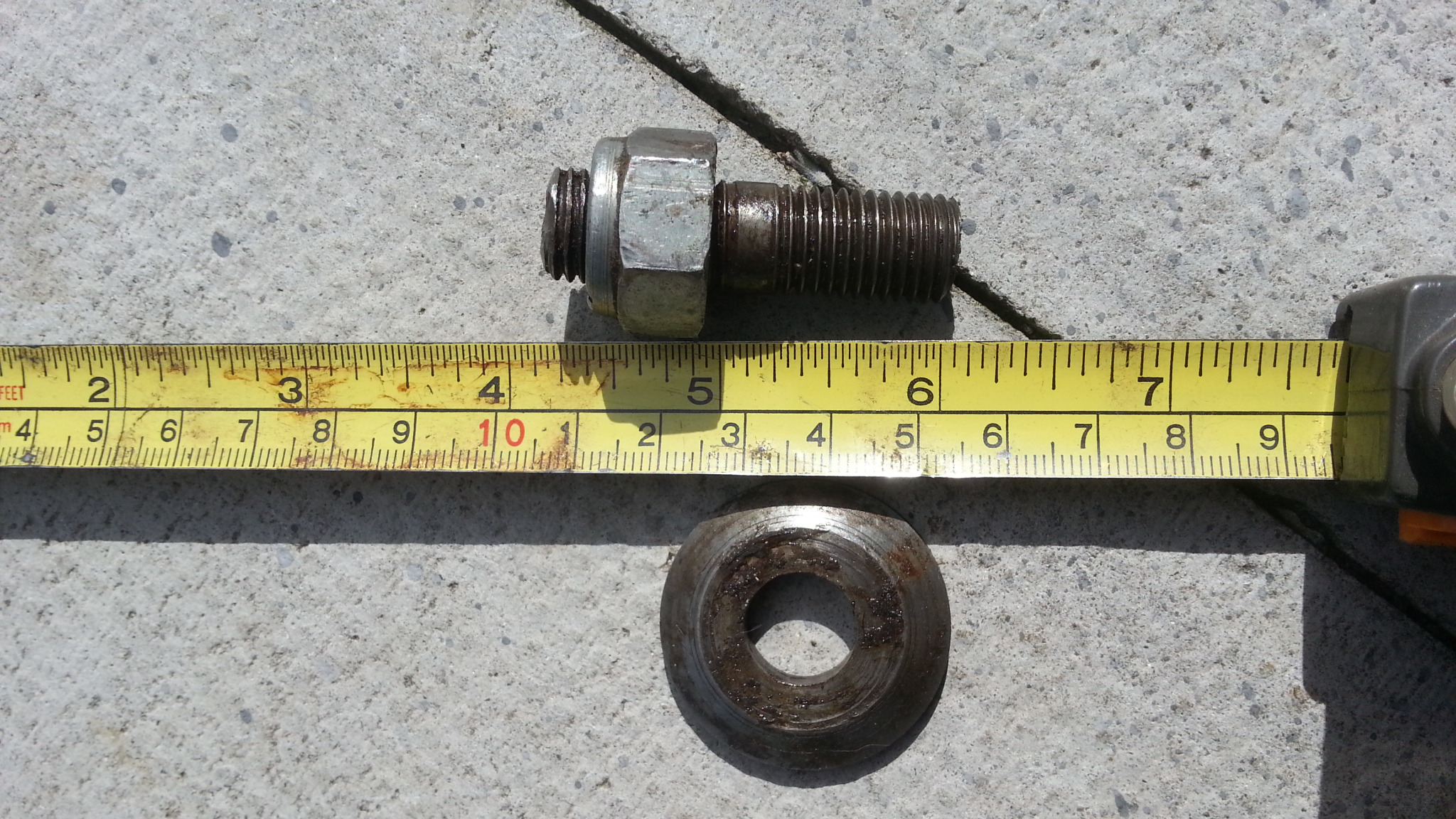

As stated above - yes, you can replace the Electra Chaincase (inner & outer) & starter motor, with just the Navi/Jubilee cases - BUT they MUST be from an engine on or after # 106838. Also, you remove the starter gear from the end of the crank and replace it with a chunky washer (from a Jubilee or Navigator) that will keep the rotor in place. Photo attached below shows the washer & stud used on Jub/Navi. Your Electra's bolt should suffice - but you will need the washer.
