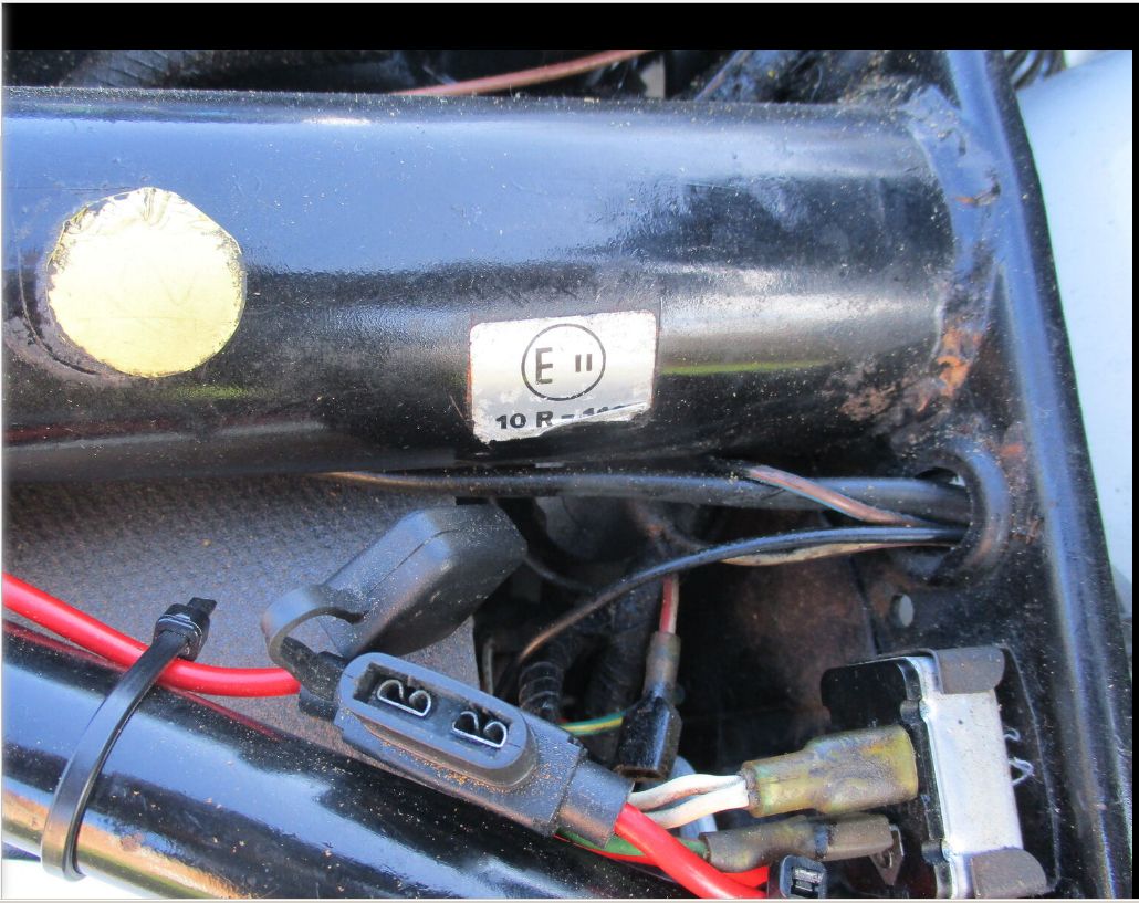

I am looking to buy a MK2A(plastic air box, bean cans), Interpol ,it does not have a data plate under the seat, and the seller said it is not on the headstock because of the fairing mount.
There appears to be no frame…

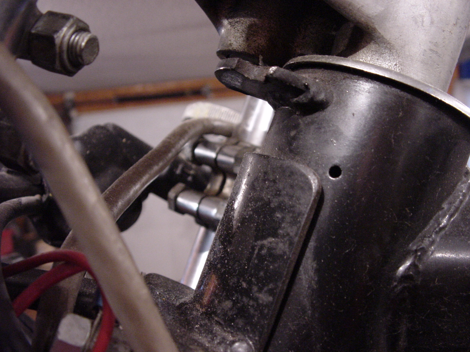

There appears to be no frame holes under the seat, here is are photos of that area.I am unable to investigate the Interpol directly so I do not know about its headstock. BTW my JPN has the data plate under the seat but still has holes on the headstock. Here is a photo of that area.

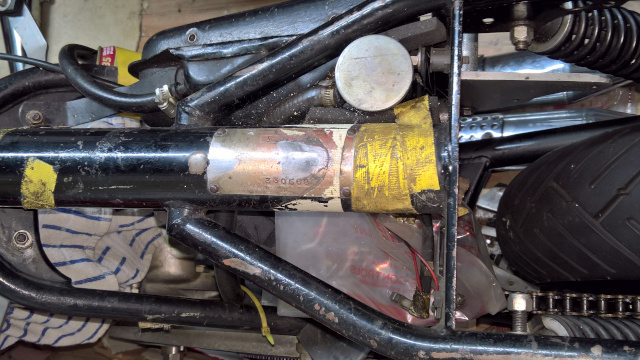

My frame also has the VIN plate fixing holes in the usual place on the headstock. It is likely that the holes in the headstock were put there by the frame manufacturer. The under seat plate will have been put there during assembly at the Norton factory and, as you see, is not square to the frame tube - so someone with a black&decker.
As for why yours doesn't have a plate: some Commandos didn't and the V5 shows the frame number stamped into the RHS of the headstock; or yours is a replacement frame, a lot can happen in 50 years.

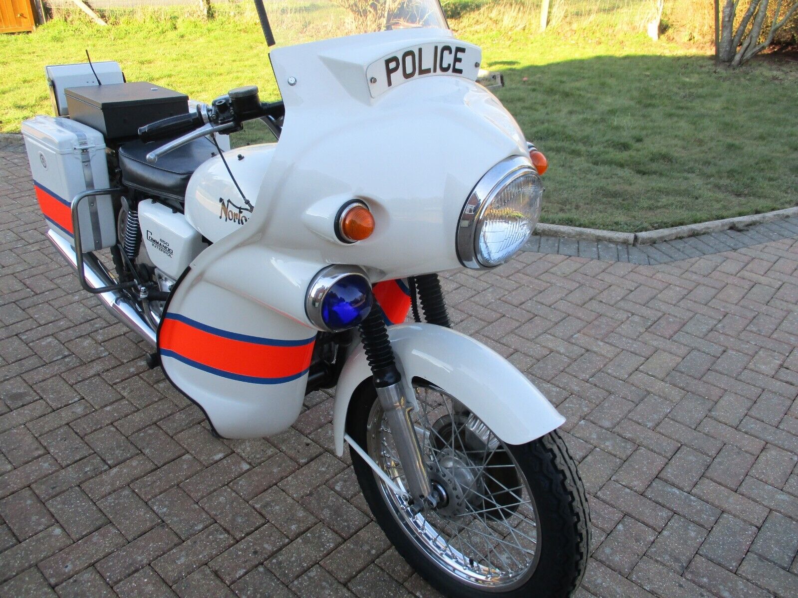

Thanks for the info, I am trying export the Interpol into the states. But the costs are considerable. They are rare here. Does anyone know Malcolm Ward running Elm Villa Classics? He is the seller. I would love to be able to get it but the numbers are not looking good. If someone nearby could look it over that would help .
Not familiar with that…
Not familiar with that fairing, although that doesn't mean it's not right. Mine (1974 Mk2A) looked like this: https://classic-motorbikes.net/wp-content/uploads/2015/10/10559.jpg (with brake caliper on front left).

My 74 Mk11a Interpol has the front brake caliper on the drive side. I guess a reputation for police bikes being worn out is dated now? The crank on mine was interesting as it had no rotor keyway (one was impossibly situated in the thread on the end of the crankshaft?!) but the flywheel had been drilled, the odd cylinder stud hellicoiled and that brake disk drilled and skimmed, so properly engineered maintenance. I suspect it's 55k miles is about right and I have replaced bearings and seals etc etc as it's 50 years old, so rarity is now an asset in my opinion. Incidentally does anyone know the thread for the petrol tank radio fixings?
