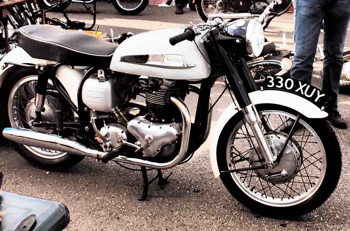

Hi, firstly thanks for all the advice the others day, this is a great site! Everyones tips we're so helpful.
Sorry just have 2 questions.
1. The Norton i have attached has a silver tank, was wondering what colour i should request to match it,
there was some conversations the other day but i got lost of which was my tank & which colour would be
right. My guards will stay white like the attached pic, was wondering what code i should get for the Silver &
then what colour is the black?
2. Also was wondering whats the best place to go to get a speedo repaired? Mine is too old & not working.
Thanks so much...

Hey Marcus, if your bike really looks as good, as in the photo', just ride it, it looks great! Too many people "nit pick" over minor details. Customising is a matter of personal taste. I've heard people "knock" a bike for having the "wrong" handlebars. I preferred Vincent bars back in the 50's, and, anyone who could afford them fitted alloy rims. There is no vehicle, yet made, that cannot be improved to suit the owner's taste.

Thanks everyone once again, big help. The only problem with my bike colour John is it's done up like an old police bike (all white) which it used to beso doesn't look that cool. I really liked the colour scheme in the photo i attached though i'll try work out & match the colour which the suggestions everyone has made, just need to see it in person colour wise. The speedo links are great, i had seen one where the guy had all old parts, the links people supplied "speedorepairs" seems to have access to older parts is that correct, hard to know being in sunny Singapore whom would be best to keep my speedo original as much as possible.Thanks again!!Attachments
