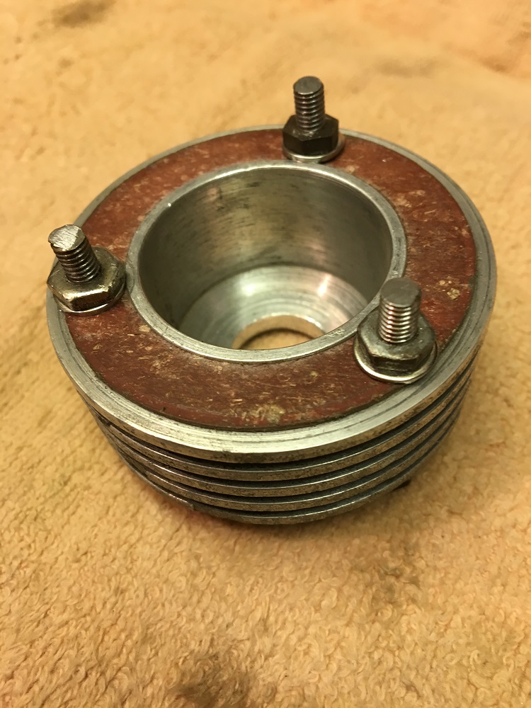

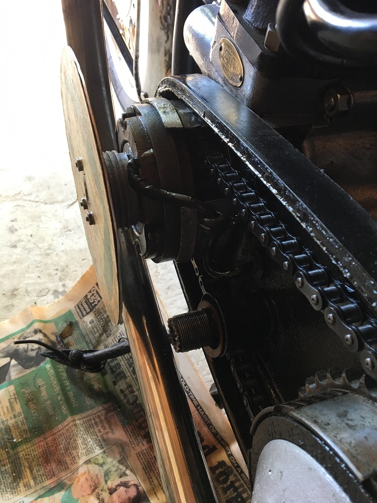

I had a similar problem with my 650SS which will be the subject of an article in a forthcoming issue of Roadholder. My solution, though it won't help you if you don't happen to have one, was to use a surplus, after market carburettor float bowl extension, drill out the middle of the bowl to attach to the crank and then affix my timing disc using the original three mounting holes. As per the attached.
